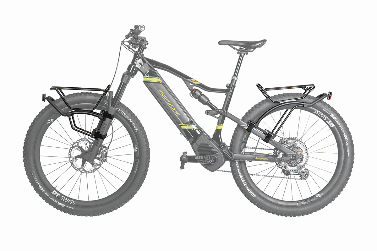

A Very cool front and rear rack design... thanks for sharing. ;)

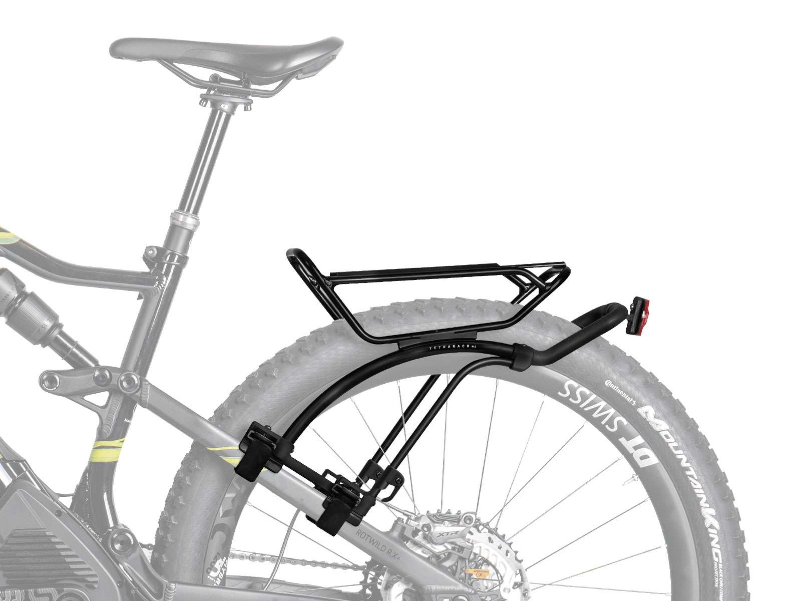

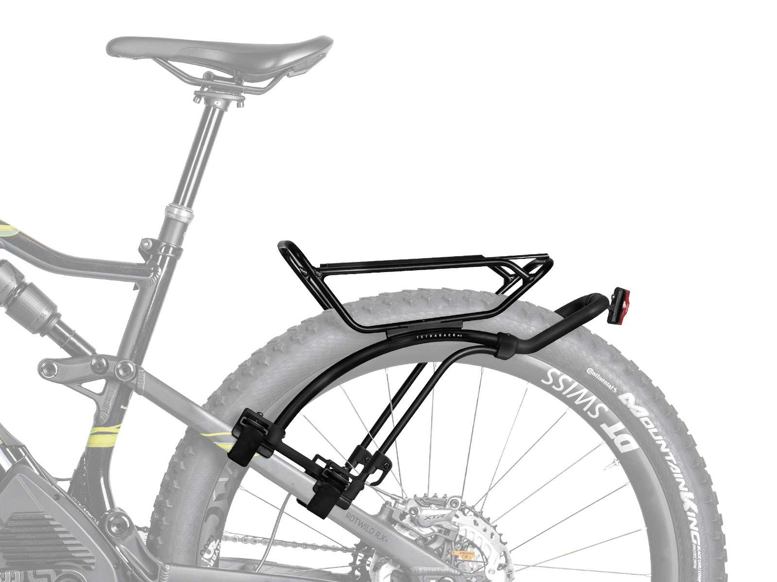

I found the product available online from HiBike in Germany:
https://www.hibike.com/topeak-tetra-rack-rack-p87e53a693c05a1ec1d282820e5a47d1f#var_84500680
I have a haibike full fat 6. I custom build a rear rack that moves with the suspension. The pivots are hollow, so it’s possible to use the suspension pivots as mounting points. This is a Baltic birch prototype, next is a water jet cut aluminum kit, with a fold back extension for bike touring.
Thanks for this. Apparently new and not yet available to purchase, but will stay firmly in my radar screen when it's released. View attachment 44362
