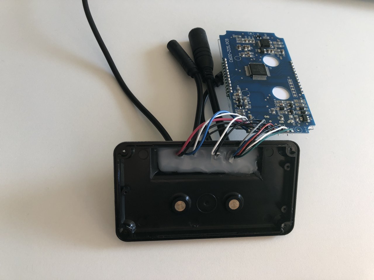

My NCM Venice + 48V e-bike with Das-Kit C7 display and probably Lishui controller.
On the back of the display is
C600-1705-
B640 V2.7-EN
. After entering the code (8018), the display only allows you to change three support levels (Eco Normal Power) and to select the voltage 36 or 48V. Lockdown speed and wheel diameter are not accessible.
There are very poorly available € 119 tuning displays in which the last two things can also be changed.
So I cut the cable open and found out the function of the cable and the pin assignment using an oscilloscope and logic analyzer
(yellow is thumb gas with the usual about 1 to 4 volts)
Messages with
9600 baud at 3.3Volt TTL levels are exchanged on the data lines so that I could examine the protocol via USB TTL adapter.
At approx. 10 Hz, 12 bytes come from the display to the controller, which responds with 10 bytes.
Without a message from the display, nothing is sent from the controller. If you put the switch-on signal on the supply voltage, the controller uses the last setting and also works without a display.
For better testing, I soldered a pin header into the cable so that I can easily interrupt individual signals:
But now the exciting results:

Next I grabbed a microcontroller (Teensy) and changed the messages coming from the display to the controller so that when I selected level two, I sent it to controller 6 at 36km / h maximum speed .
With 3D printed housing:
Depending on the battery voltage, the controller regulates at 29 to 32 km / h.

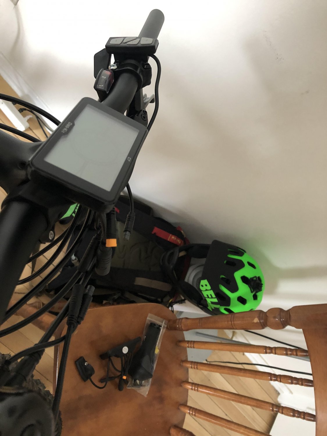

This got me looking at Magnumbikes website.
Low and behold they run the same Das-Kit C7/i5 controller system (data protocol) as my NCM bike but can reach 28MPH!

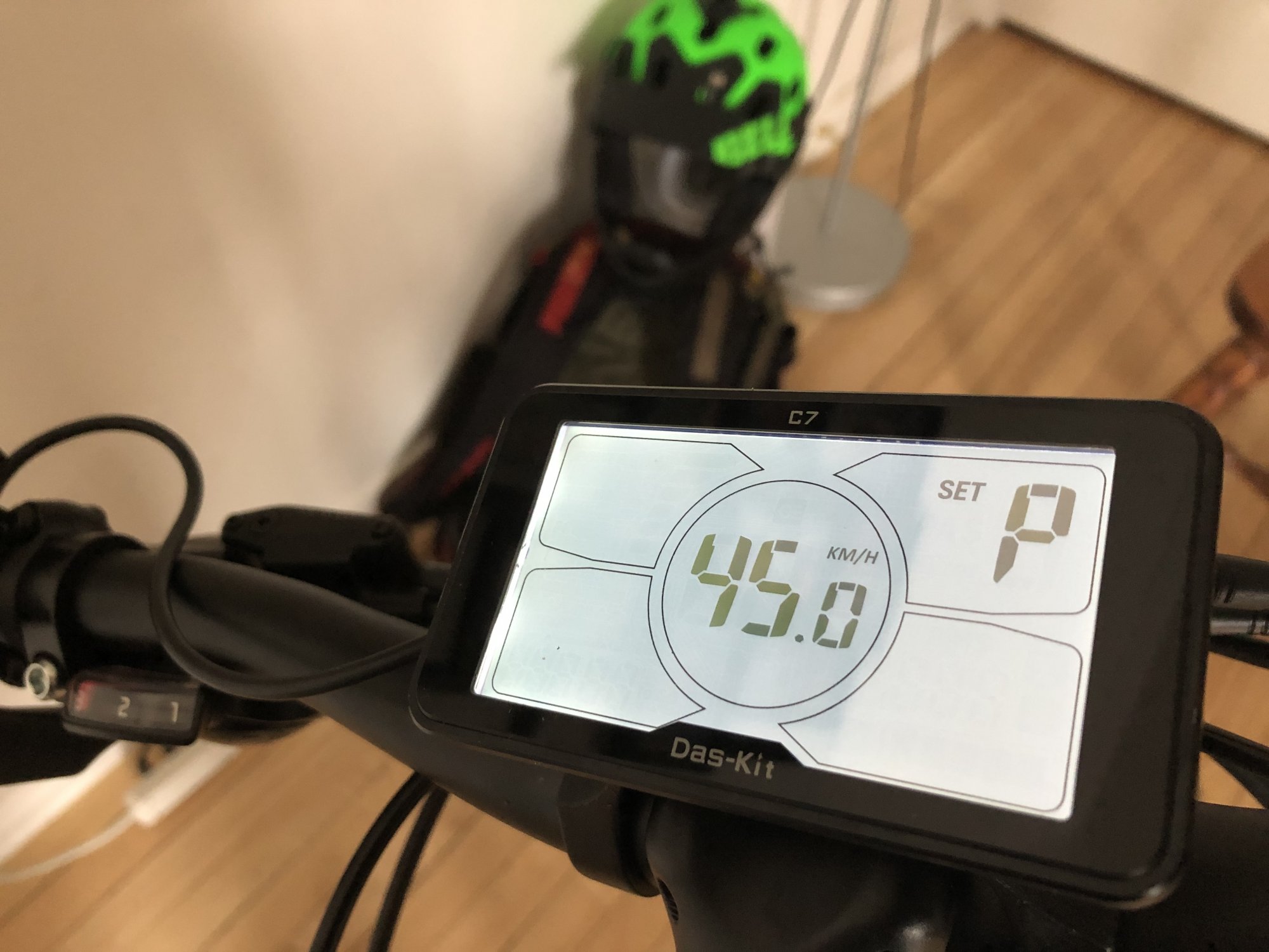

This brought me to youtube looking up display tuning videos for Das-Kit C7 displays. MagnumBikes has a video posted there.
I watched it and saw the tuning screens (Pedal Assist/Throttle) that my NCM doesn't have in its settings menu. After watching, I starting thinking that maybe the speed restriction data is stored in the Das-Kit i5 Controller firmware. I would be SOL unless I changed the Controller and the Display. But then I saw this image attached on that same german pedelec thread.
Once I saw those chips, I knew there was firmware in the displays restricting the speed tuning options. I ordered a Magnumbikes C7 - 5 wire display.
Got it today, removed my stock NCM display and installed Magnums. Guess what? I can now go 25mph on assist and 23mph on throttle. :cool:
Here's a YT video of the new Display and the tuning options it gives my NCM Moscow Plus.
Hope this helps some of you out there wanting to go faster or tune the bike to go slower.

Interesting. I swapped the Magnum display and controller both onto NCM Aspen+, and it didn't make any difference at all. Did this 4 months ago.
I'm going to test the correct speed with a gps app on my phone tomorrow sometime. Also planning to see if changing tire size will affect anything.
I stock multiple of their displays as I am a Magnum dealer. Also an NCM dealer.
I can tell you there is a difference in the ride when you have the other on. Maybe not 28mph fast, but faster than a stock NCM display.
The biggest difference is when you have a full battery. With the G660 Display installed its like the bike is on steroids. Acceleration is faster and doesn't lag as much. I was testing on the strip of road out front of my house today. Full battery starts for both tests.
The NCM E694 Display topped out at 37.5 kmh on a full battery. 32km throttle.
The Magnumbikes G660 Display topped out at 43.1 kmh on a full battery. 37km throttle.
There is a noticeable difference in the torque depending on what display unit you have on. I find that the power band is better with the Magnumbikes G660 display on. I get from 0-32Km/h faster than the E694.
As the battery voltage drops, the top speed available on the G660 comes down quite a bit and soon matches up with the NCM E694's top speed (32kmh). I find the power on the motor to be more responsive with the G660 than the E694 as the battery dies out.

After reading all of this and checking out the code on github. I had a good understanding what needs to be done to go that route and hack the display.
It wasn't something that I was interested at all to attempt to achieve. Also those german riders had 250W motor kits installed and were only trying to go as fast as my bike already could stock. (Due to speed restrictions in Europe)
So now what?
Something from vspadrva's post stuck with me.
So with the old C7 what speeds did you do?
