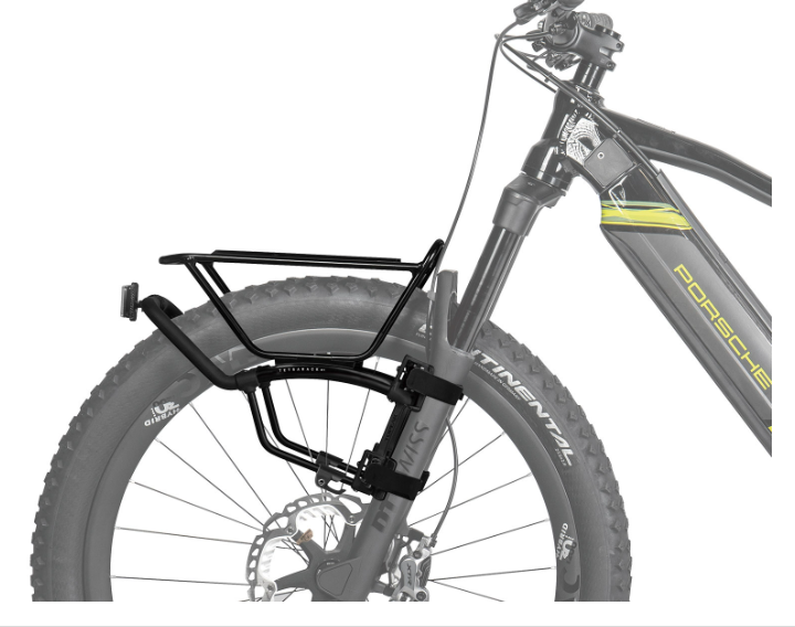

If you have front suspension on your bike, you could add a front rack and set the suspension for a soft ride.
Surely the rack in the photo is not subject to shock absorption (apart from the tyres)? The rack would need to be attached to the other side of the suspension unit, for example the frame or handlebars.
Not sure I follow.
A rigid rack on the bottom part of the fork will have zero damping. It will suffer every bump in the road like a rear rack.

Not sure I follow.
To a degree, you are correct. Cargo doesn't take the same hard impact that a rigid mount rack, on a bike without suspension. I used something similar several years ago for commuting. Cargo gets shaken, but no hard impacts. Same is true with a handlebar mounted basket on a suspended fork.

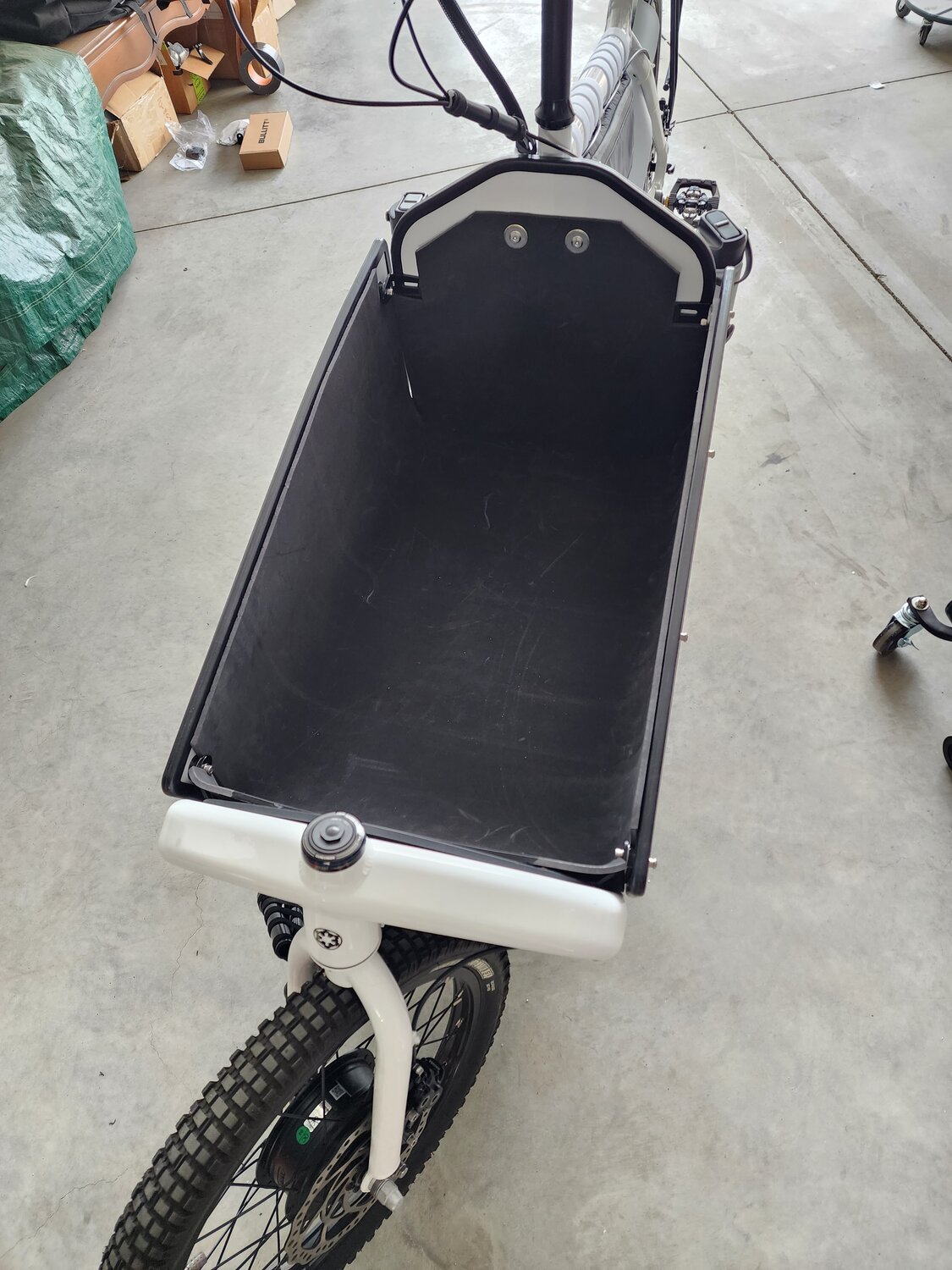

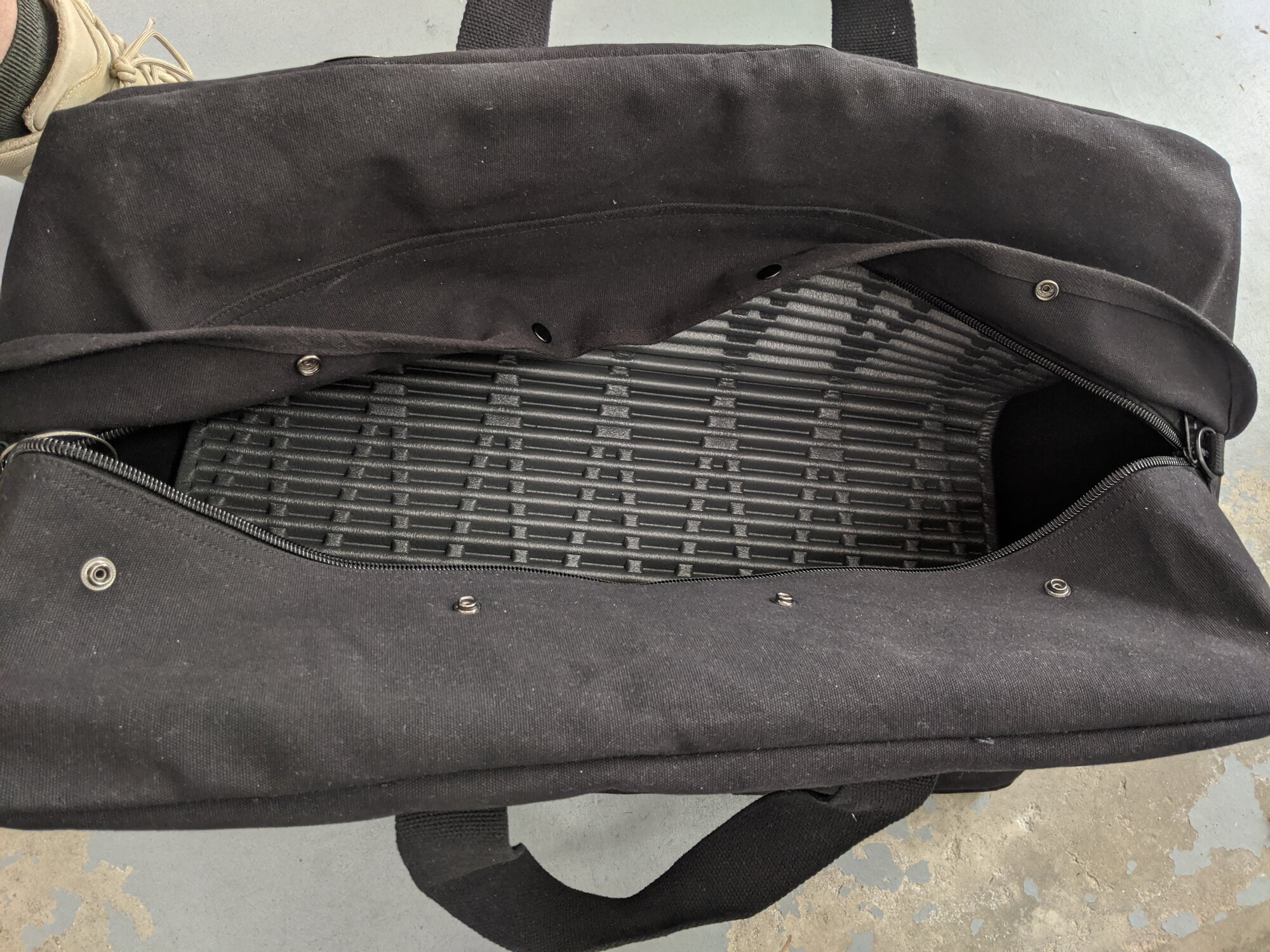

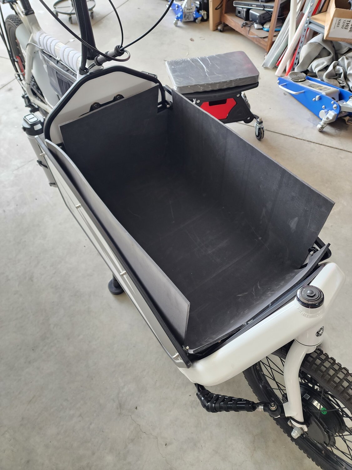

I can tell you what I do to deal with this. First of all, Mr. Coffee is pointing you to what I would consider to be the proper solution, although you may choke on the price.

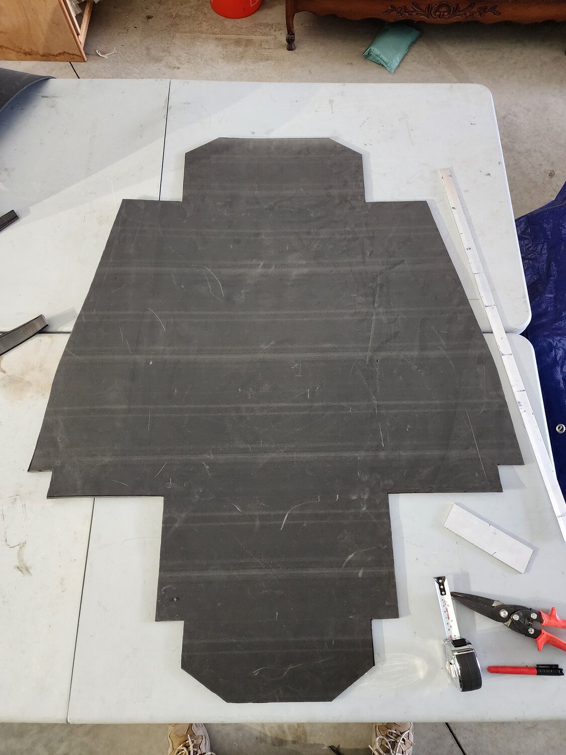

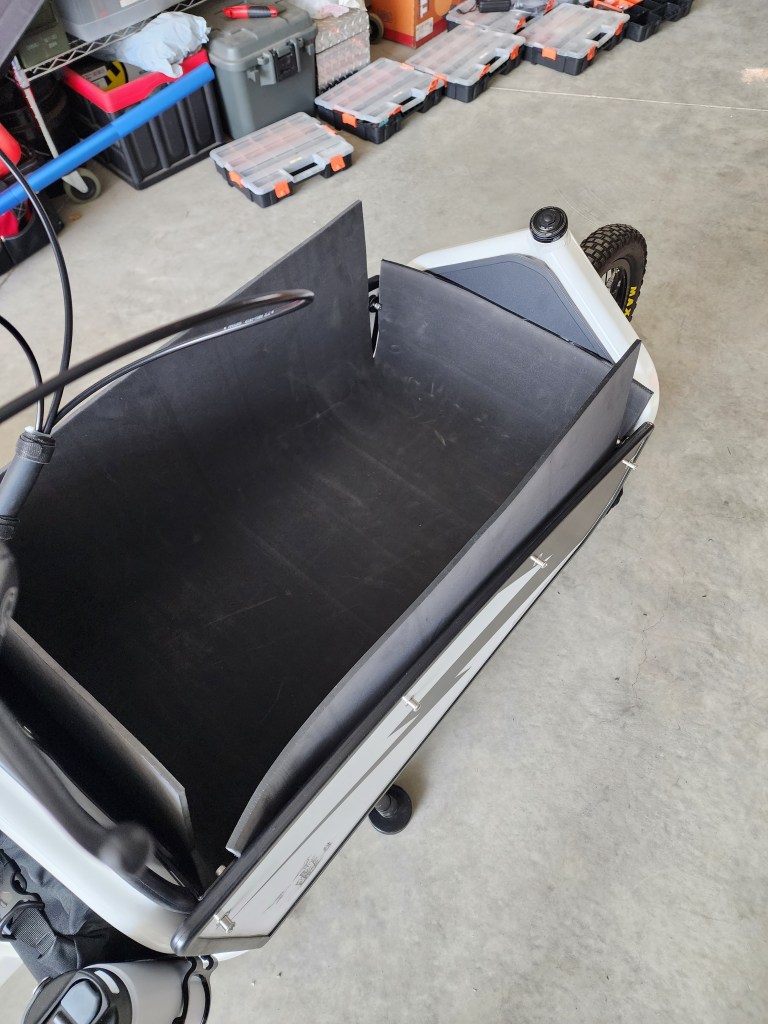

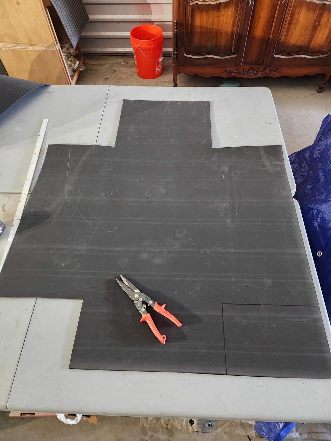

Order some of this and cut it into appropriate shapes:
I use the Minicel T600 foam from this site (scroll down that page and its near the bottom). You want the really thick, heavy duty stuff that is thinner than most closed-cell padding, so you can double it up. The 600 type is also durable enough to last for years without damage to itself.
Ideally you want the 1/2" stuff. But if the price hurts too much, buy the 1/4" sheet and use 2 layers.

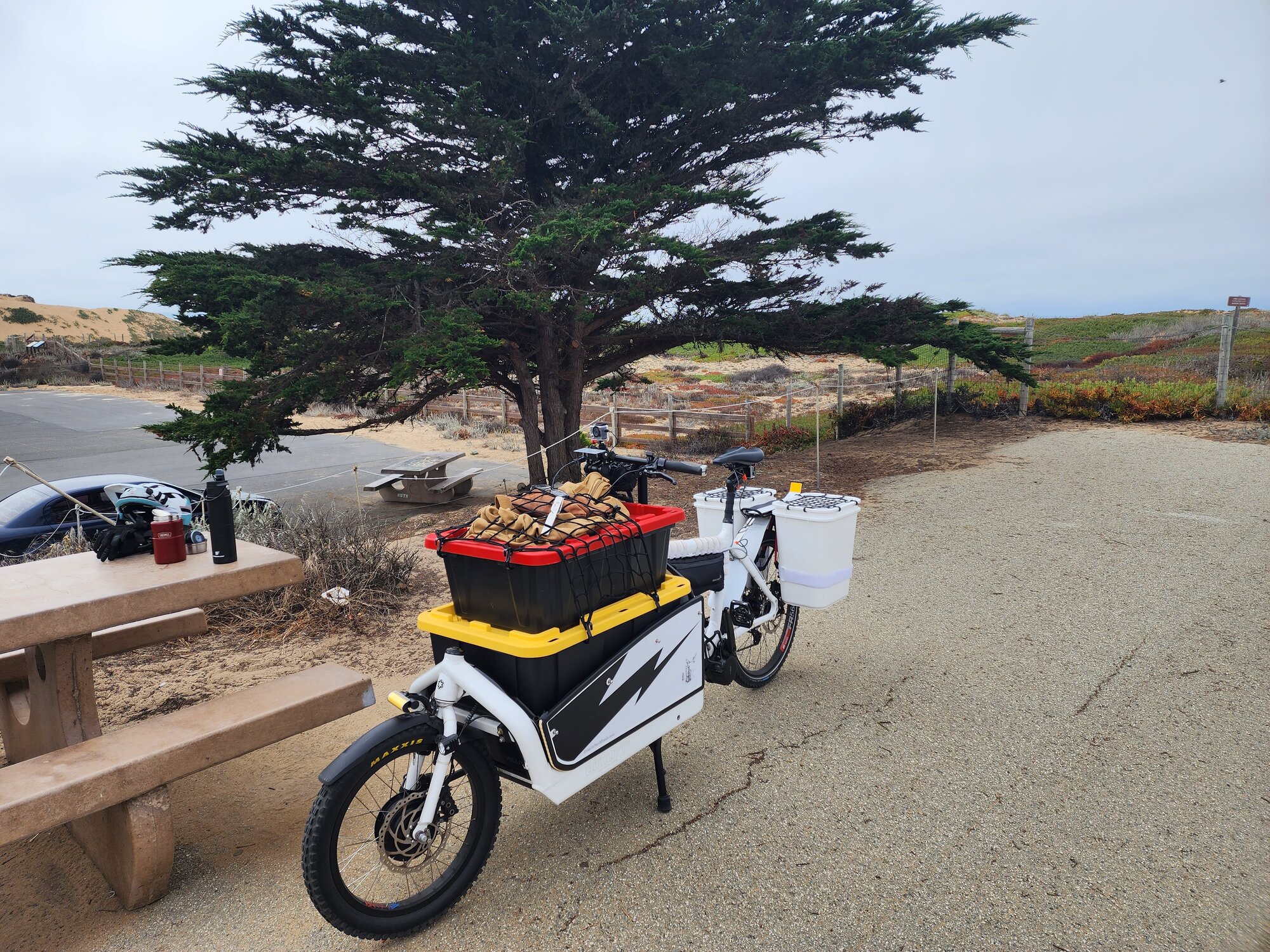

If you want to try a cheaper solution, a Therma Rest camp mattress is about US$20 and you can cut it up and duct tape it into a shape to match your rack dimensions. I did that as a pannier liner on my longtails. This bag is, by the way, a Rothco parachute bag. and you see a brown one netted down on the top of my cargo box below. This black one I grommeted and used as a 68L pannier.
After that, Get yourself a drawstring laundry bag. Something sized to the container or just a little smaller. OR it can be bigger and just knot the excess so your load is kept inside and the individual items will no longer be able to freely bounce around.
I use the laundry bags in the back hardshell panniers (which are made from office wastebaskets) and cost a small fraction of what a pair of smaller Fjallraven hardshell panniers cost).
Lastly, get yourself a net of some kind to net down the top of the basket. You can see the nets I use on my panniers, but bungee corded ones work great, too. My pannier nets are just covers but on a wire rack you can use them to net stuff DOWN to hold them onto the floor. I did that with my handlebar rack and rear racks on both of my longtails. Also in the pic above you can see the net holding down a canvas bag on the top of my front box. That bag can be filled with stuff and the net locks it all down.
And after all of that, maybe forget about your little box and go big. One of two paths:
