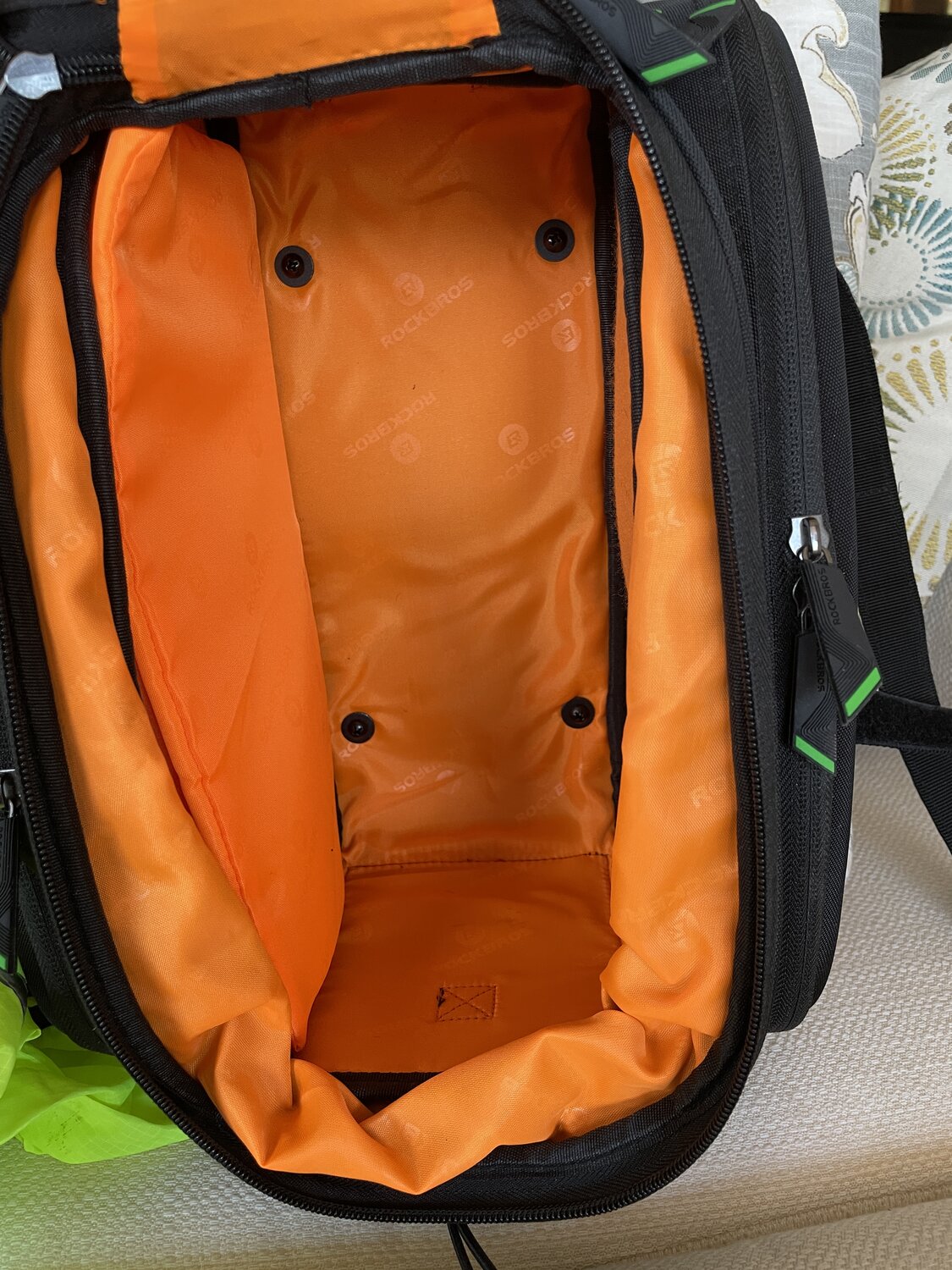

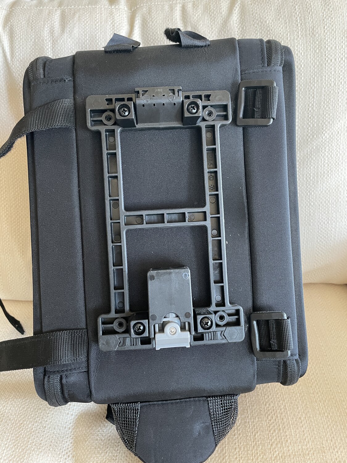

Hi riding4fun,
this is what we ended up with:
the bag is a Rock Bros bag. Additionally I purchased a Basil MIK adapter plate and attached it to the bottom of the bag. My wife and I love the bags and the adapter makes it very easy to securely attach it to the Allant +7. I purchased both from Amazon. We are heading out soon for a 5 day trip on the GAP trail and plan to fully utilize the bag. Good luck to you

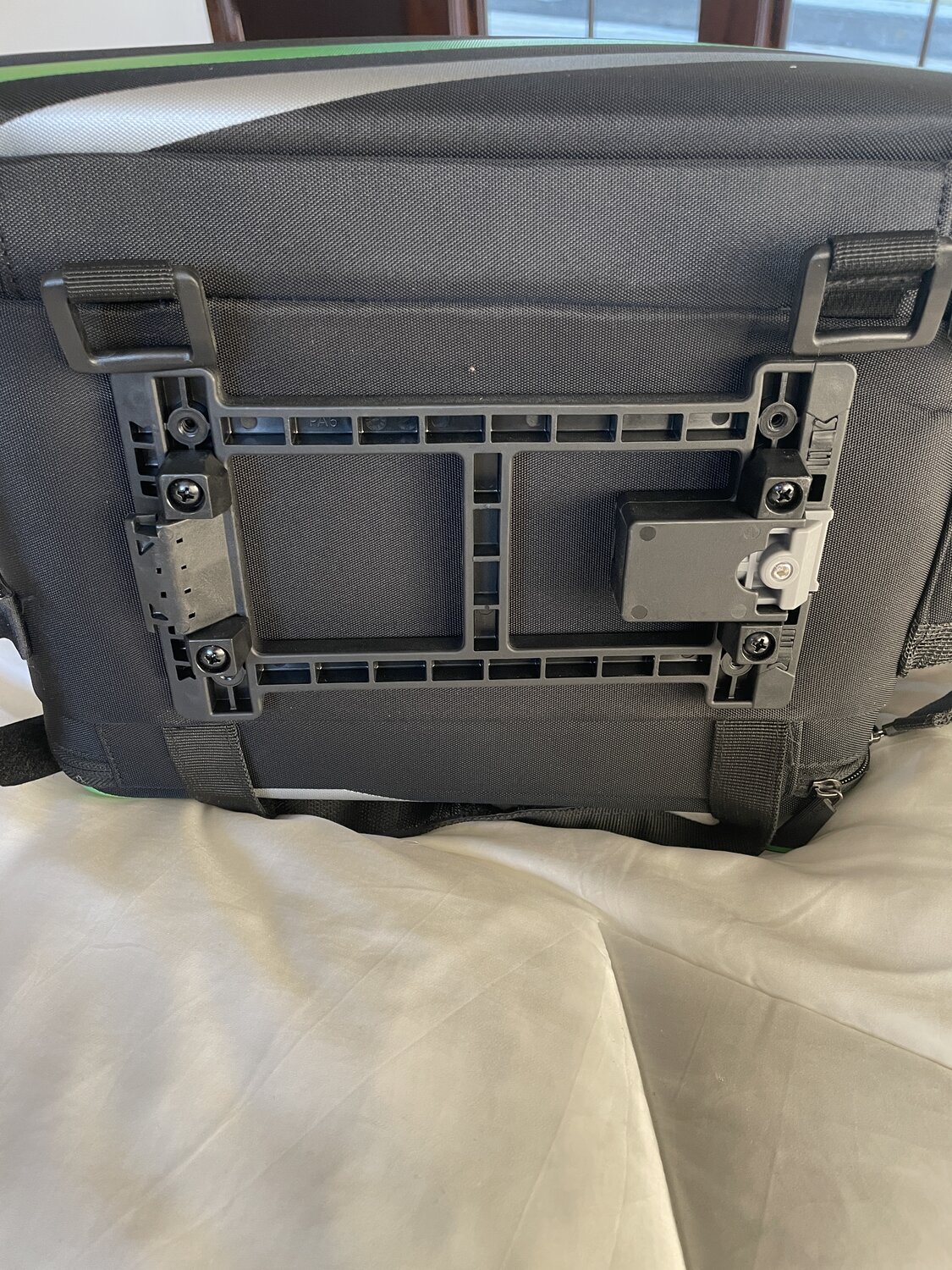

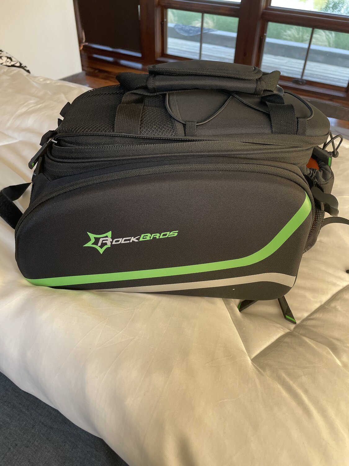

Hi! I just purchased the same RockBros bag and MIK adapter plate, but now I’m afraid to put the adapter hardware through the bottom of my bag for fear of ruining it. Any advice you can give for an easy, flawless installation? Did you add any support inside underneath the pad for the adapter hardware? This fear is tempting me to spend too much $ on a bag I don’t want that already has the adapter plate installed, but I’m resisting for now while I research options.

Hi Tabogas,
Congrats on the new bikes. My wife and I love them. We recently did a 5 day trip on the GAP trail. In addition to being a great trail, the RockBros bags with the panniers, were ideal.
it really was easy to attach the adapter to the bottom of the bag. I have included a couple of pics to show what the final set-up looks like. First, I used stiff cardboard as a template for the adapter. I marked on the cardboard where the 4 holes on the adapter are located. Placing the cardboard on the exterior bottom of the bag, I used a small nail to imprint where the screws would be located. Then using a small bit, I drilled the 4 holes from the outside in. When you do this, make sure you keep the fabric on the inside on the bag tight, otherwise the fabric may wrap around the bit. Then I used the screws with the washers and attached the adapter.
The set up is great. It attaches and detaches very quickly. It gets 5 stars from me.
Hopefully this is clear. Good luck and let me know if you have any questions.

Thanks so much! :)
