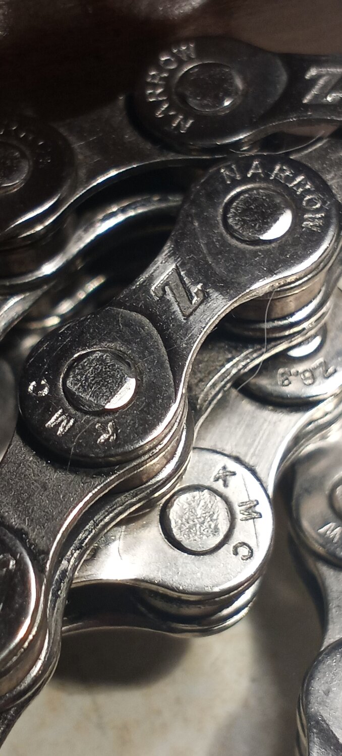

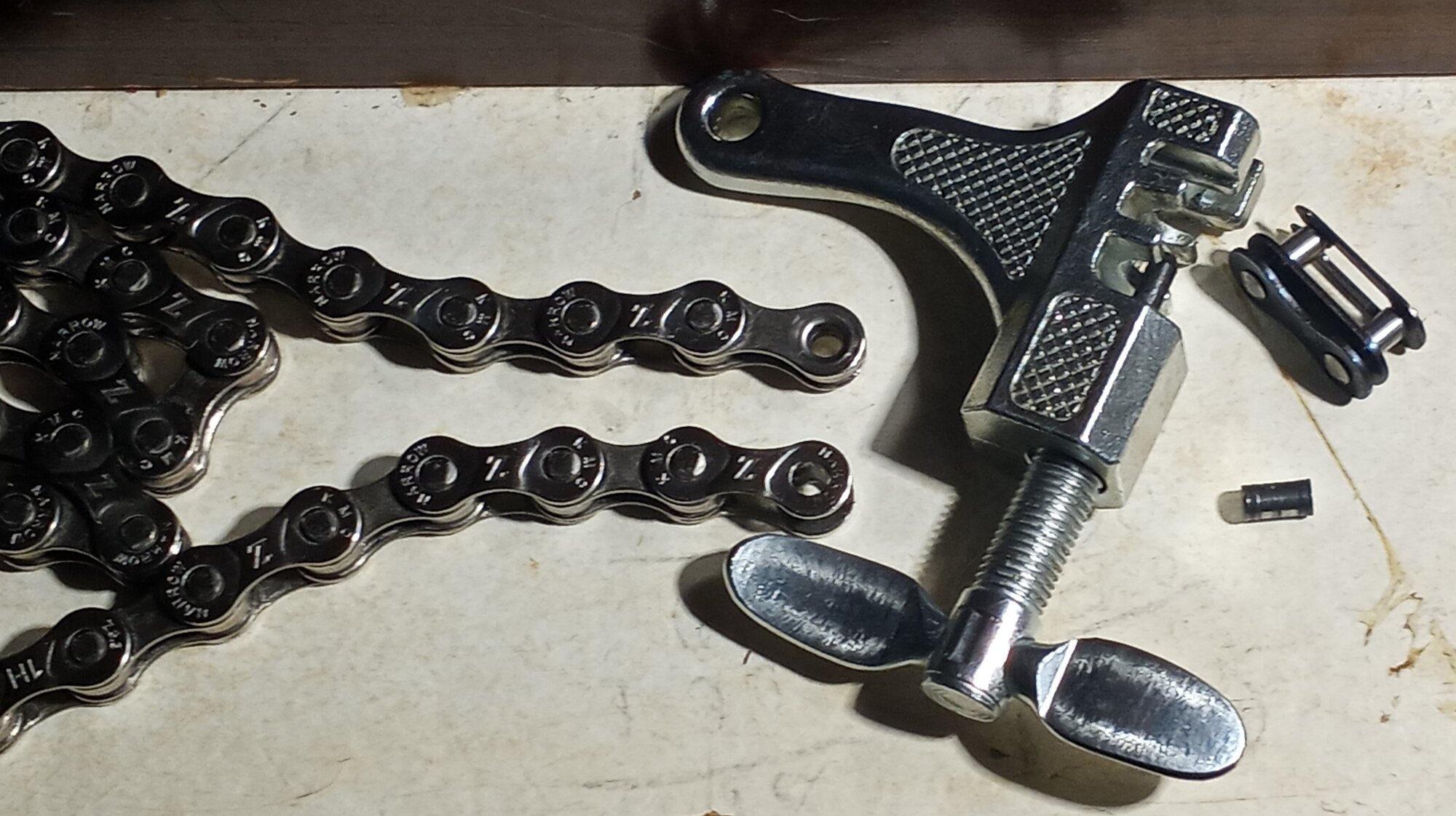

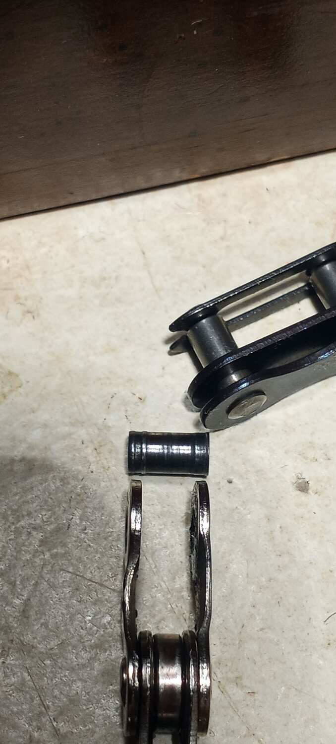

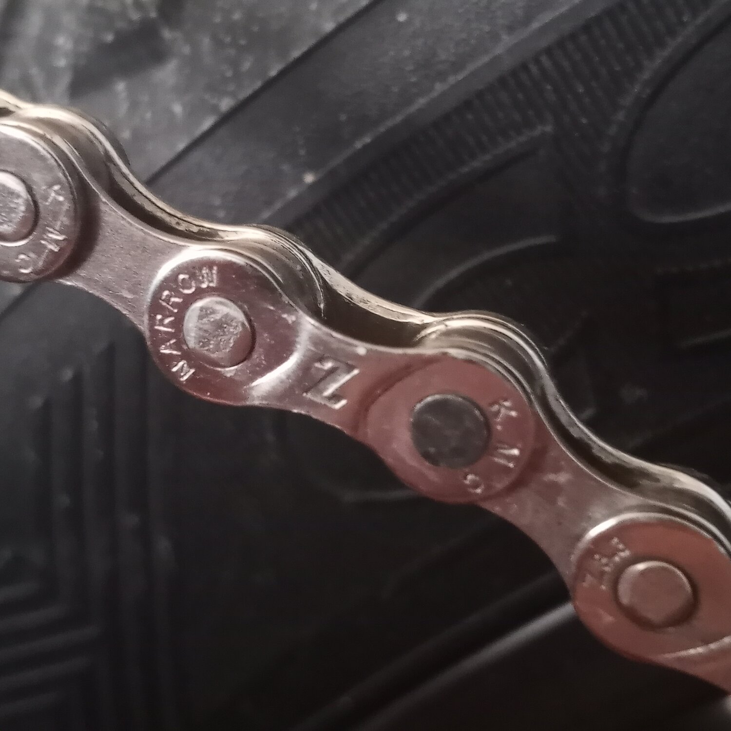

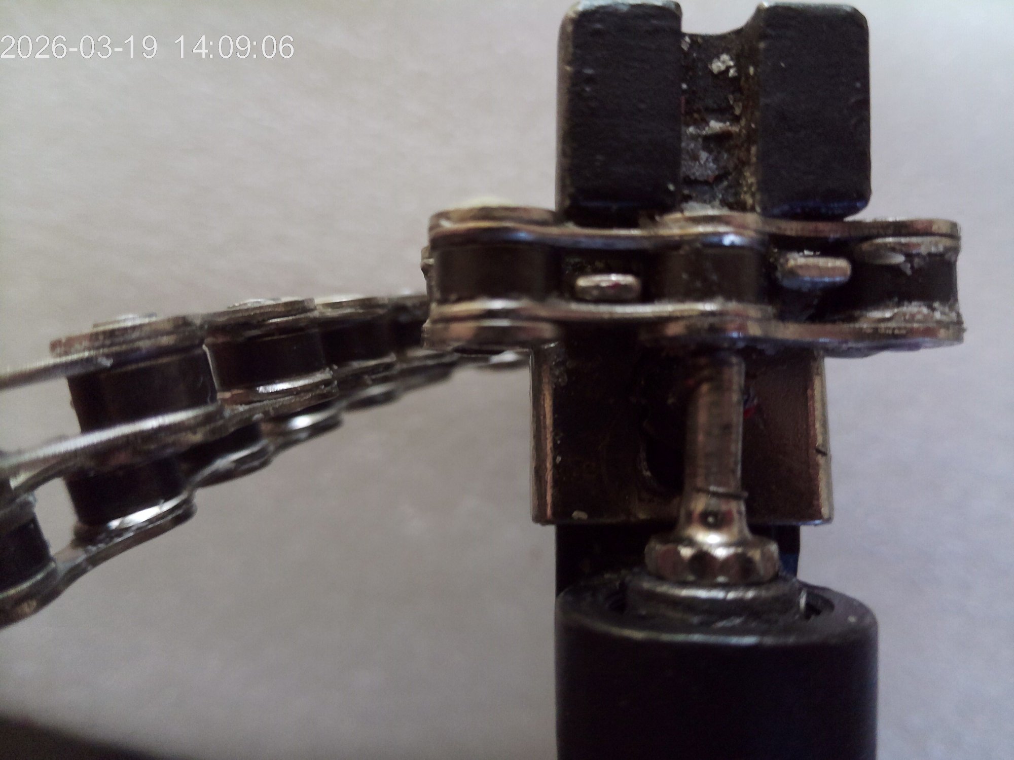

My first ebike came with KMC Z series chain with a master pin instead of a QuickLink,..
I didn't know that there was such a thing, or that it was a directional pin?
I almost broke my chain breaker trying to push it out the wrong way.
It's Fricken Amazing how that little lip on the Fat end of the pin can bind So Hard against the plate that it damn near broke my full size chain breaker !!??
I did manage to force the pin through one plate but couldn't get it all the way out.
After it occurred to me that the pin could be directional, I flipped the chain breaker around and the the pin pushed out Stupid Easy. 😁
But the Stupid part was that the chain breaker handle wasn't facing towards me when the chain breaker was installed correctly.
(I think that was done on purpose to make the chain installation process proprietary? 😁)

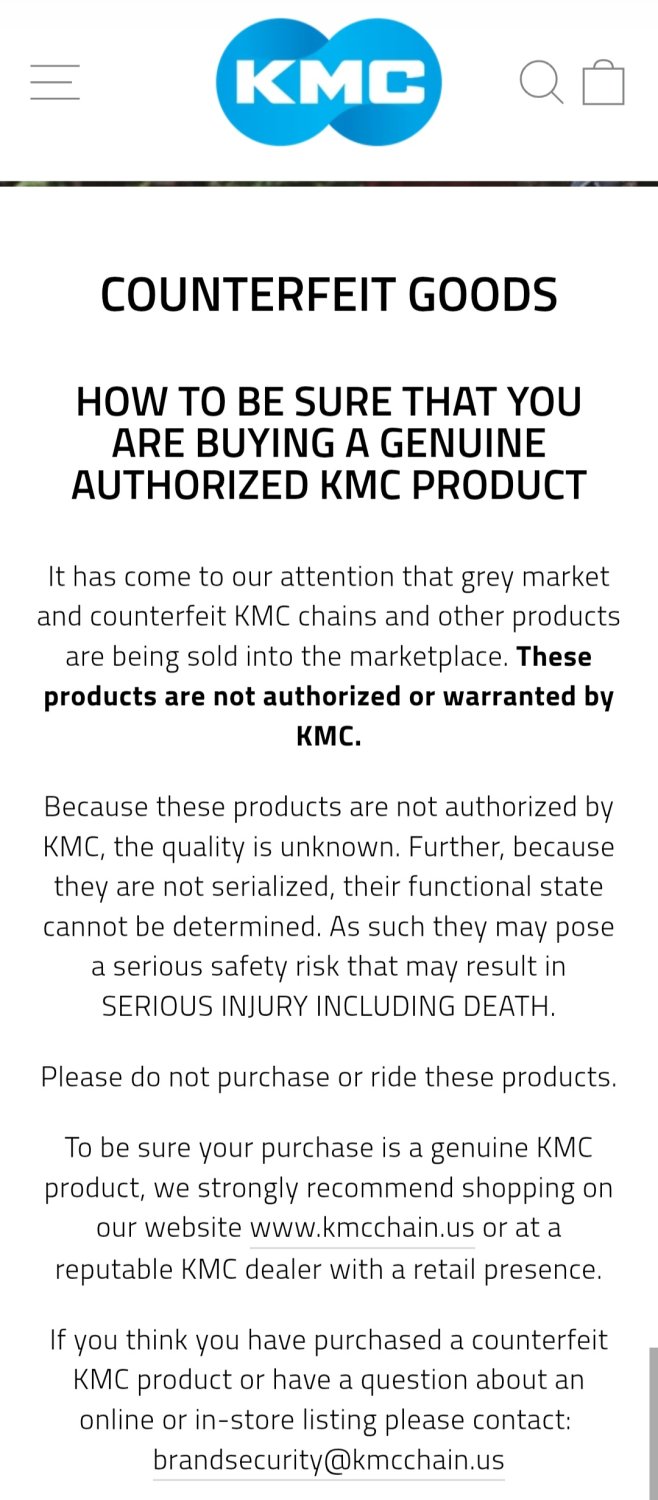

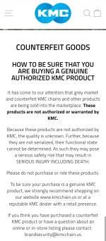

The scary part is that I could have a Fake Chain !!
I Could Be KILLED !!! 😁

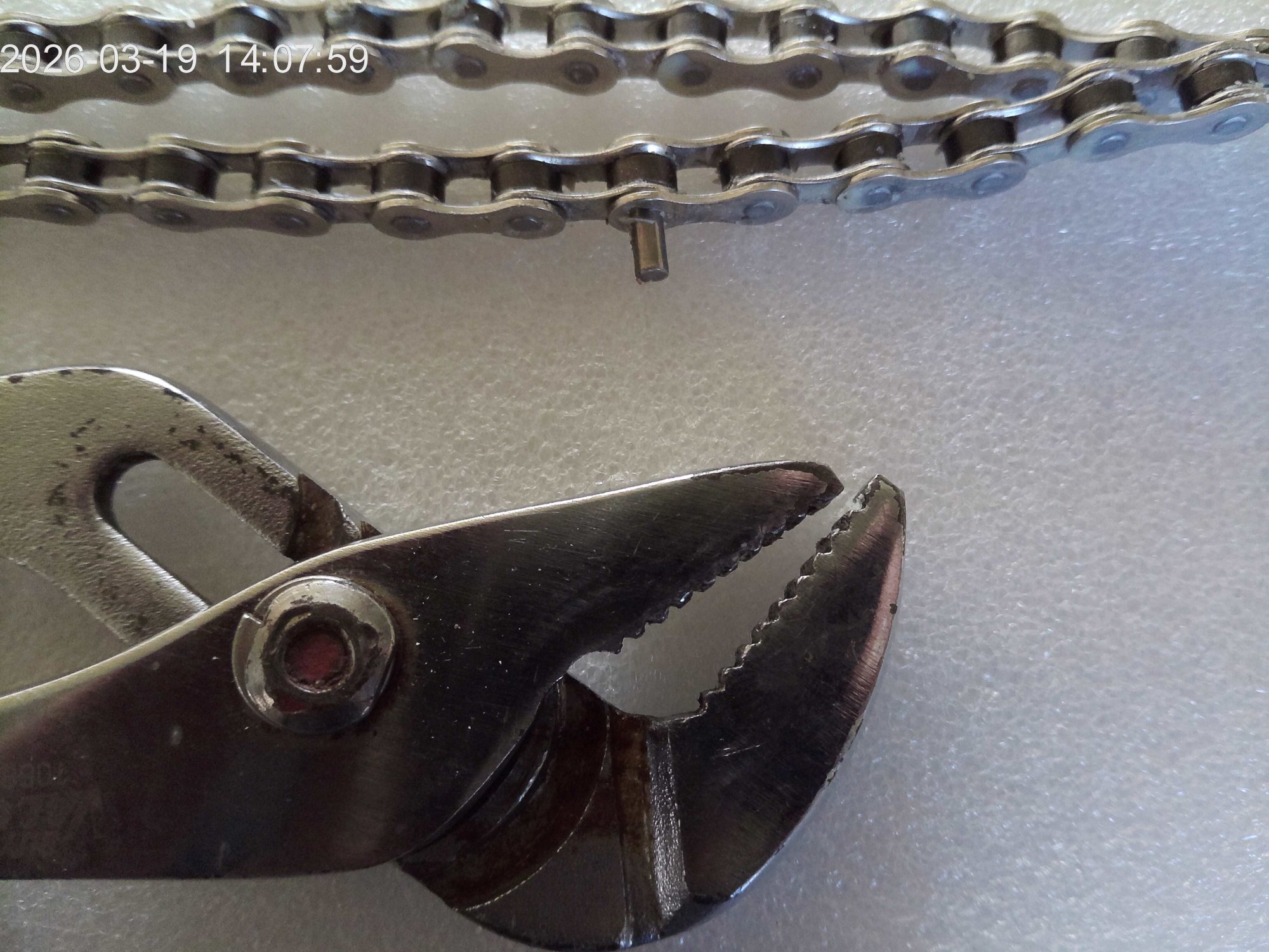

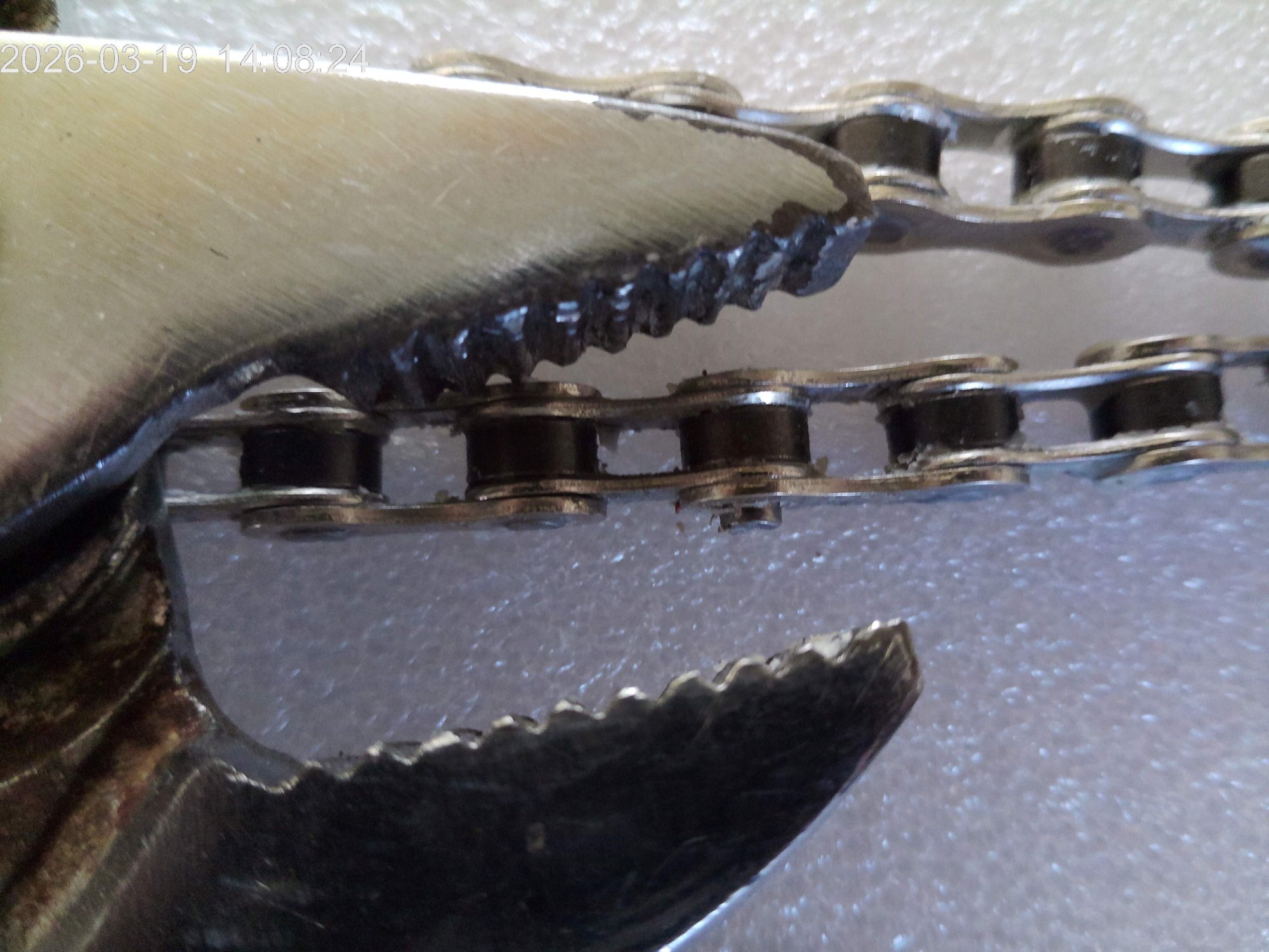

@PCeBiker, Yes you need a 5,6,7,8 speed chain. When I make chain book marks that weigh down the pages so I can eat or write while reading, I extract the pin to the outer plate and leave it there. Then to connect I use a channel lock with 10 inch handles to push the pin back in. Finally I use my chain breaker to seal the deal for the correct adjustment.

,.. I extract the pin to the outer plate and leave it there. Then to connect I use a channel lock with 10 inch handles to push the pin back in. Finally I use my chain breaker to seal the deal for the correct adjustment.
I tried that.
I couldn't rotate the first plate outta the way to separate the chain,..
I've never had a problem with chains from single to 11speed using a standard Park as well as department store chainbreaking tool. Need to have a feel for when pin is pushed out enough without completely removing it (although the pin can be replaced if accidentally removed), also need to work chain if it initially binds to loosen up the link. Recently had a KMC 8 chain with some sort of difficult link that had to be twisted, ditched it and connected directly. YMMV

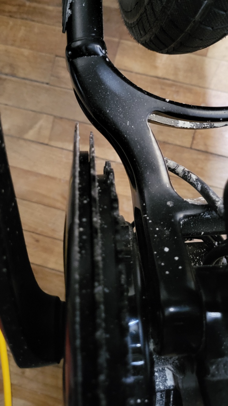

Just measure the frame shell and buy a BB with the same measurement.
I was a bit mixed up there, and didn't realize that you weren't replacing your bottom bracket.
When I bought new chain rings, I just measured the clearance between the teeth of the original chainring and the frame to see how much room I've got for a different chainline offset.
And I measured the clearance between the teeth and the chainstay to see how big of a chain ring I could install before it would hit the chainstay.
Keeping in mind that the two measurements change as the chainring were to go in and out.
