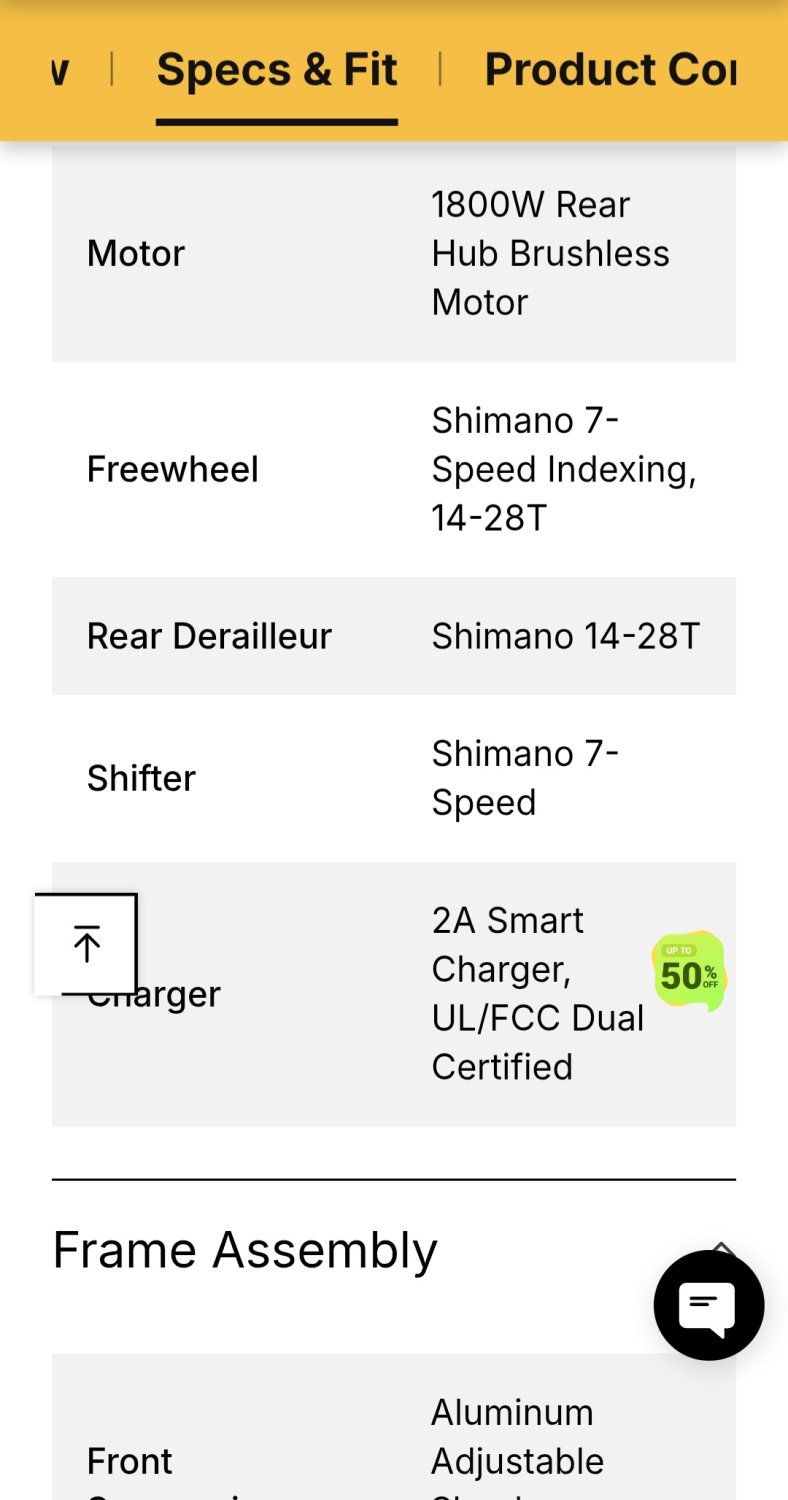

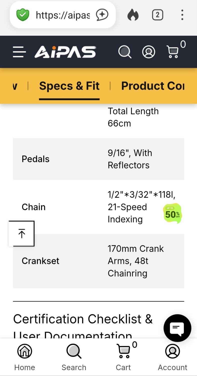

This is from the Apias website,..
@Go-Rilla
If you buy a crank set with a 48t chain wheel and 170mm crank arms, it will be a direct replacement, so no chain issues.
@Go-Rilla

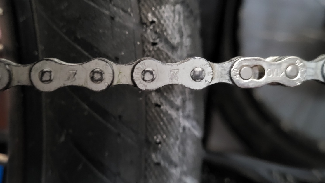

I wasn't gunna bother with an ebike chain, and already had a KMC Z chain in my shopping cart when I realized it was too short, so I bought the e8 chain.
Both my ebikes (hub drives) came with a custom length KMC Z chain.
That's what I've been using while I figure out how long of a chain I need.

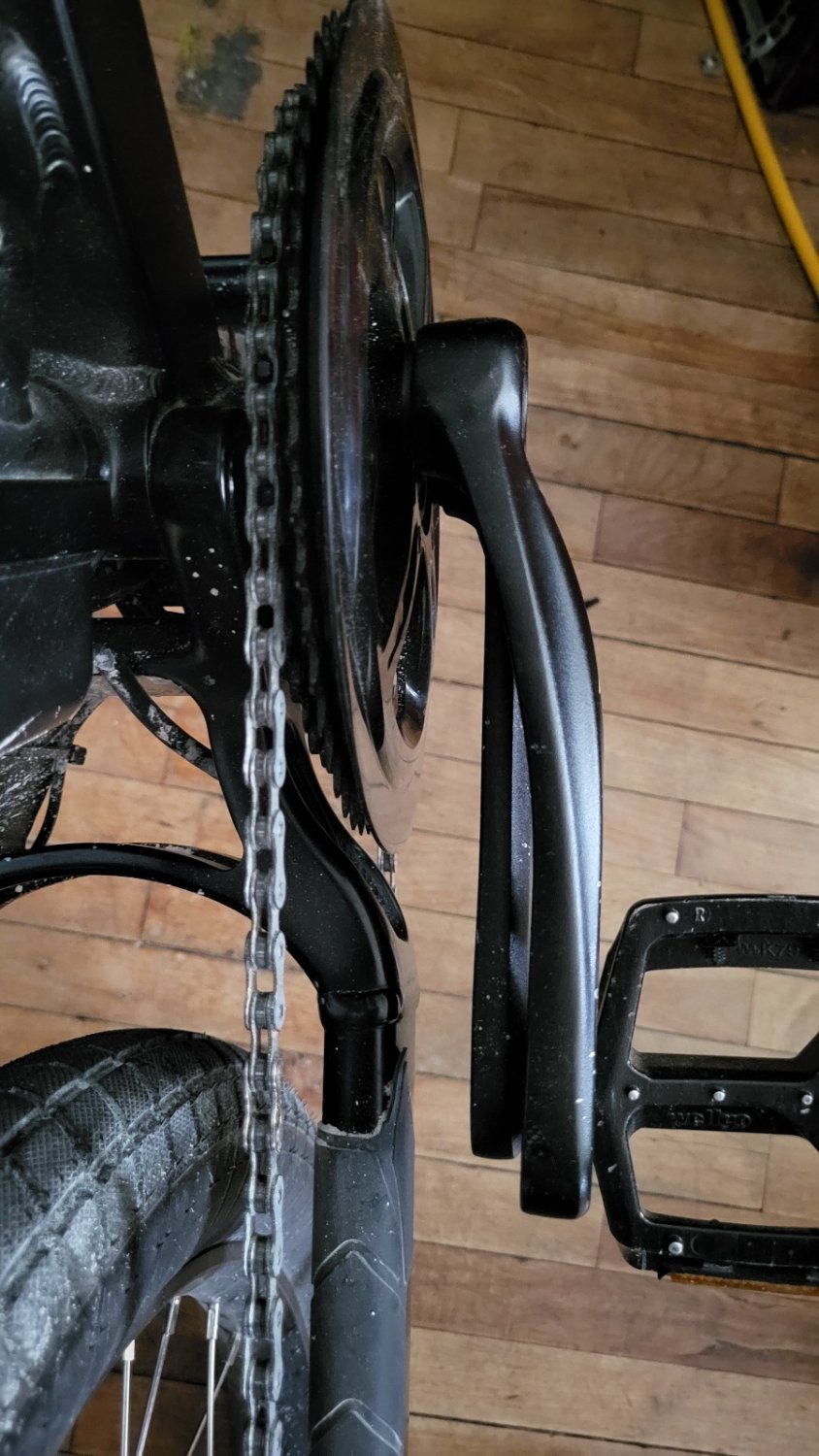

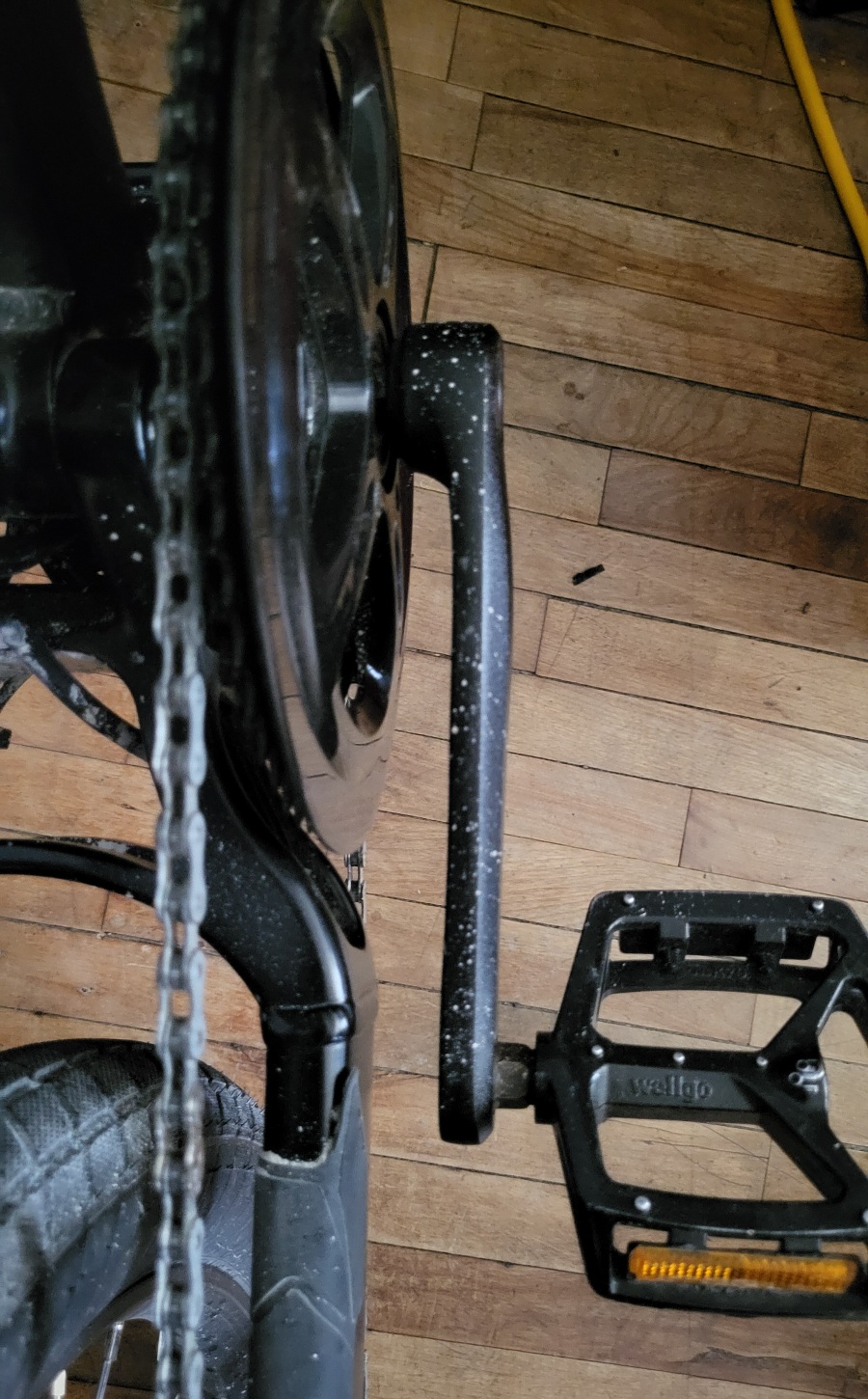

@Go-Rilla don't forget about your crank arm offset.
My mid-drive came with crank arms with almost no offset. (because the mid-drive has a longer crank shaft)
The original crank arms needed to be offset to clear the chainstay with the shorter original bottom bracket.
