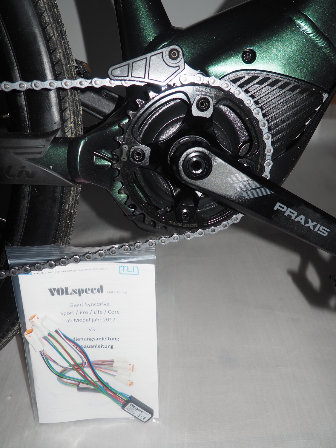

I decided to go digital way; just as this great thread started thanks to @Stefan. This time that electronic solution is VOLspeed V3.
Let's start, get that in that slim LIV Vall PRO 2021 body :)

let's start....one post per operation ? I have to raise my post numbers :)
first step....remove Crank
no sound (I had to cut out sound ... inappropriate language :) ) , but that first bang when the bolt loosens is very nervous because you don't want to break the axles on the new bike..

So,who survived the first bolt bang with me :), can continue, others please select easier topic :)
With help of Lockring tool i had no trouble to remove chainring bolt, unscrew clockwise ! :
then remove plastic under and side cover and its here :) in all its glory:
unscrew top motor mounting bolts M8 and M6 bolts, loose bottom bolts to drop motor. Won't drop ? It will with little help of wooden wedge on front motor housing bolt bulge and frame. Don't mess up with metal screwdriver, you'll damage frame and wiring,
it's out:

so, let find some space .... first make some support for motor, it will take some time now ...
