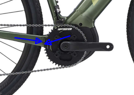

@almikel: Be careful as not to make a mistake. First of all, the chain-guide should have markings indicating possible chainring sizes. Secondly, I'm not sure what Bolt Circle Diameter (BCD) is appropriate for your chainring. Thirdly, a larger chainring might simply not fit because it could be hitting the chainstay. The stock photo of your Revolt indicates the latter might be the case!
Be careful as to avoid future frustration.

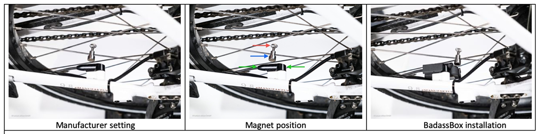

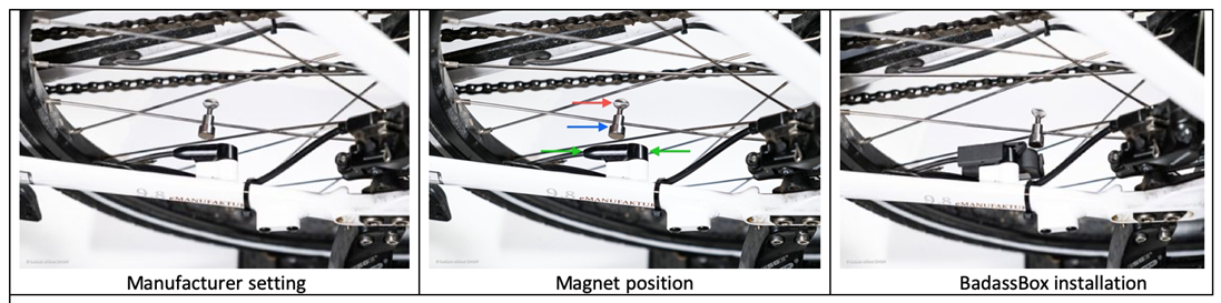

I have friends that have fitted the Bad Ass Box (BAB) - a small device that fits over the stock speed sensor.
Very simple install - especially if your Giant has the speed sensor on the rear wheel spoke rather than in the rear brake disk.
If spoke sensor, then literally < 5 minute install and sub 30sec removal.
My understanding is that the display reads 1/2 actual with the BAB fitted, and my mates have commented that on long downhill pavement they still occasionally hit the limit (ie display exceeds 25km/h and the assist cuts out), but never on the flats/uphill.

There's no markings on the chain guard, but plenty of travel...and in reality I don't need a chain guard on the 1X for my usage (99% road)...my old school 3X dualie doesn't even have a clutch derailleur, and only suffers chain suck occasionally on serious off road terrain...
...I always wanted a chain catcher for the inside of my 2X road acoustic...I swear it has a special sensor on the front derailleur...it shifts flawlessly and never dumps the chain on the inside ever...until I'm tired and cranky and over it - then when I drop to the smaller chain ring before a big hill, the "special" sensor knows I'm tired/cranky/over it, and dumps the chain on the inside :(
Modern 1X setups with the taller and narrow/wide chainring teeth plus a clutch derailleur on a gravel bike like mine should make chain suck risk negligible...I could just remove the chain guard..but if it fits a bigger chain ring within its range I'll just leave it.
I was always going to seek a replacement chain ring with the correct BCD (104)...but I hadn't considered the chainstay clearance!
On looking closer it appears OK - this is the clearance with the stock 42T chainring
Great pickup though - a shiny new chainring fouling on the chainstay would be tears before bedtime :(

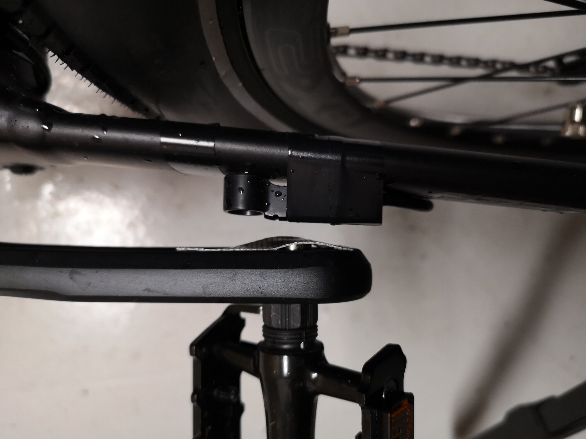

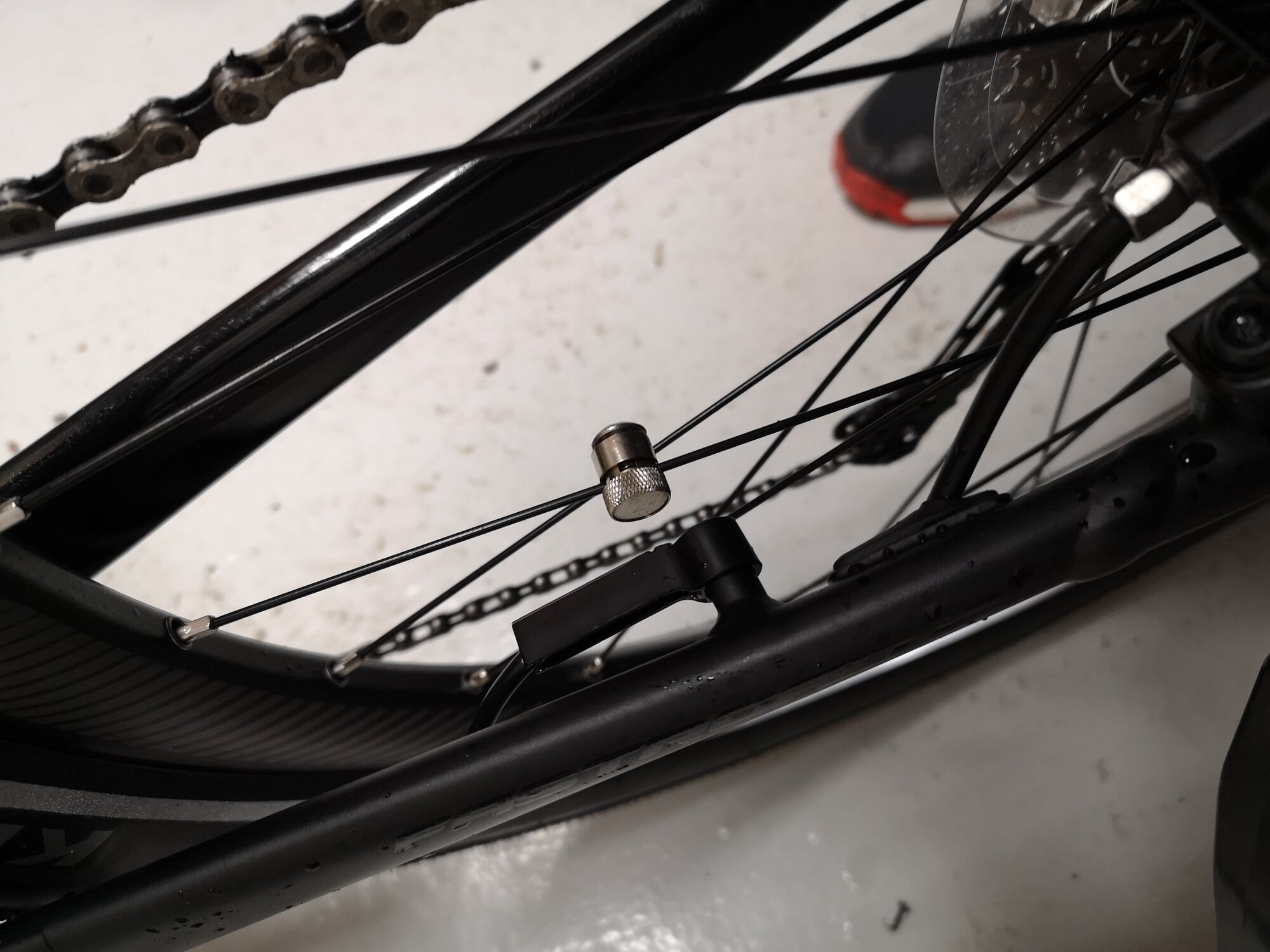

Standard sensor position
Modified position
I used the magnet trick on another bike of mine, a Moustache MTB, with a Bosch Performance Line motor and it worked well.
So I then did this with the new Giant. It was working fine for 2 days but yesterday the display showed a Speed Sensor warning, so I shut down the power and rode home using the old-fashioned leg method.
