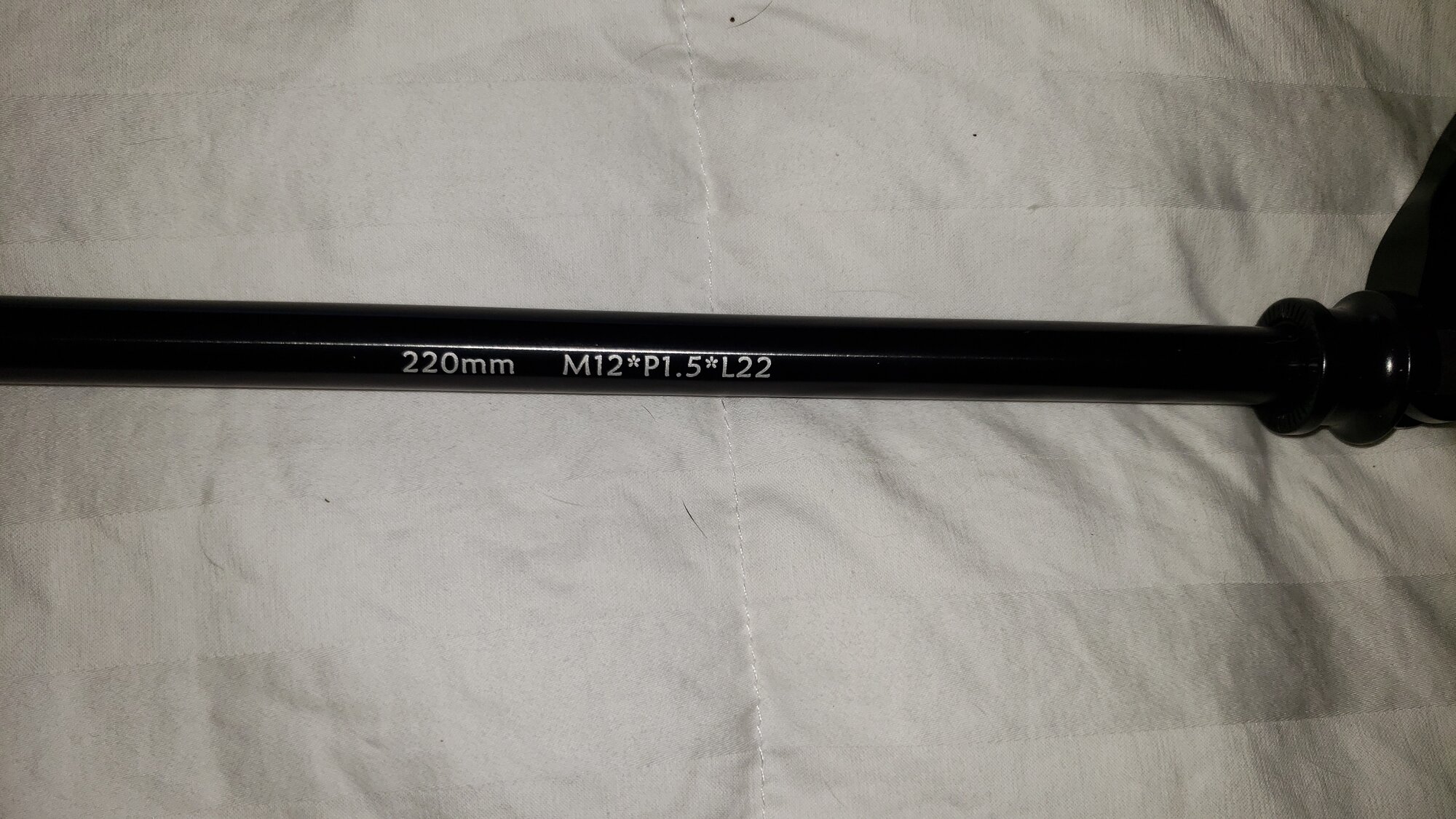

Is that a thru axle like the front? Is it 10mm?
It's 12mm diameter, 220mm lengthView attachment 83732
Hmm I wonder if I get the brackets for leili for the thru axle conversion. The o.l.d. spacing is 190mm. The Kindernay XIV fatbike for 190mm spacing only comes with a 10mm axle. Looks like I could make the brackets at home for a 10mm thru axle. I can't get a thru axle for 190mm spacing with the rohloff. Some one please correct me if I am incorrect about the spacing.
The Kindernay looks interesting but I'm going to see what Leili or Bikonit/Bolton come up with as far as a retro fit IGH. If the old axel is 10mm, and the SRAM replacement is 12mm, that might explain the axel break you experienced. Heavy as this bike is, better to fit stout materials in venerable areas.
