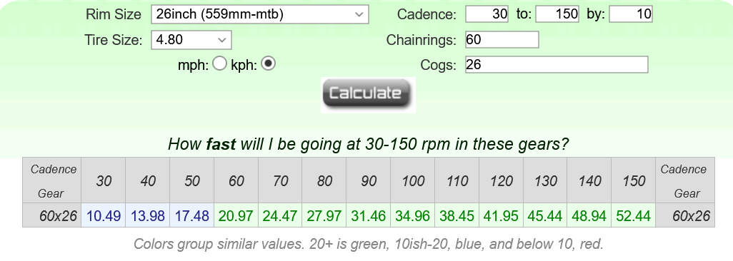

This option really interests me. Keep the reliable belt drive and just find the best all around size rear pulley. I would love to flesh this option out some more.
+1
I think a belt drive single speed might do it for me too. The current rear Gates 26T sprocket with free wheel and front 60T might work. The steep stuff becomes an issue but the motor could handle most of the situations I get into. It's really more of a cruiser bike anyway and not having to deal with gears would be great!
Where there's a will ... there's a way.
What rim did you find arctic and how will the freewheel function be obtained. Next question would be range of adjustment for belt tension with a fixed size rear pulley..
