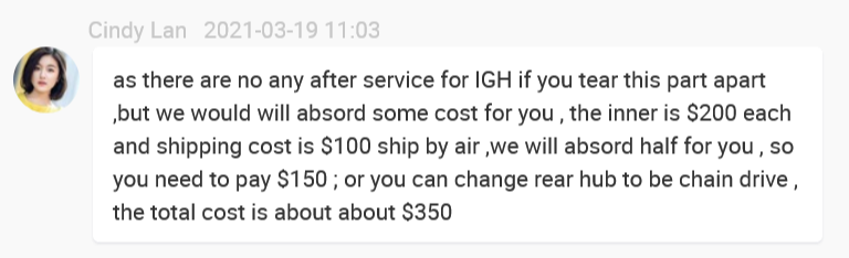

I agree with the warning Leili company. They do not bear any responsibility for the manufacturer. Only money can get new parts to replace the broken one. They accuse the customer of being a liar and claim that the customer himself broke the bike. I WILL NOT RECOMMEND TO ANYONE !!

Did you see the thread I started a couple days ago about ordering new parts for the IGH? It might now work for you if you live outside the U.S.

I ordered from Leili. They are offering a discount on these parts to people who bought from them. Basically is about $400 USD delivered. As usual, shipping is stupid expensive.
