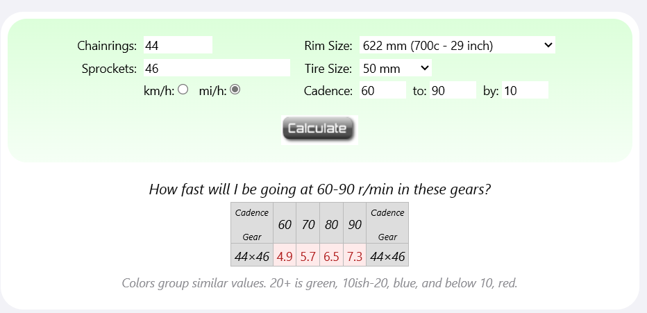

Speed at Cadence Calculator first. Enter all necessary data, of which the cadence the rider can maintain is vital. An example:
This is for my Vado, the granny gear (44-46T). My requirement is riding at 10 km/h (6 mph). As you can see, the gearing I have will allow me maintainong 6 mph at the cadence between 70 and 80, which is doable for me. Now, will I climb my hill?!

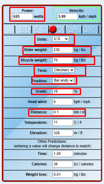

Bike Calculator is your friend here. An example:
Red are the input fields, Green is the calculated speed. Having all parameters fixed, only manipulate the Power to get at the desired Speed.
In my case, I need 625 W on the chainring to get me at 6 mph. My motor can provide up to 520 W mechanical. I need to pedal at least at 105 W. (In reality, it is not that simple, and you have to pedal harder to force the motor to max out).
I did that climb. I travelled at 6 mph indeed there
