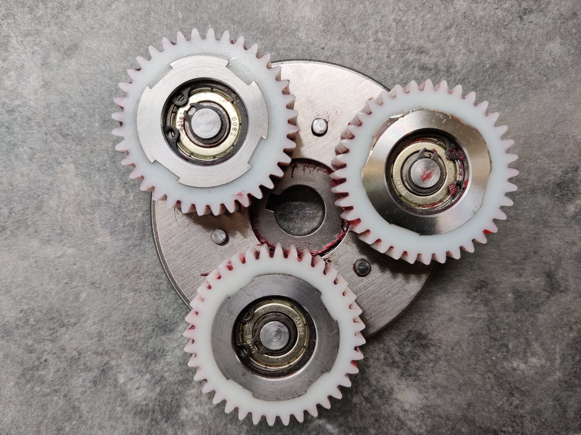

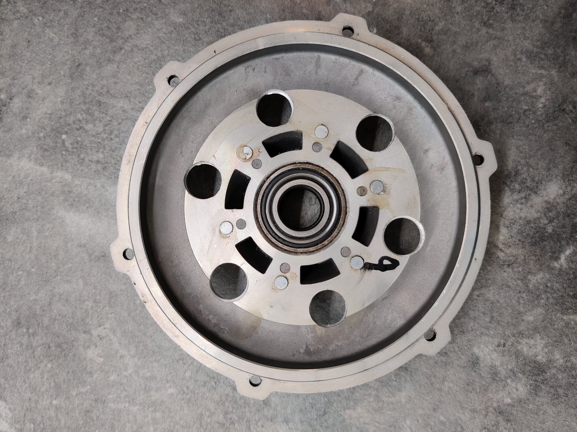

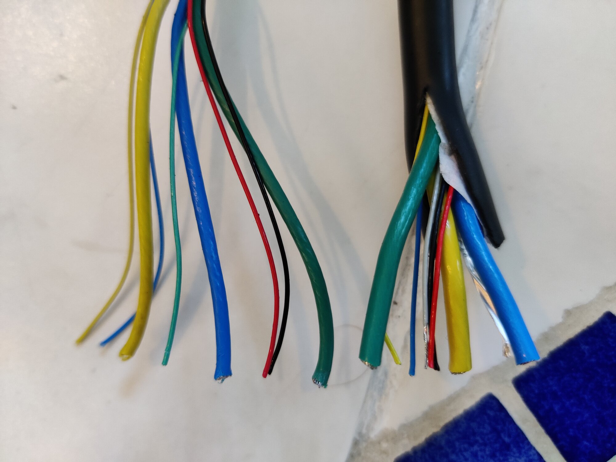

This is how my vented G062.1000.DC motor internals looks after I cleaned most of the old SHC100 grease off. Approx 1 year and 3000w peak power usage. Everything looks good 🙂

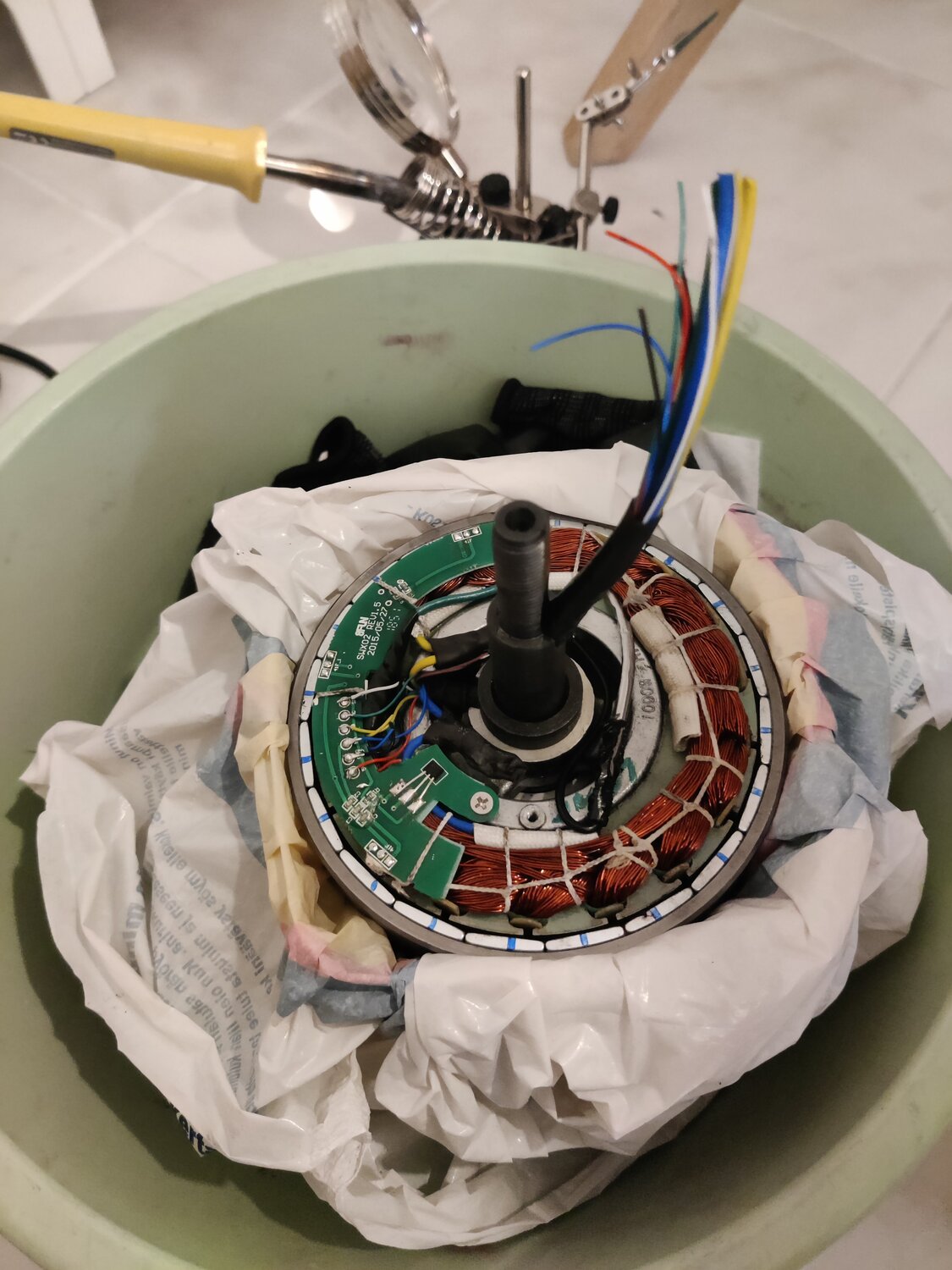

Motor now cleaned, rewired higher awg+two sensor wires, regreased, rebuilt and temp sensor installed.

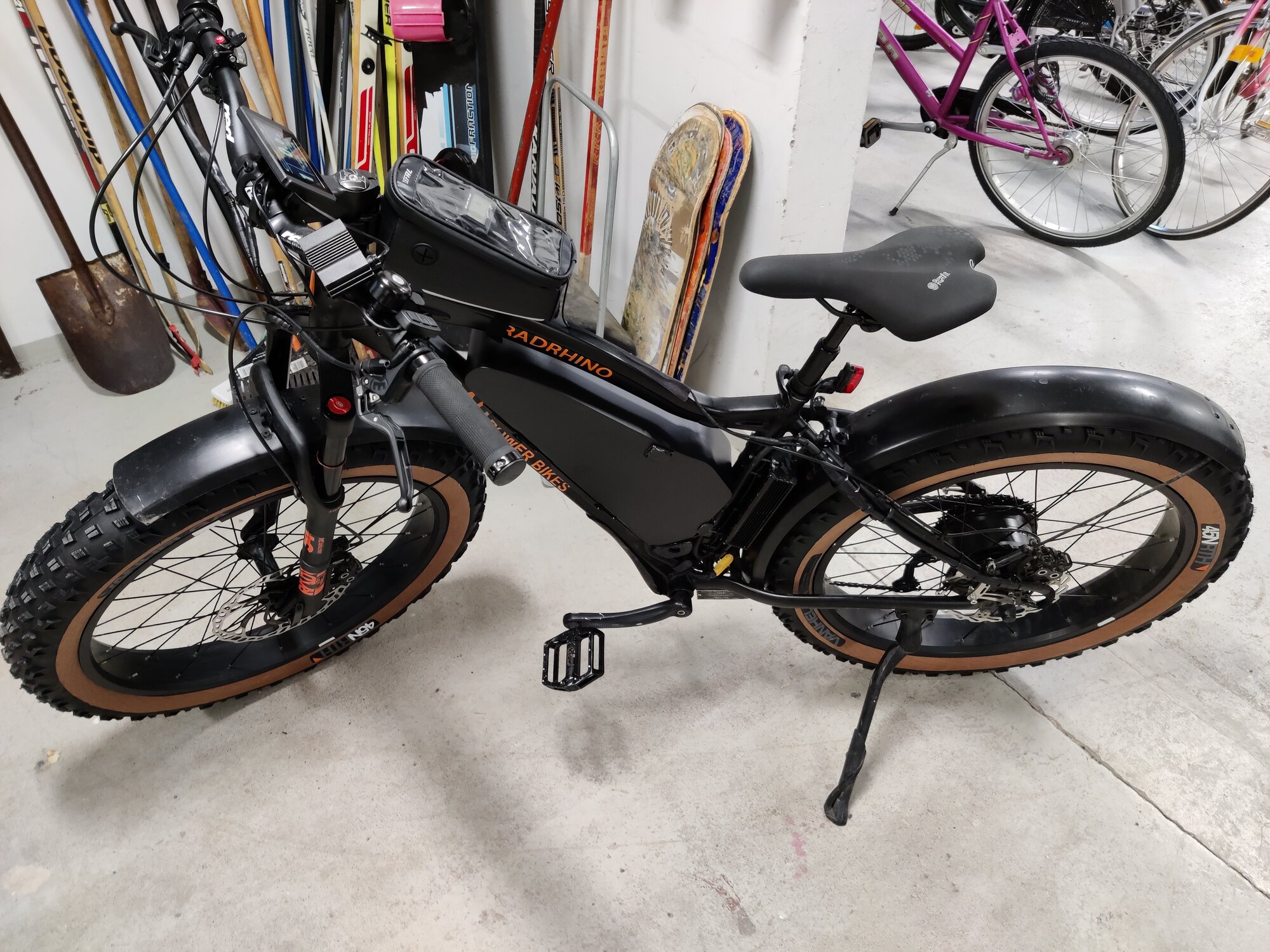

Big cassette hides that motor easily 🙂
Did first test ride after putting this beast back together. Relatively easy run with some short full throttle accelerations resulted in ~15 degree temp rise (vs ambient) in windings (only small test run).
I will next upgrade the controller to ~50-60A (60v still). It will be interesting to see how the temp log looks after I have the bluetooth system up and running😅
Controller current Max updated to 64A so peak Power 4000w 😁

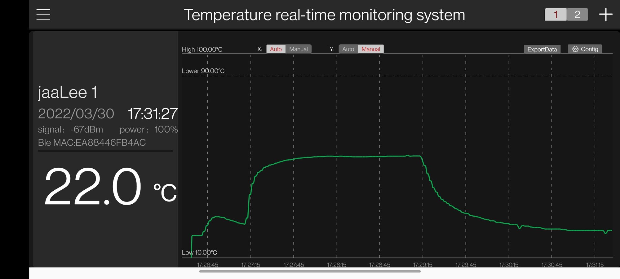

One step closer to adapt yet bigger power to the beast.
Aiming 60v 60A.
Bluetooth motor winding temperature logging system comes in handy 👌😎

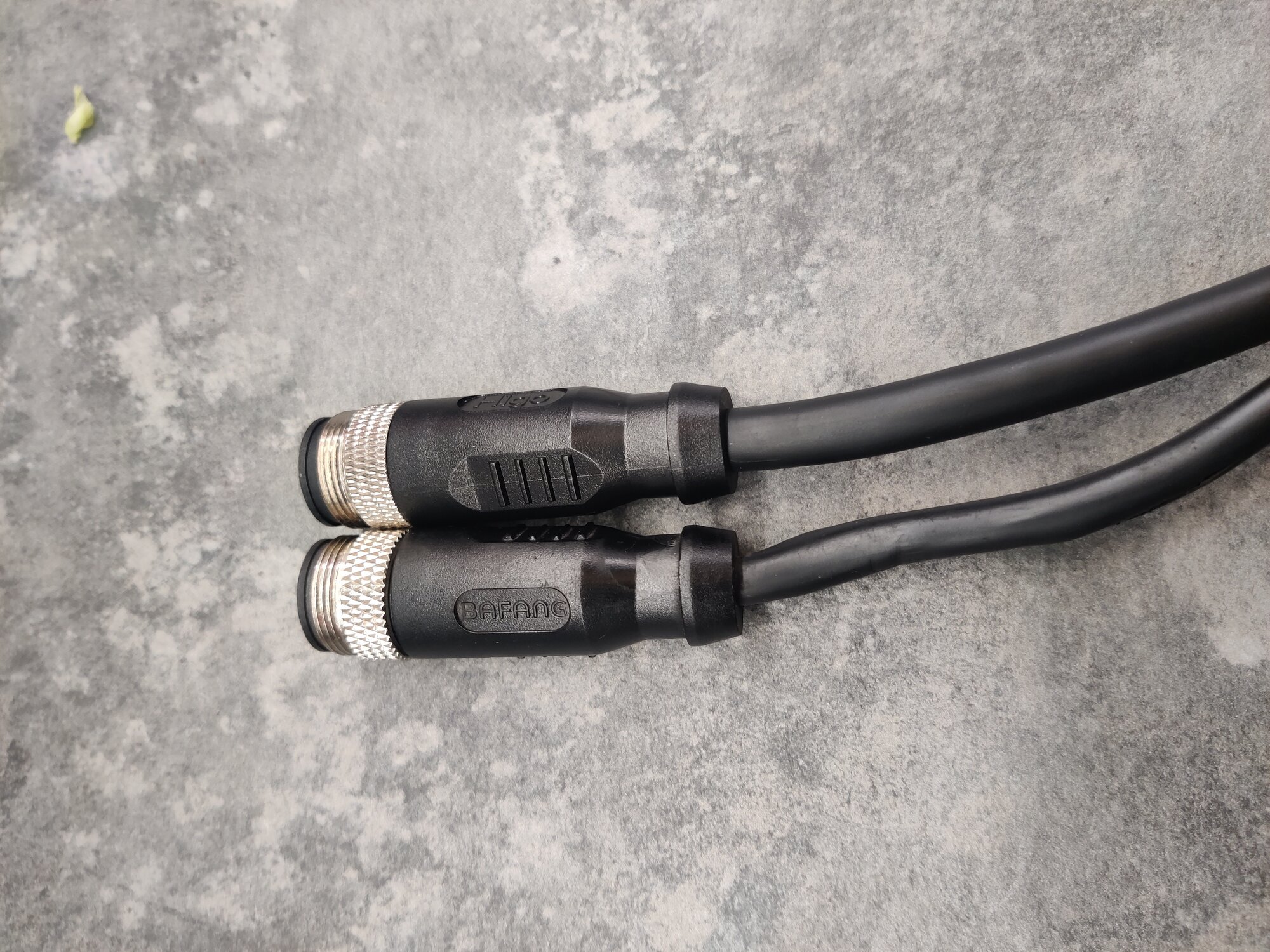

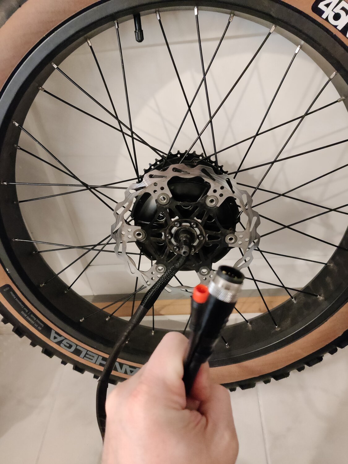

When you replaced your original G06 motor with the G062, was the replacement plug and plug and did you have to remove the whole thing (casing) and relace the new motor inside instead ?
New motor needs to be laced to the wheel. Motor connector is L10 so not compatible with stock controller (or 35A controller).
