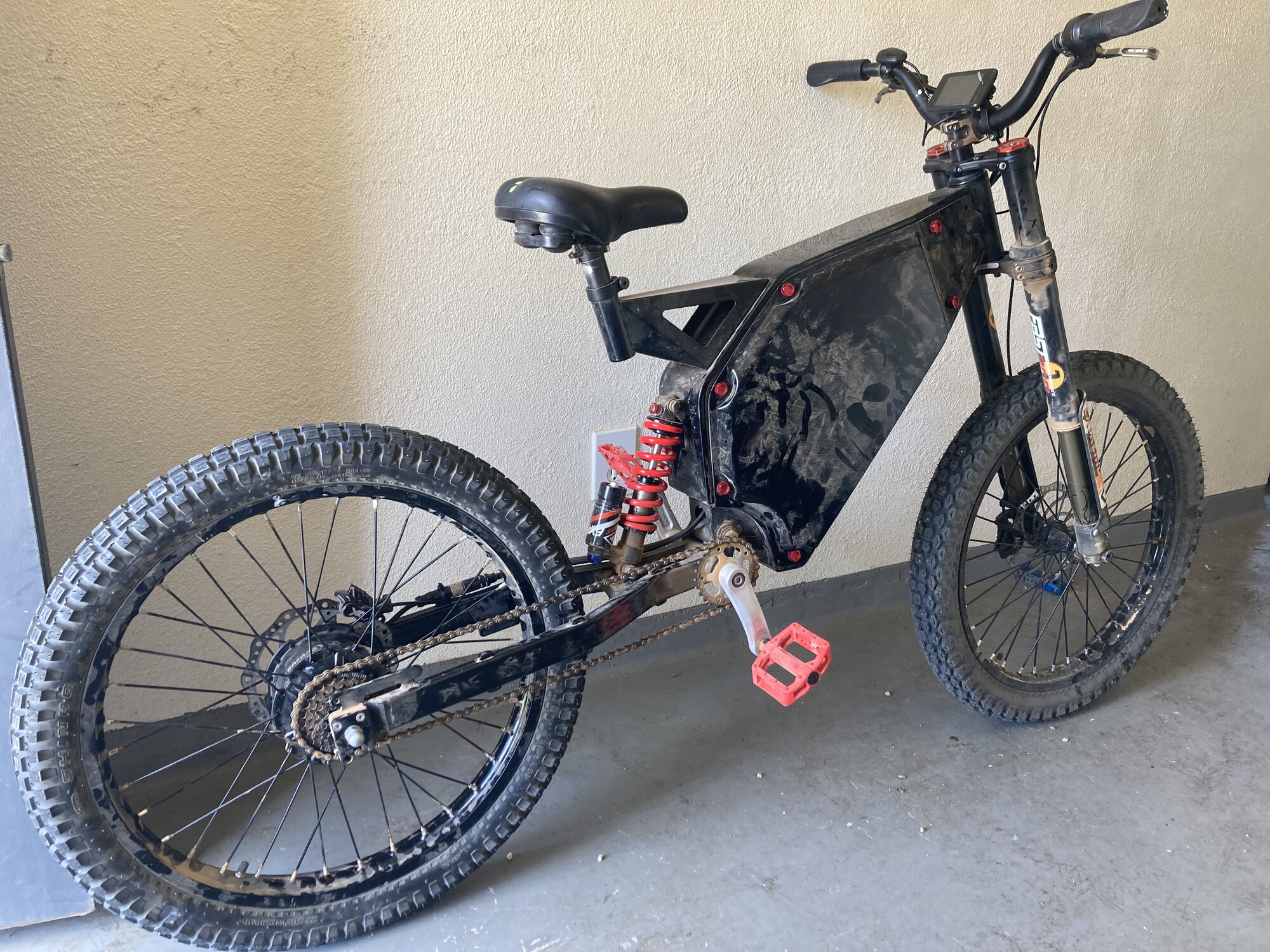

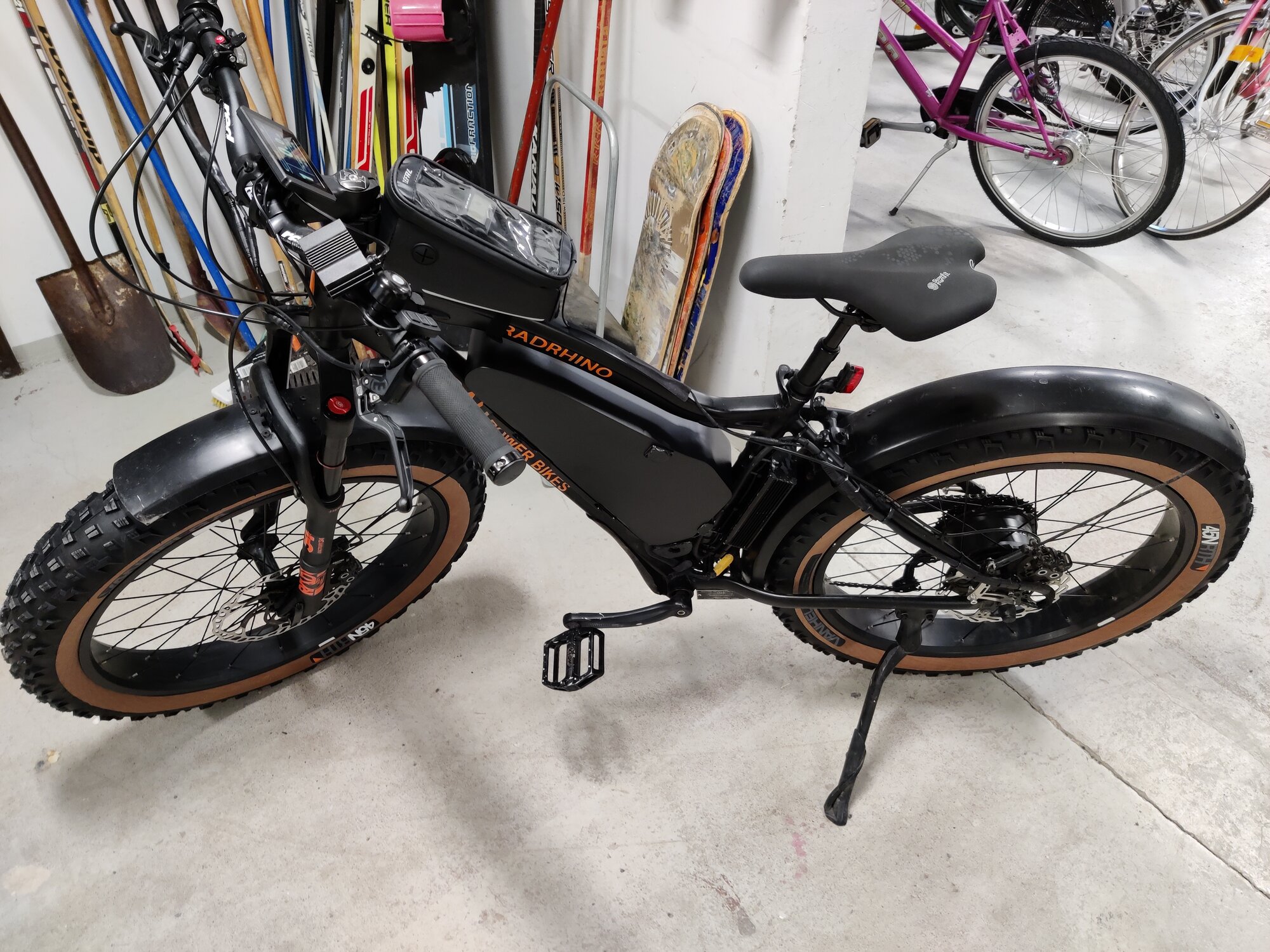

Rad Rover 60v 64A (4000w) regen
JTK77
2017 Rad Rhino (/Rover).
60v 24Ah 120A BMS (continous) lockable downtube custom battery (16s6p Samsung 40T) .

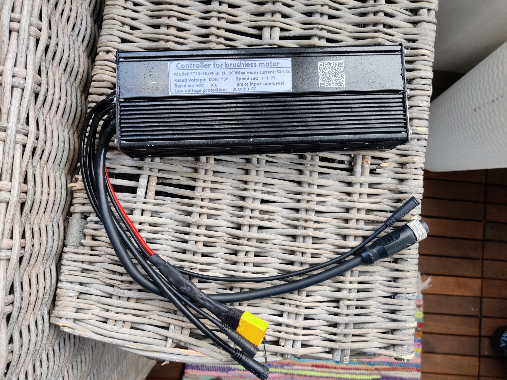

Custom factory ordered plug n play modded 75v max 64A sine save controller (L1019).

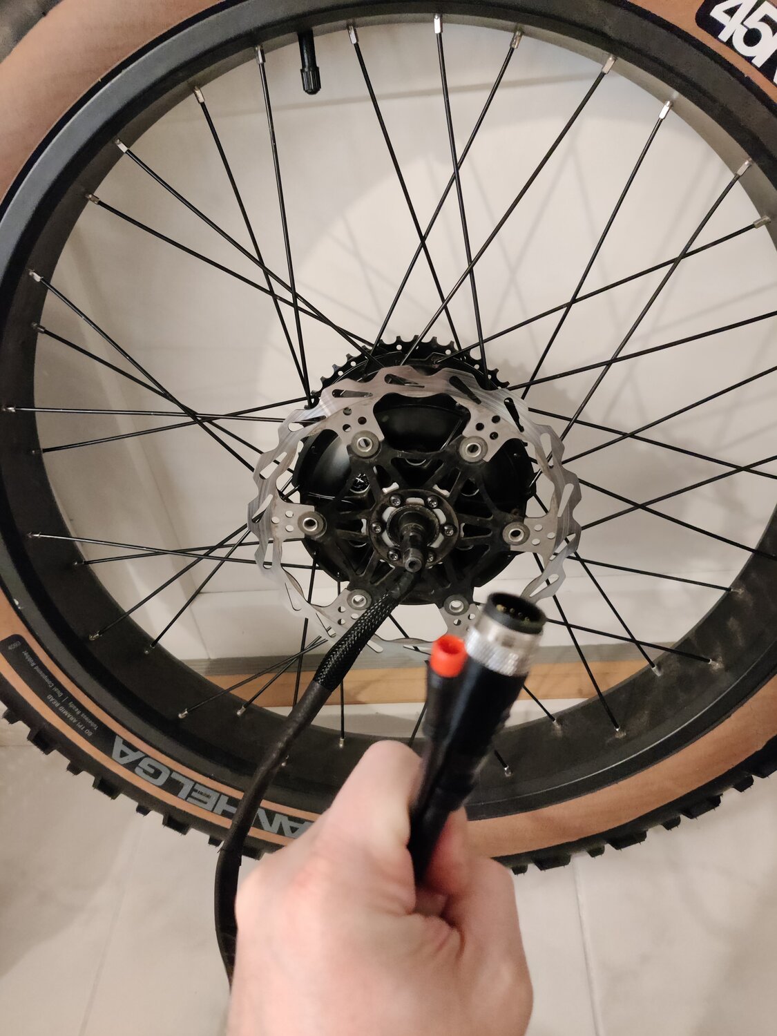

Vented G062.1000.DC motor with thicker internal wiring and temp sensor with BT/App functionality. Welded clutch for regen.
100mm Air fork with rebound adjustment and remote lockout.
Magura MT5e f223/r203 (Galfer) brakes.

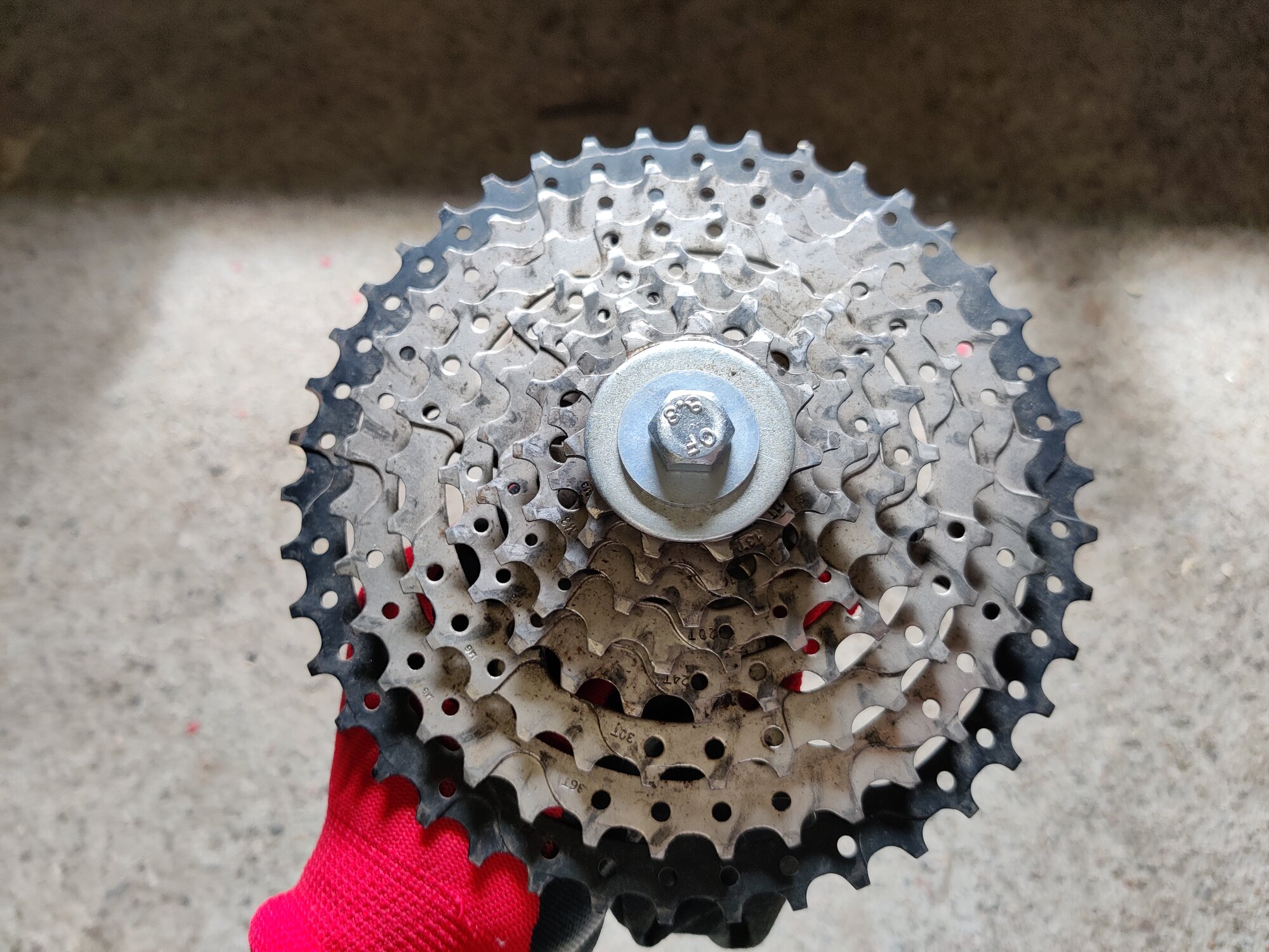

52t chainring 8 speed trigger shifter with 11-42t cassette and new deraileur.

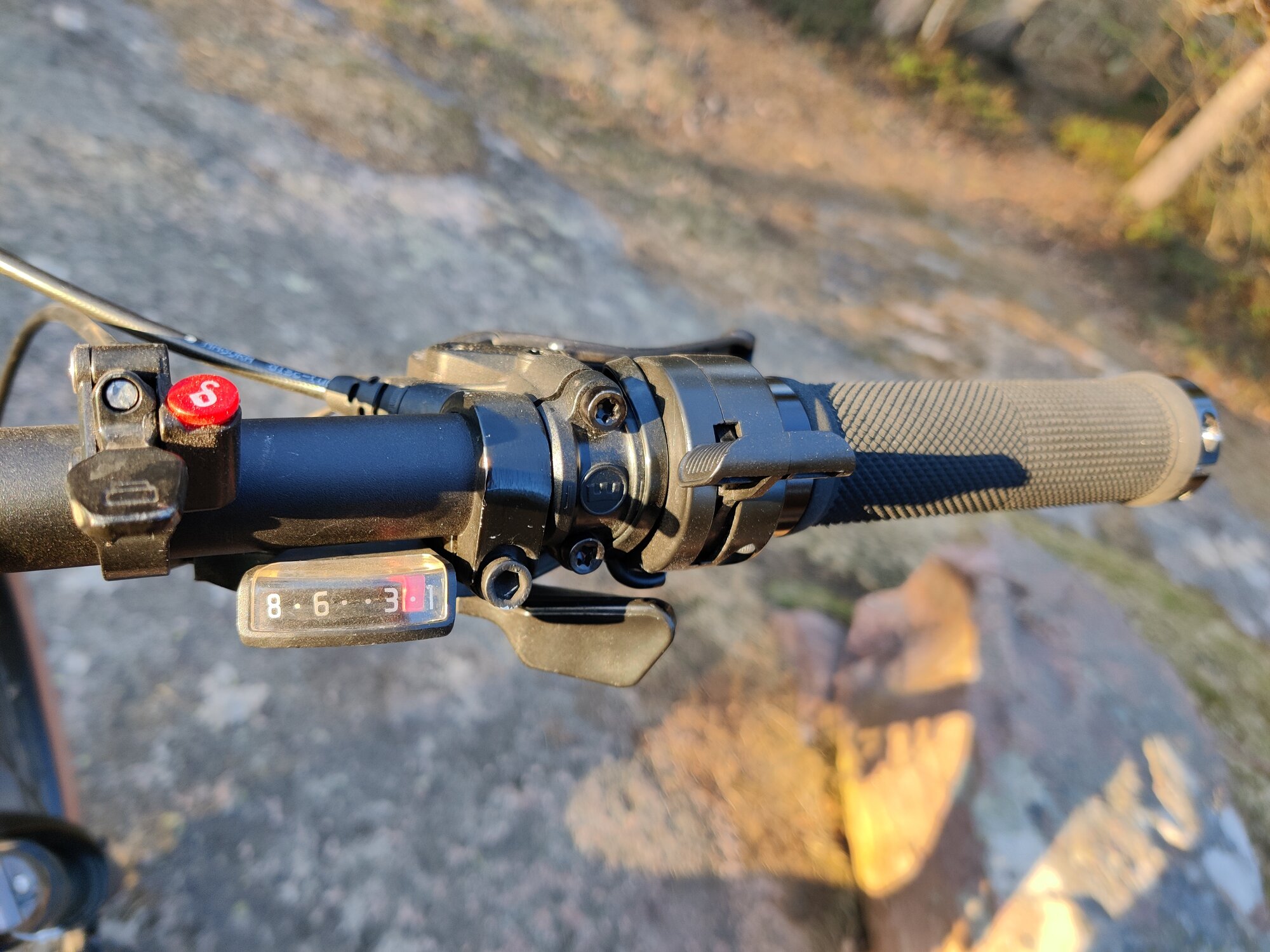

780mm Rad Devil Riser handlebar with full MTB grips, Wuxing x130 thump throttle, fork remote lockout. Custom headlight and tail light.
Suspension seatpost & SR MTB saddle.
Custom fenders.
Custom Kydex "carbon" skid Plate.
+ Lots of other mods & parts.
42mph ~4 kW.
0-20mph in ~2.5sec

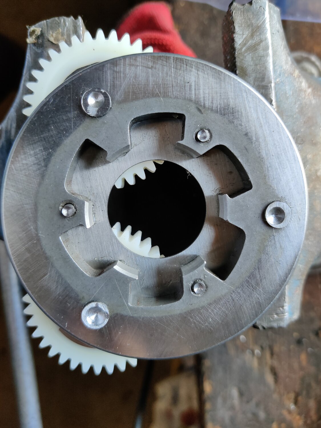

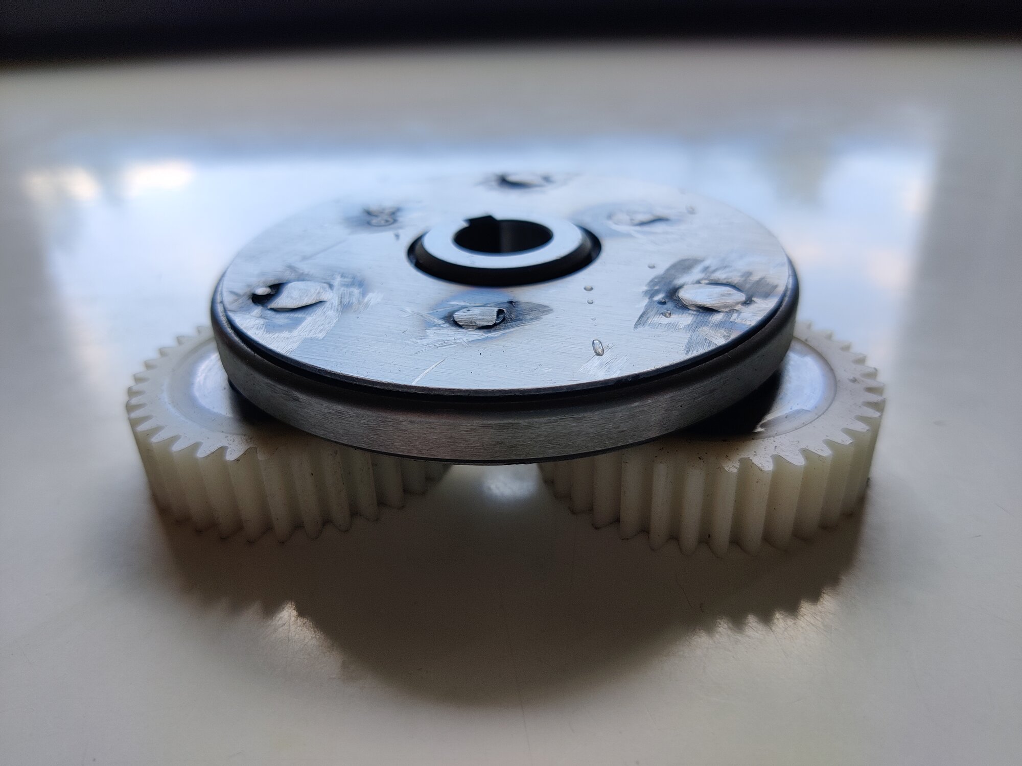

My main purpose was to make the clutch More durable for the high 4000w power. Secondary to help on braking. Regen should not function when battery is full.
When they are not overheated and well greased they seem to hold quite nicely.

When you blew the stock G062 @ 4kw, how high above 130 phase did you go? Did the clutch blow due to high speed top end, or low speed torque? Wondering if its primarily a volt/speed or phase current related stress.
Are you able to pedal the bike with the welded clutch or is there too much drag with the motor off? What phase current are you running with the 114amp battery setup currently?

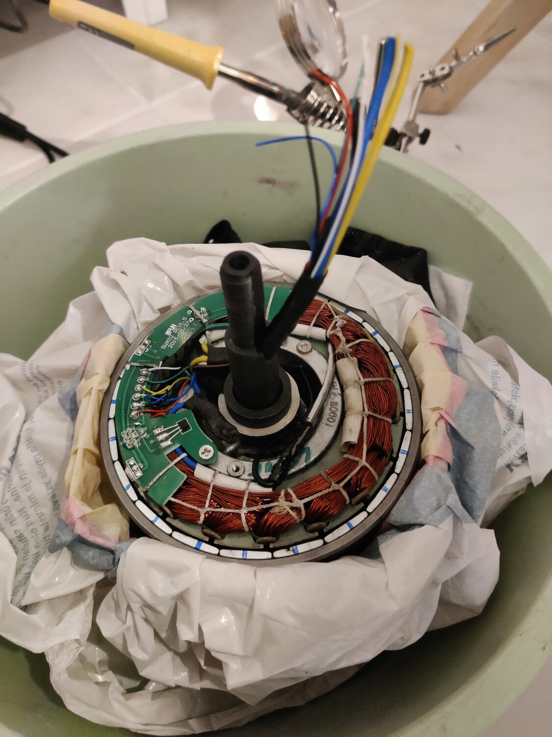

The motor had already some mods on it when the glue on magnets failed after some 1000 miles at ~4kw mark. Not sure of exact phase amps but 130+ something.
The clutch has not failed but I have modded it to prevent failure. I tested regen braking. It works but as it massively adds strain to relatively small axle flats and torque arms so I choose not to. The welded clutch does not add that much drag to the bike. At least not in speeds relevant going unassisted.

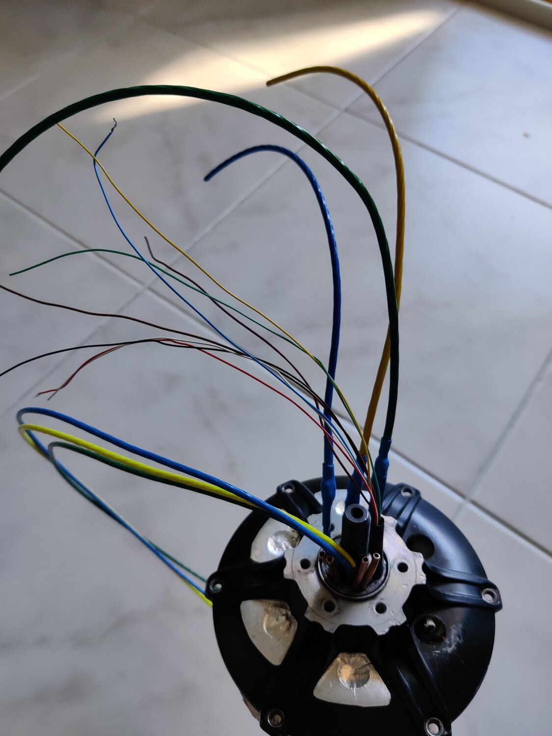

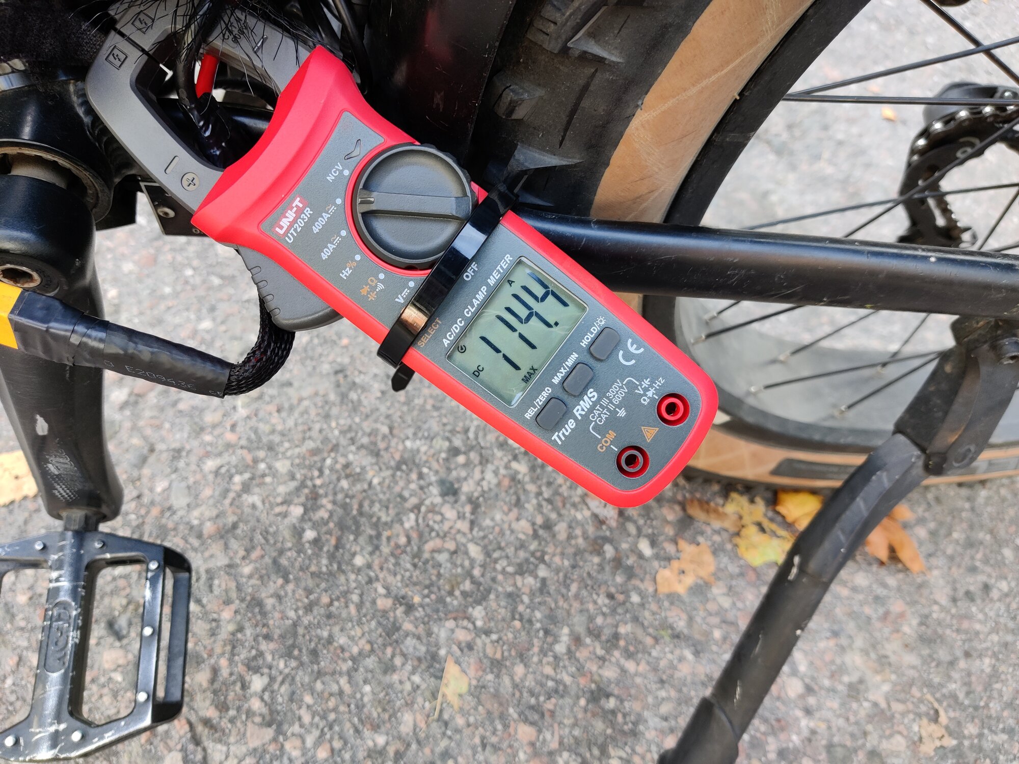

Latest I had my phase wire/motor wires fried. Those wires where upgraded to some extent but not enough (knew that). After about 1000 miles at ~6+kW peak they failed. I'm running the controller at 114A battery amps Peak so phase amps are 200+ Peak. Knobby tyres 0-30mph (GPS) is 3.9s.
Currently planning water cooling and axle mod to accomodate better wiring.

Magnet glue failed after very regular route. Not too much hills but speed and acceleration. 1000 Miles similar riding in The past. Winding temps ~100°C, Air cooling effective. Peak phase 130+(maybe even 150).
L1019 connector with 4mm2 wiring has not failed. Only wire part (~ 4 inches) that goes through axle is bit thinner (can't remember exact size) and failed. Thicker wire does not fit through as stock. I will do mods to fit 9-10Avg. I will also douple phases from controller to motor with additional MT60.

First thing that failed was the gluing of rotor magnets. That was after some time running at 60A (~130A phase) and couple times windings hitting 120°C peak. Now reglued with much much stronger heat cured Permabond ET5441.
Short section of phase wire inside axle melted after using throttle only (Gears Frozen in Finnish Winter) at 114A (200+phase amps) Peak.
L1019 4mm2 phase wire do heat easily with this power but do hold If high power is used only shortly.
I'm currently modifying the motor to have circulating liquid cooling and 8awg phase wiring. I have now doupled controller to motor phase wiring with additional 4mm2 Set with MT60 connector.

Trying to decide if venting is worth trying? Would you say the venting helps by 25%, 33%, 50%, 100%?
Did you only vent the rotor side, or does the cog side/gear side also have vent holes?
Is that some type of tape on the vent hole?

Thanks. Venting can help upto 100% but I'm not sure how big the effect now actually is. I would guess in range of 50%....both sides drilled identically. Aluminium tape is temporary thing. I will remove those. Maximum recorded peak winding temp is ~125°C (105-110°C peaks typically). Goal is to bring peak down closer to 100°C.
