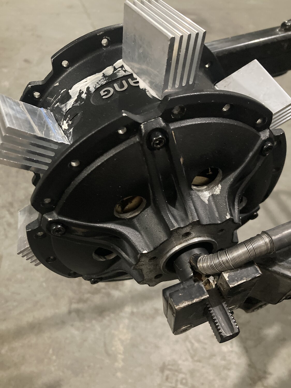

I ended up going with your venting approach! How has your motor been handling those power levels, any issues? Any issues with debris entering the motor?

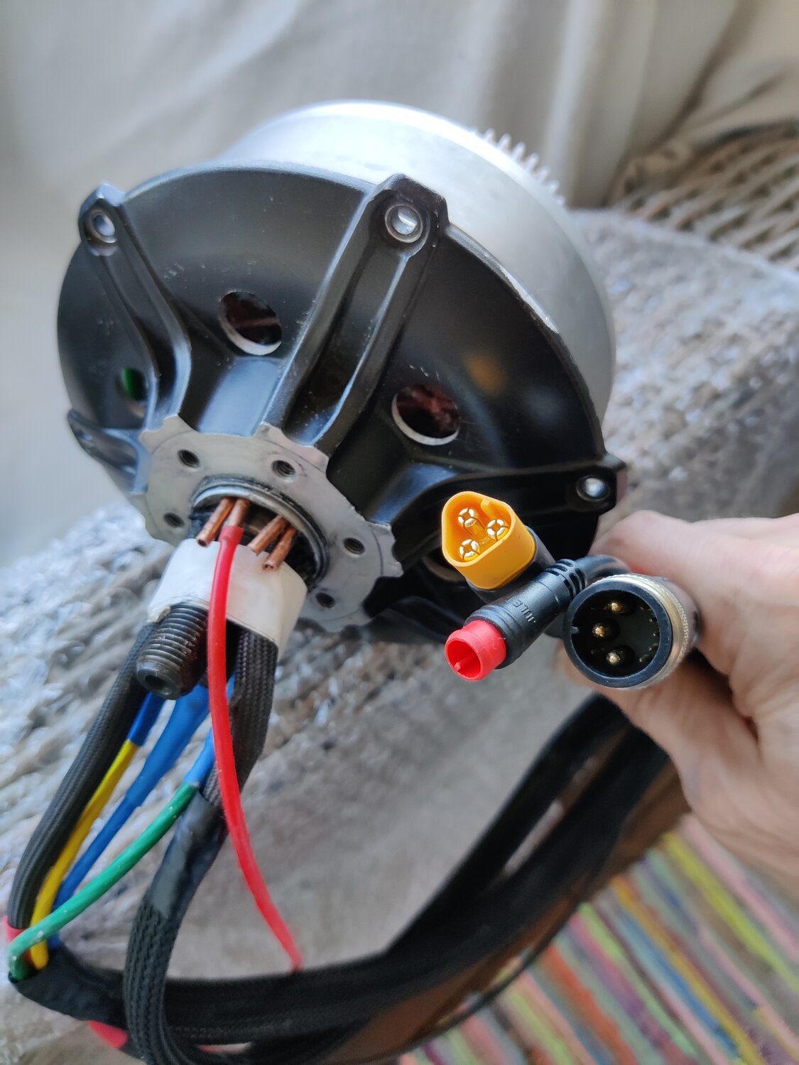

You have a sweet setup, and lightweight! The G062 comes in 750 and 1000, they are identical as far as I know- except the motor connector. I found a supplier that has the L1019 connector on the 750w versions, and 750w is the USA legal limit, so its the perfect motor for me in the USA.
Did you break the clutch at some point? You said you found the failure point around 4000w, curious what that meant?
The gluing of magnets failed at 4000w mark (heat and magnetic forces). Slightly upgraded motor wiring failed at 7000w mark.
Besides cooling the motor venting cools nylon gears so they can take lot more torque.

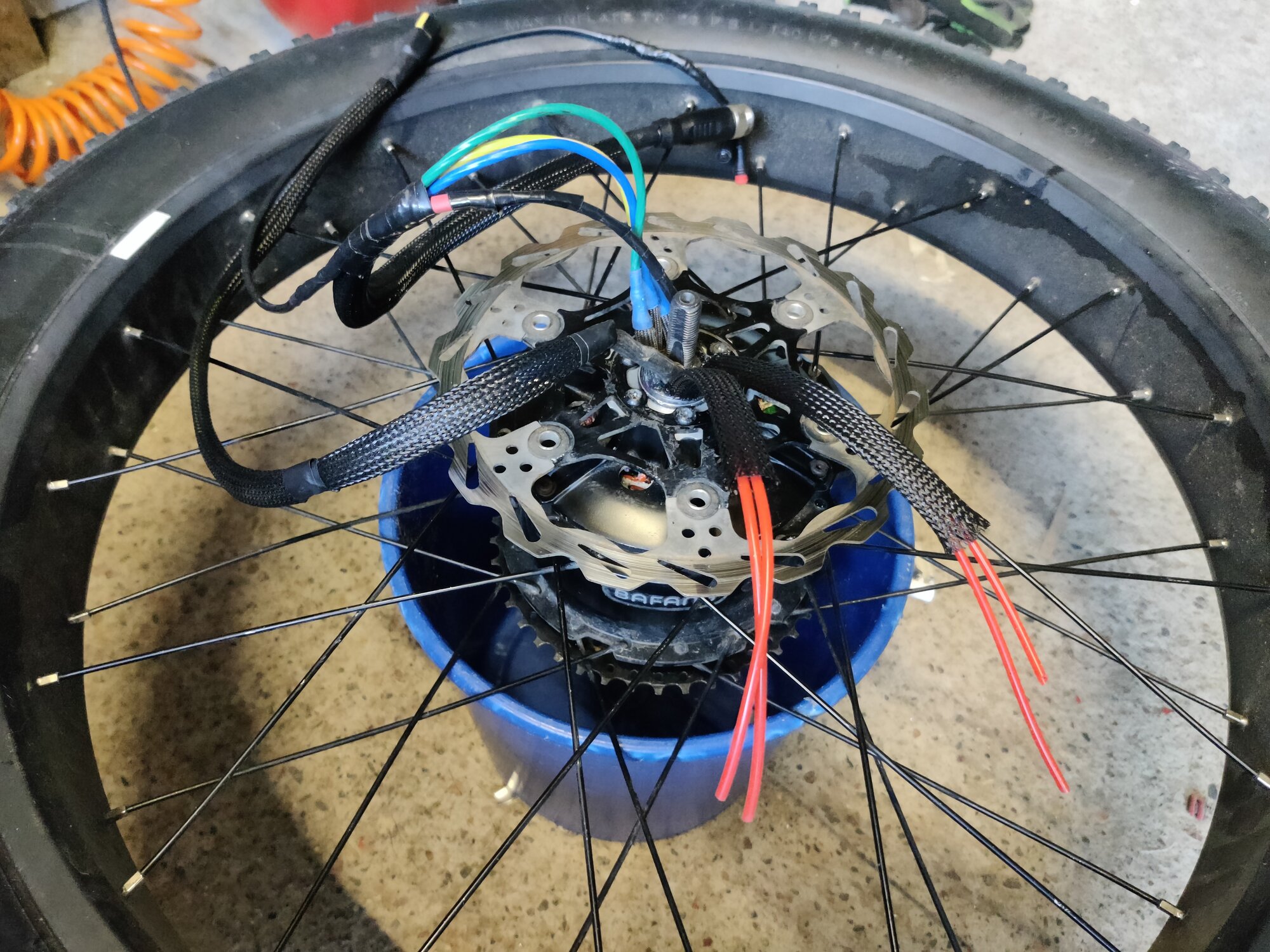

Yes, phases coming from my controller was 12 awg but stock G062 motor phases after L1019 are thinner. When slightly upgrading I replaced them with 12 awg exluding the ~4 inch part inside axle (13awg did fit). The wiring failed just in there although phases did not short but melted hall wires insted. Phase wires are heat resistant but hall wires are not.

Thats exactly what I do on one of my bikes. I was able to fit the 12awg phase wires through axle, just couldnt quite fit the hall wires through. Sensorless can be a little annoying, not sure if it limits torque at startup, but otherwise has worked great for me too.
My new G062 is a 14mm bigger axle, not sure if it has more room to fit the full 12awg harness through- thinking it may have more clearance than the 12mm? I guess if I melt my phase wires I will find out!

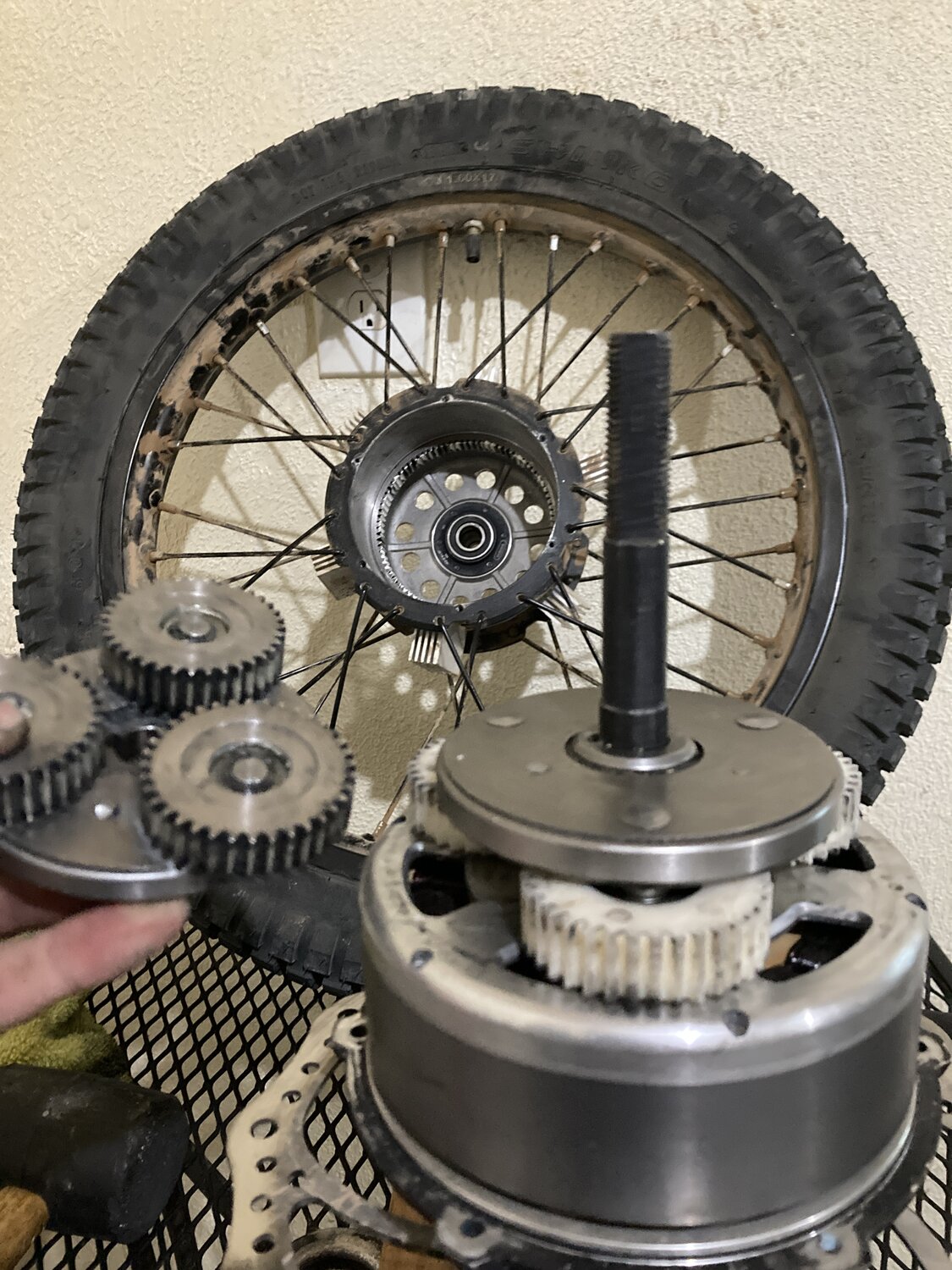

My clutch welded itself. Bike works perfectly fine, the only reason I knew is the sensorless speedometer started working when off the throttle. Took it apart and sure enough the clutch is seized. I also have a welded clutch but my concern is if the gears inside the motor were to seize or lock up, it could be a dangerous situation with the whole back tire locking up uncontrollably, so I’m hesitant to use the welded clutch?
Replaced with non welded clutch for now. Side note g062 uses same gears as G060 but the clutch is not compatible it spins the opposite direction.
