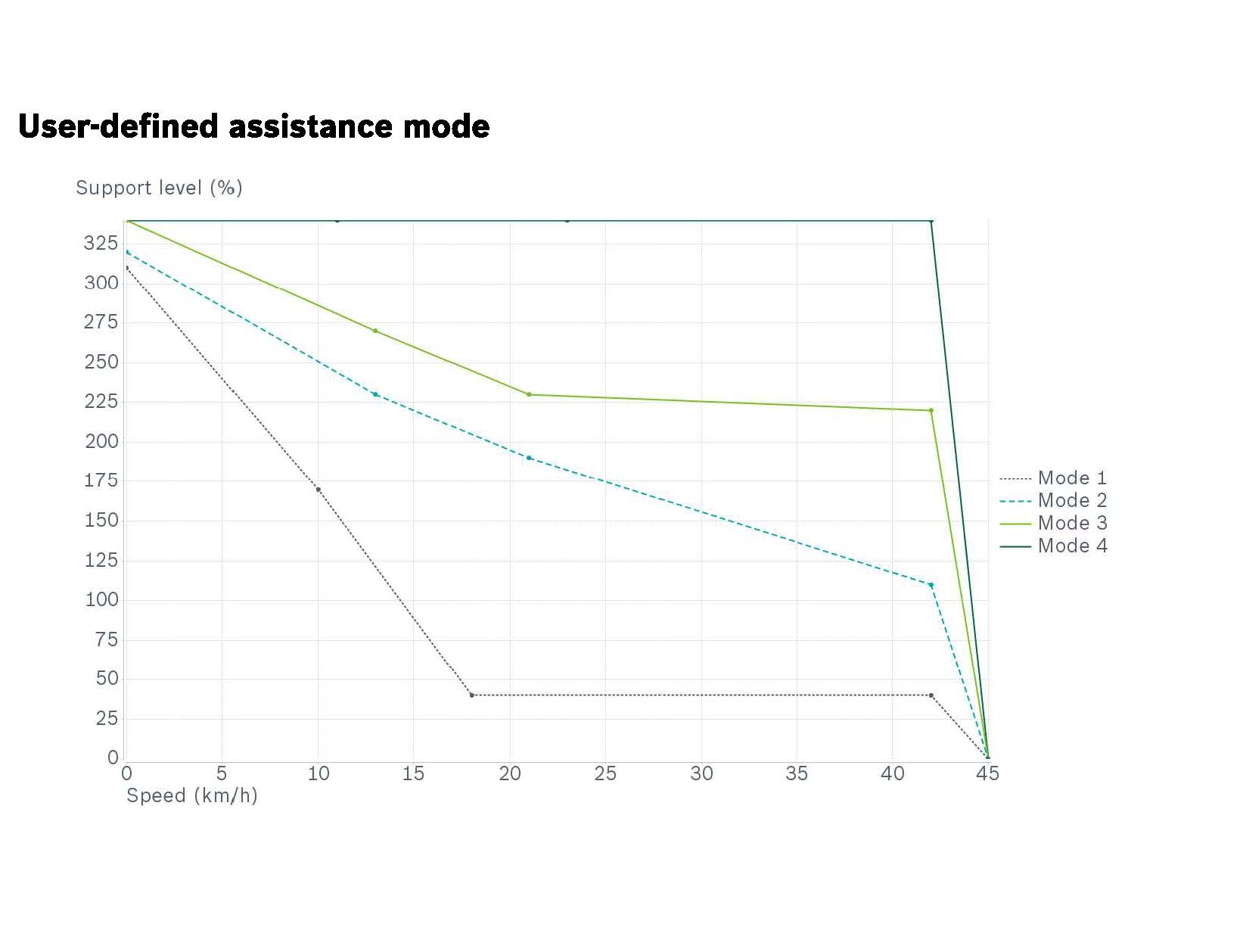

Here are my set of custom modes, I chose a higher assist initially to help getting up to speed and then drop down to conserve electrons.
That's really cool. Is the "Support level" a torque multiplier or a power multiplier? What kinds of controls do you have on the graph? Can you insert points? Can you do an Adobe Illustrator-like thing to have the points not be abrupt transitions but smooth curve fits?
Have you thought about making one of the modes a completely different type of profile? You have Mode 4 on high all the time, the other modes start high and then decrease, with 1 and 3 leveling off around 18-20kph, and mode 2 almost constantly declining. Would you even have a mode like this:
The idea, which I'd have to noodle on, is to have good power to get going, then drop down for middle speeds, then increase power to make it easier to get to top speed. Yeah, this "wastes" battery, but for some rides it'd be a blast.
You could also have a hill-climb mode with high power at low bike speeds, then low power for middle to fast speeds. This way you get up the hills, but conserve power on the flats/downhills.
