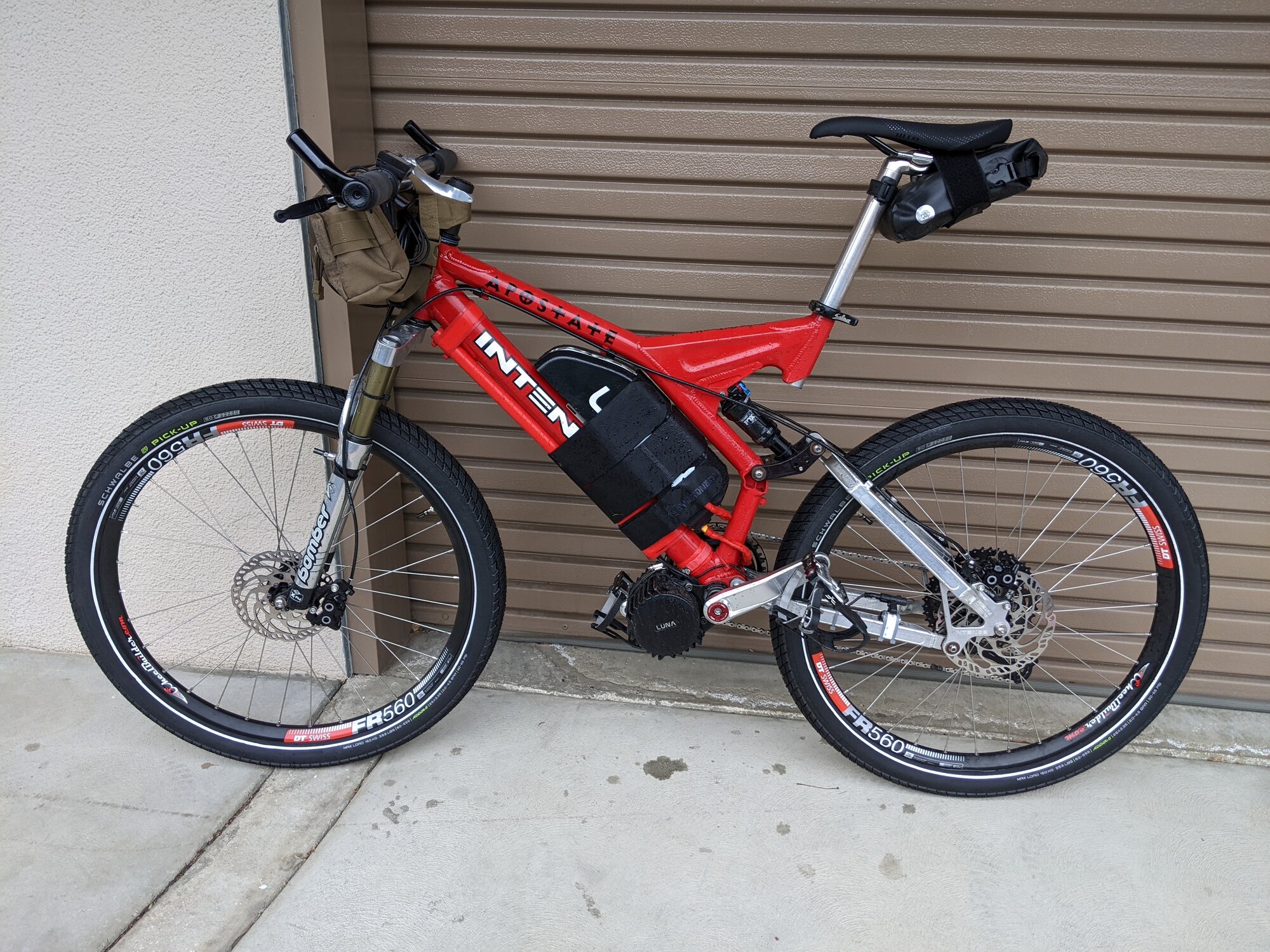

I have a number of builds where I was tempted to use a lower-power BBS02, but this exact line of reasoning won out (having the same motor across many bikes is also compelling in that I have a common set of spares). I program the PAS to run highly efficiently and if I feel a need, there's always the throttle. But more than anything I want a motor thats overbuilt and under-utilized, so I never need worry about breaking things or letting the smoke out.
My BBSHD on this bike, finished just a few days ago, set to PAS9 - the highest level - Reports a yield of 470w of assist. Thats it. If I start spinning the cranks it will pull up to 60% of that output and drop me to as low as 190w. This is a motor whose 52v battery could yield 1500w/30a sustained if it was told to via the throttle. I'm using the Version 2 settings detailed here:

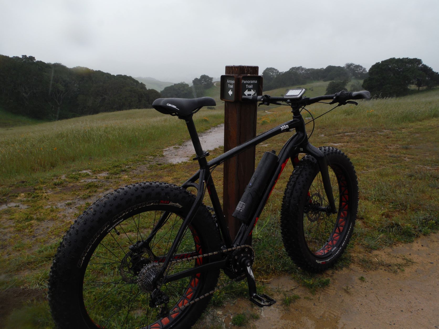

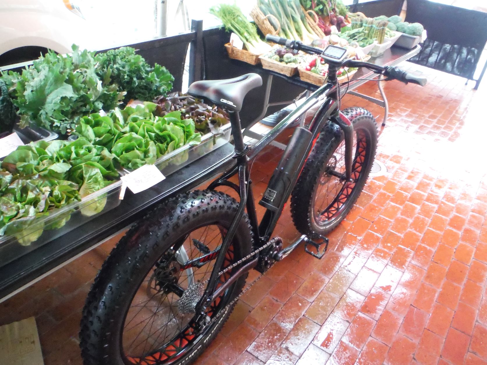

I did a BBS02 chopper recently with a throttle. Not my cup of tea but I am not the customer and he weighs 350. Today I made this one. It is an amazing climber. The bike has a 750W 90Nm torque sensor with a throttle. The throttle is limited to 20. Although the gearing is low for climbs, under pedal power I took it to 25 on a rainy flat. @m@Robertson is correct about keeping up cadence. Less is more, is more of a philosophical approach that I have been applying. It seems to be helping me improve my builds. I was in high tech. We would sell 'solutions' that were additive. Those always created more problems which then required more solutions. By dumping gears, I will take that to shifting to higher gears. That is no problem. Shifting to lower gears takes care.
