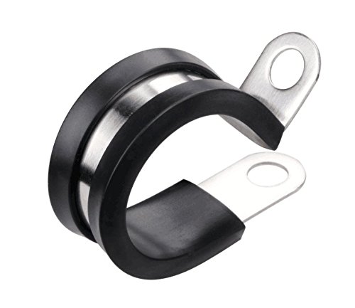

I have no braze-ons on my forks either. While hose clamps work, I prefer to use these:
They have a much "cleaner" look, come in a variety of sizes, and won't mar the paint.
Hose clamps require a separate tool, screwdriver, socket wrench, etc, which needs to be carried in case one requires adjustment or comes loose. I use socket head cap screws with the above clamps, so I can use an Allen wrench, which I always carry for other bike fasteners.

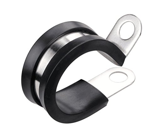

How are these sized? By legnth or clamping diameter?
I'm assuming the latter.
Correct, The measurement is the closed diameter. I usually order a size smaller than the tube diameter to allow for a tight fit.
