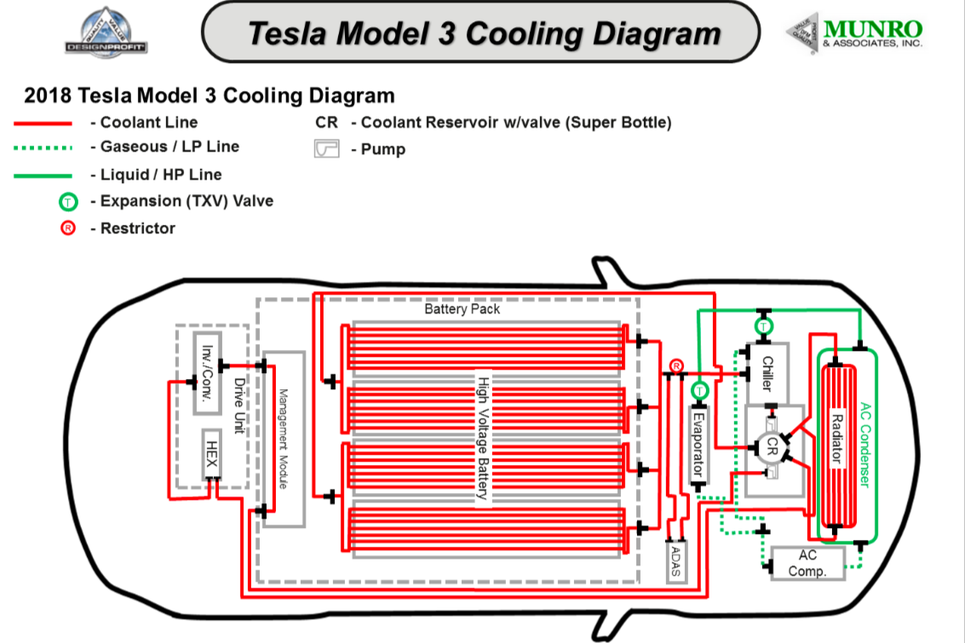

Sure... but it's also not the type of radiator you see in an ICE car. And as others have said, there are various options for cooling like air cooled or liquid cooled that may be closed systems.
EVs are more efficient in that the motors don't generate a large amount of heat like combustion engines (hence why most EVs you see have minimal or zero vented grills).
Most of the cooling is needed for the batteries which your diagram demonstrates.
That's also why some EVs have heat pumps because they can't use the engine to generate the heat needed for HVAC for the passengers.
