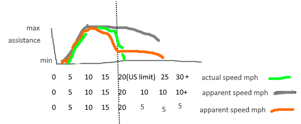

the mahle is a speed-based system measured from lockring/hub rotation, right? is the assistance binary (on/off) at the 3 different modes, or is it on a speed curve?
and if on a curve, one assumes the 10mph 'faux speed' is the point of maximum assistance (within a mode)? i.e. why not replace it with 5mph, or 19mph (or whatever the programmed limit is)?
is my thinking correct:
green - assistant ramps up, then basically shuts off at 20mph due to programmed limit
gray - assistant ramps up, continues past 20mph limit, but ramps down due to natural limitation of motor (e.g. back emf)
orange - assistant ramps up, then drops at 20mph due to the reduced assistance (imitating 5mph), until it it reaches natural limitation of motor

the speed is cut automatically at 24.9 km / h regardless of the level of assistance, the only thing that can be adjusted via the application is the maximum power of the assistance, the lower it is, the more difficult it is to reach 24 , 9 km / h especially on levels 2 and 3

assuming those parameters, why would the intercepting device not feed the false speed as 24.8kmh than something else

Good question. My stock USA model was like hitting a wall right at 19.5mph. With the tuner, it's really hard to say where the cutoff is since the drop off is so seamless.
Praised seamless drop off and long cutoff means technically nothing but a missing torque, i.e. no assisted power (or barely noticeable), therefore I found dongle totally useless after testing it (with the risk of breaking road traffic rules for barely noticeable assistance, if any). If there should be any power assist over factory speed limit, the cutoff MUST BE be clearly noticeable, IMO.
