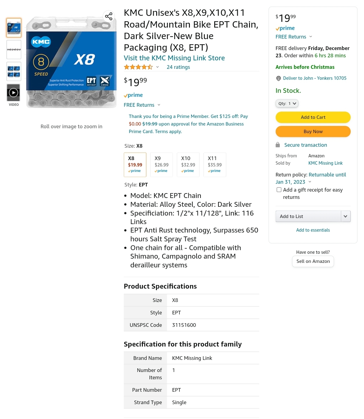

All this information and $19.99 will get you a new chain 🙃

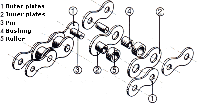

I think he was asking how you know that you've worn out the bridges on the outer plates
Oh that part is not my personal experience(that is why I used the word "seems") since my chains are still in great condition even after 4k miles(they are not even %0.2). I have seen several online blogs using wax or wax based lubes like squirt with photos of their chains. I think zerofrictioncycling was one them. You should google it up.
which one? Bushings being the main source of wear in chains? That is common knowledge.
But in my case I logged the miles and wear on my chains. I disassembled the worn chains and checked the bushing widths with a digital caliper so I can also confirm it first hand.
You can also google and find more info...
That is what I was wondering. I value first hand info more than google. What part of the chain is termed the 'bridge'?
