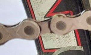

i meant middle part of the outer plate when I used the term bridge. KMC also use the term for that area.

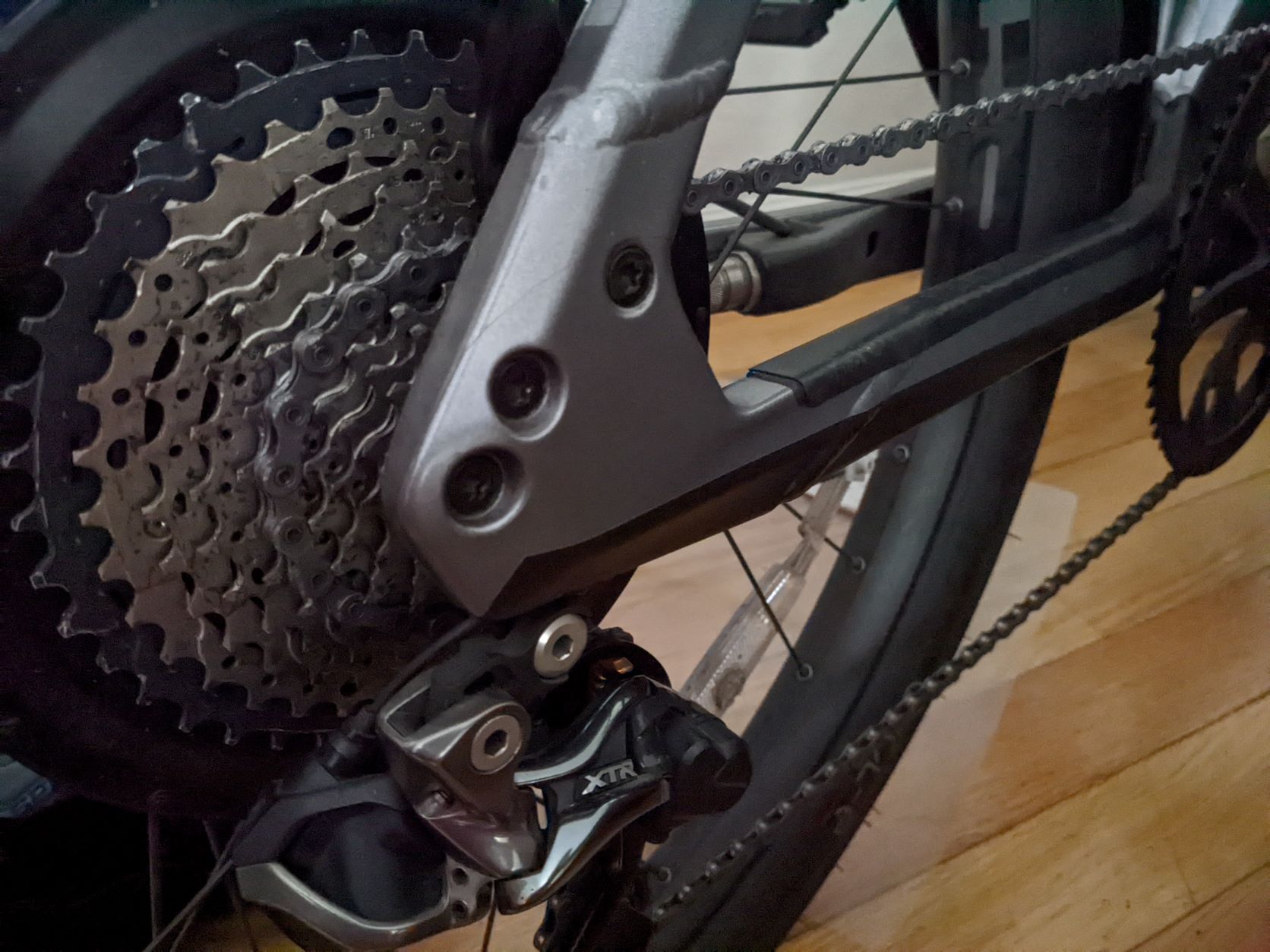

my latest 11s e11 has 2700 miles and counting on it
This is interesting, what bike is this one on, how do you ride it?

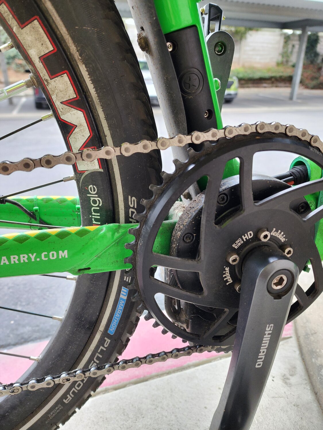

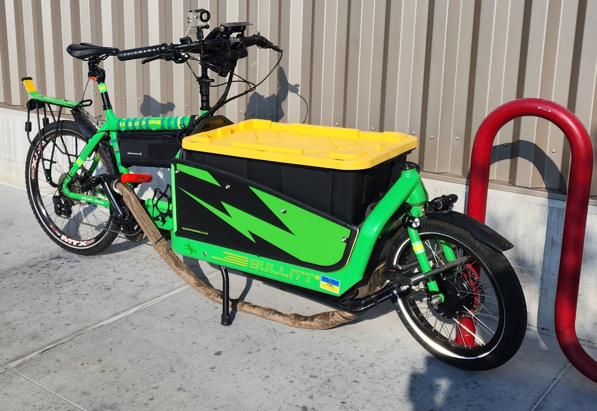

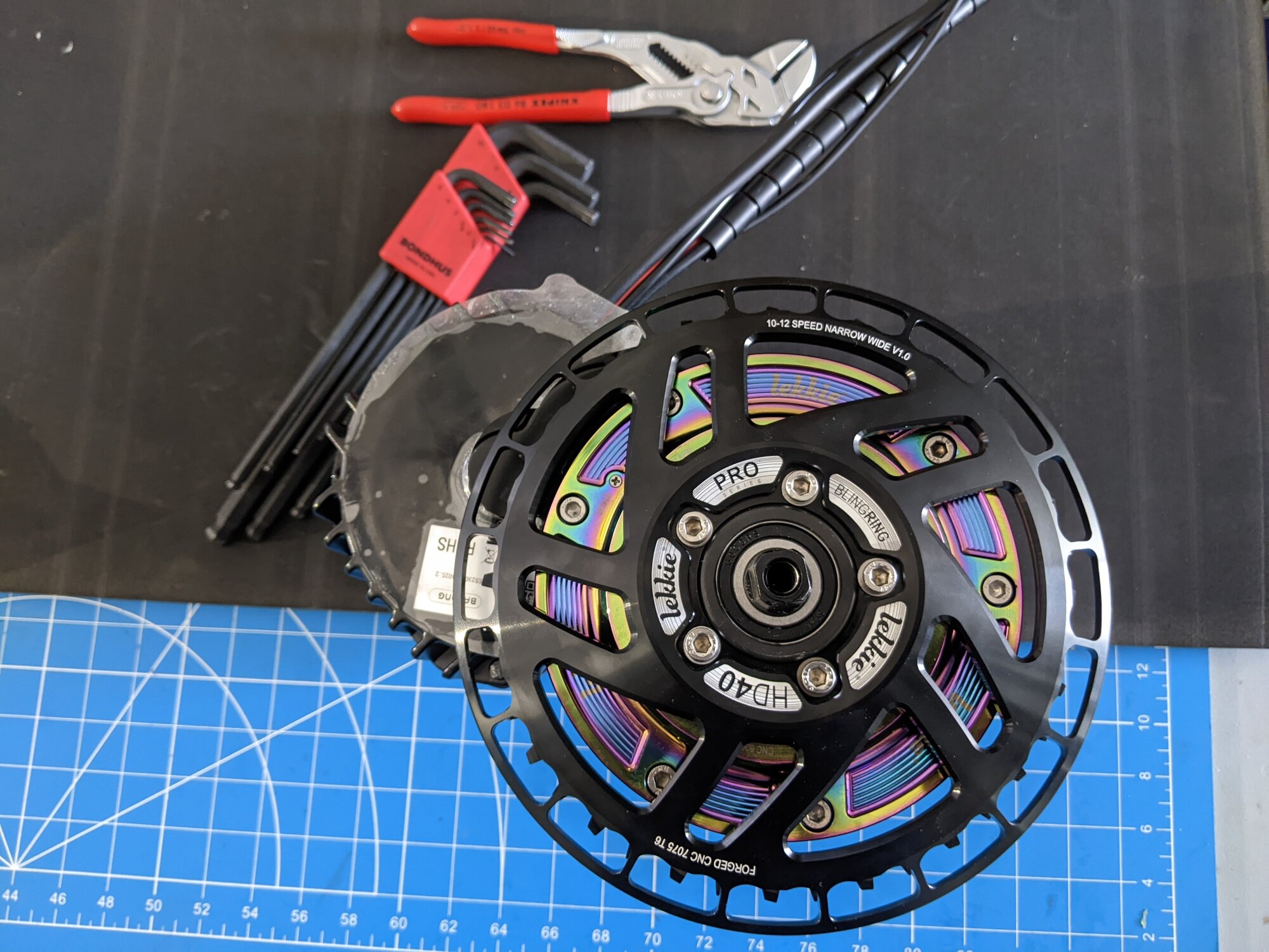

This one. 52T chainring and completely flat terrain. 11s SRAM GX. DT 350 hub w/24T Hybrid ratchet and steel cassette body upgrades. Steel Sunrace cluster.
And as for riding it: the answer is hard, considering it is a cargo bike that is commonly loaded with 100 lbs of stuff (and this bike is also my daily commuter). I went to Costco last weekend and the cargo box was filled, as were the 30L panniers on the back.
Now... that bike is cheating, because it is 2wd and I have developed a hardware-based approach to 2wd that completely eliminates the shock to the drivetrain that is typical of a 1500w mid drive. Detailed at the same web site linked above. Look in the 2wd section of the Table of Contents. A more fair comparison would be how my BFD is set up right now:

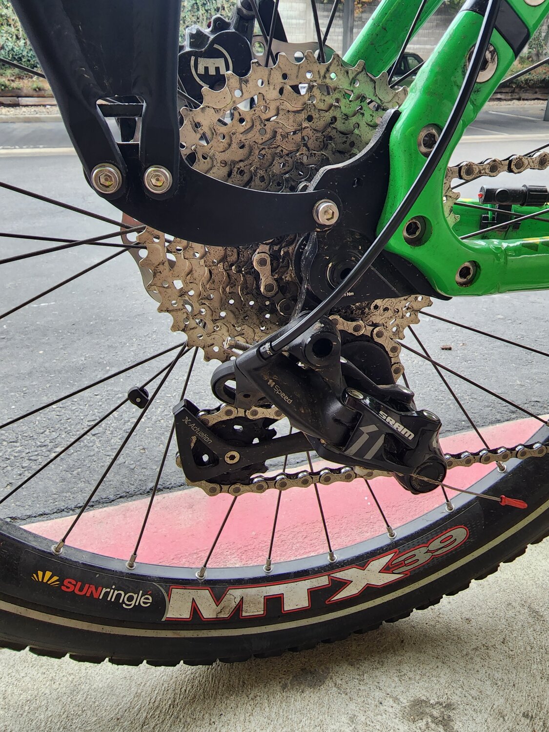

36T front chainring, 11-46T rear cluster (not steel this time), SRAM 11s NX. Same DT hub and upgrades. c/f rims rated to 200kg each, which is a good thing as I have had those bags fully loaded to bring the bike up to 565 lbs total system weight, which is a VERY hairy thing to balance. Unloaded this bike will climb walls. I would have to check the odo to be sure but I believe its all-original drivetrain is at about 1600 miles.

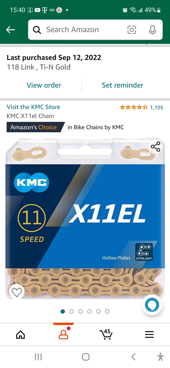

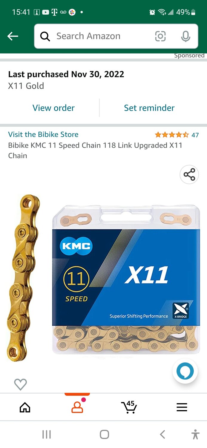

I just installed new KMC gold plated chain. The one with slotted links only lasted about two months or less than 500 miles I kept it well lubed with synthetic engine oil, one with out slots is currently on my commuter bike with Bafang 620.
I will replace it at 1000 miles of dust and mud trails riding.

Even on your chain that you have lubed and wiped actually have oozing.
Give it a rest. I already noted the front hub issue. And you know that but are trying to throw it on the fire anyway. And you also know I was entirely up-front about the dual motors on that bike, and I put up one other 'traditional' single-mid-motor bike that sport the same results. I've got more of course but it doesn't make a lot of sense to beat this poor horse any further.
Your zooming in on the chain (shadows and all) that we all know has been riding around the street for a couple weeks confirms something else for the audience: You're obsessed with this topic well beyond what is practical, useful or good for the equipment. Thats a clean and largely dry bike chain, and if you have to zoom in to find specks on it, that explains where your head is at. Which is fine for you, but its not good advice for the general bike-riding public.
