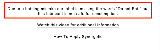

Has anyone tried this one? If I was riding in snow and salt I may have given it a try. https://silca.cc/products/synergetic-wet-lube
Their wax is highly regarded hence this wet lube may also be good.
