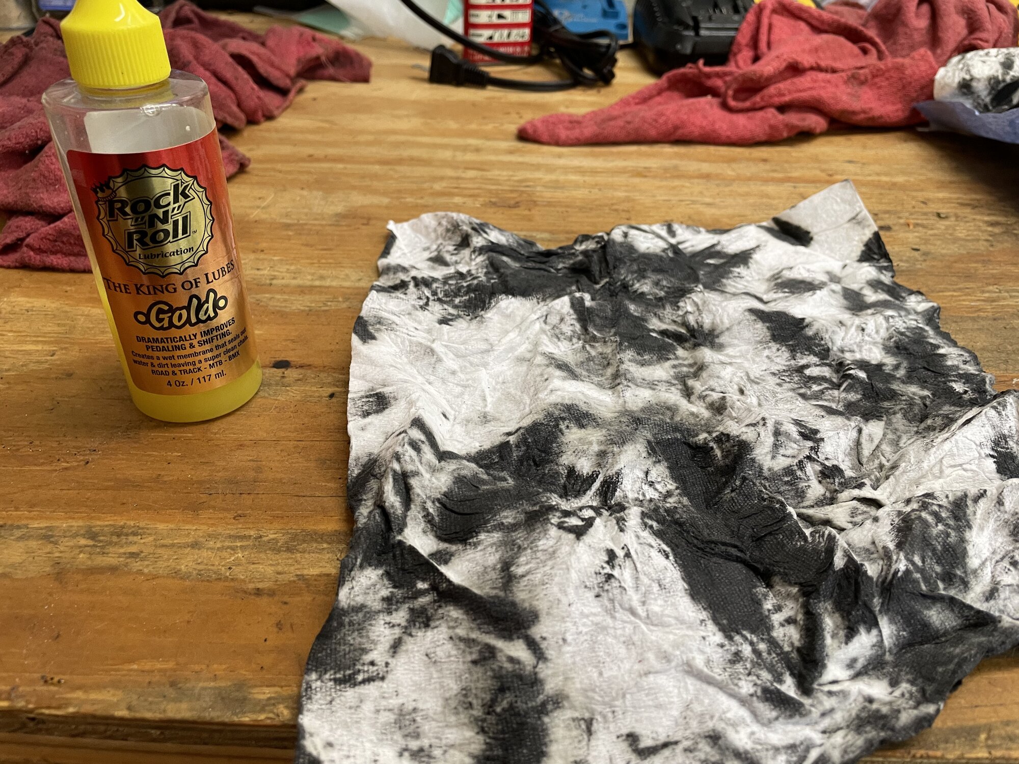

I just did my chain today. This is what the rag looked like when I was done. I lube the chain every 100 miles to.

I’m coming up on 3500 miles on my original chain and so far it’s good, but I think my wear gauge is 0.75%. I think what you see on the white rag is dirt and wear from the chain.
