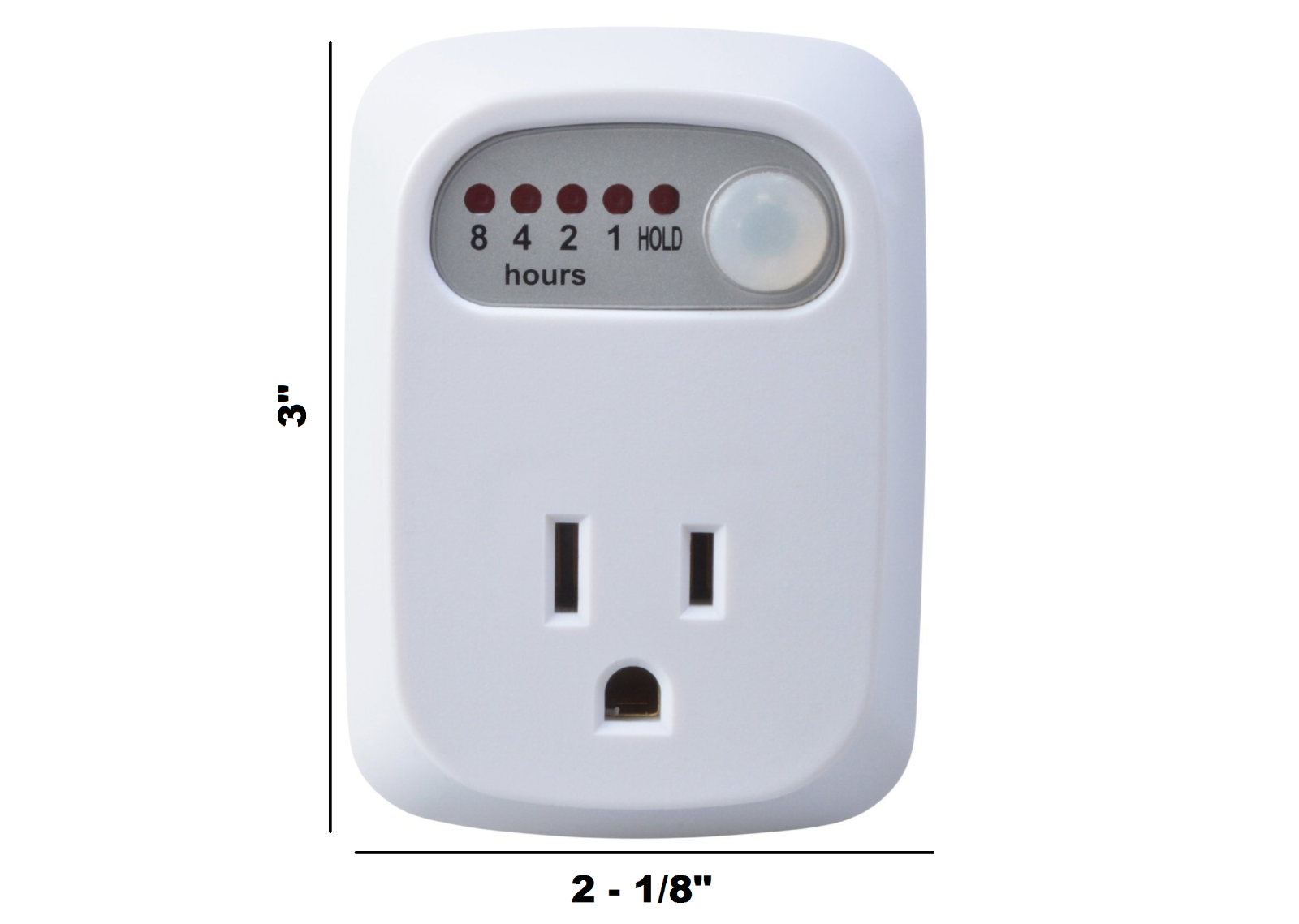

Agreed, What I do to minimize risk is, place a $4, battery operated, smoke alarm, directly above the battery, (on the wall 2 feet from the ceiling as per detector instructions), with an electrical fire extinguasher near by. I also charge away from flamable objects and use a outlet timer to automaticlly shut off the "2 amp" charger.
My chargers are plugged into one of these.
When get home from a ride, I recharge for the approximate amount of time I know will get my batteries back up to around 75%. In the morning, if I know I am going to ride a good distance, I top off the battery about 2 hours before hand.
They are a good $12 insurance policy.
Simple Touch the Original Auto ShutOff Safety Countdown Outlet, Multi Setting
These are the type I use:
