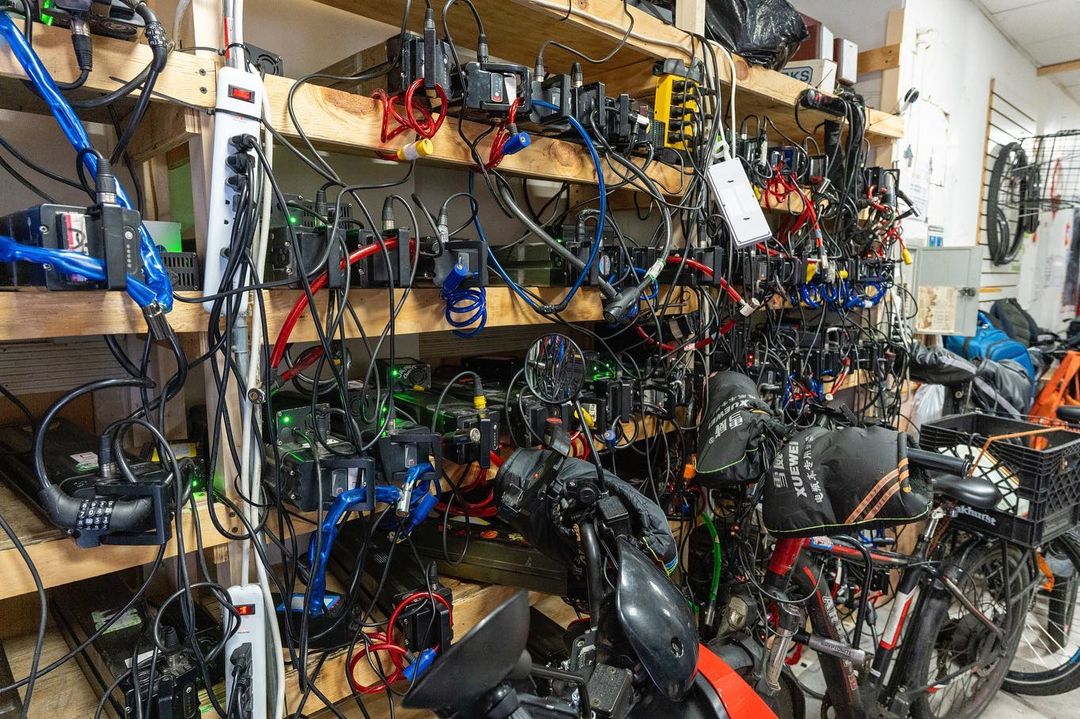

E-Bike Batteries Are Catching on Fire Way Too Often And delivery workers are demanding safe charging stations.

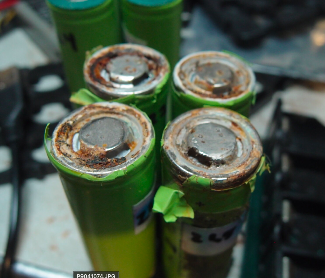

First, for readers, I apologize for repeating my comments but this is critical. Moisture intrusion and especially salt is not a problem IF we take care.

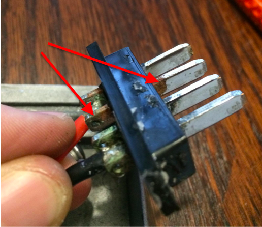

Both Luna and the other shop I worked for in California sold a lot of batteries to customers in coastal California. While working for both I saw the corrosion that occurred on the connection between the base and the case. The slotted connections were the worse, but moisture buildup from never removing the battery will definitely become a problem. Add some salt and you have the perfect storm.

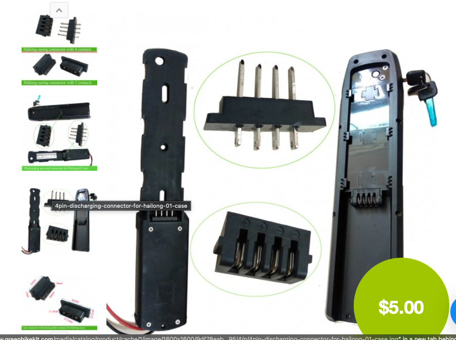

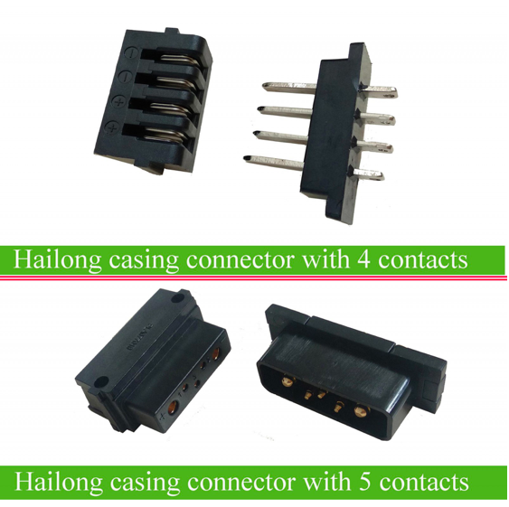

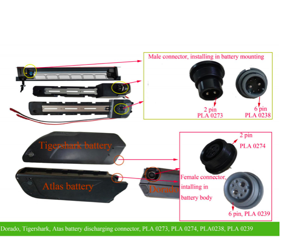

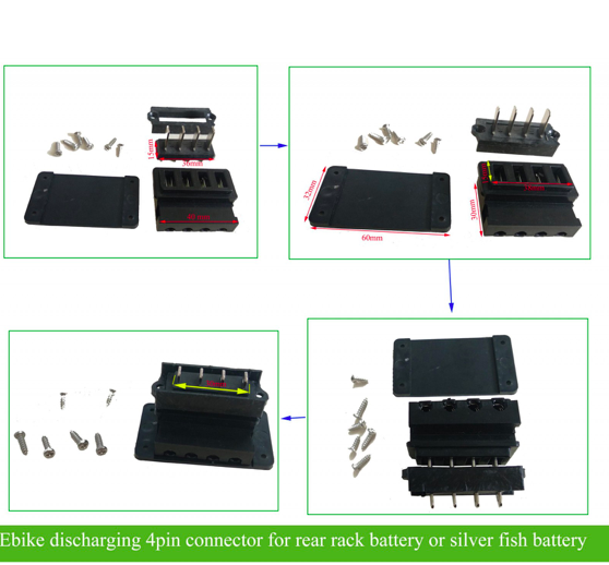

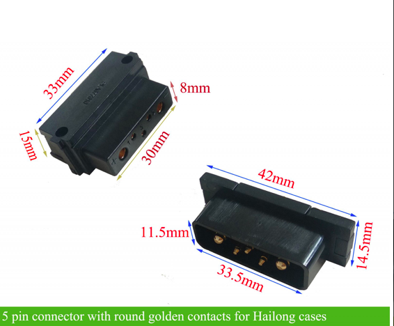

There are all sorts of posts showing us how to replace the connction blades on Hailong packs and eventually Hailong improved things with pin typed connections
HOWEVER this is easily solved by retine maintenace abd a good protctive coating. ACF50 and Boeshiled will both completely protect connections and electical/electronic components. DO occassionally pull any battery from it's mount and teat the connections. All will be perfect.

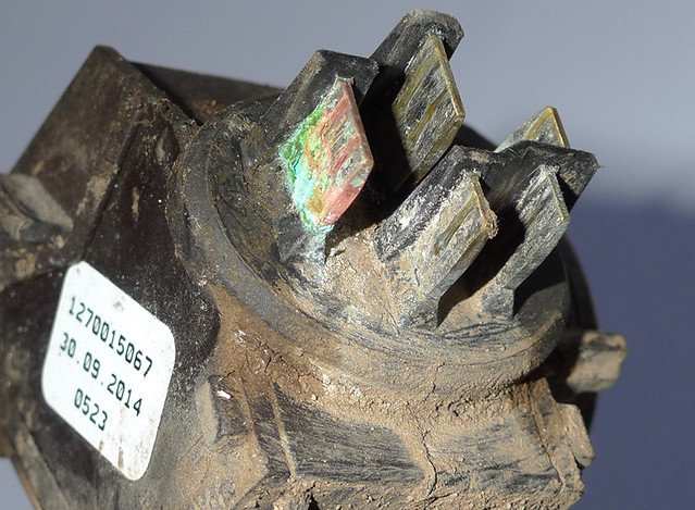

BOSCH terminal corrosion.

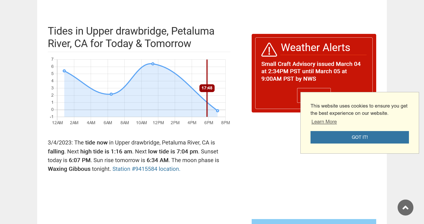

Any dielectric grease will work just fine. Didn't think Petaluma was close enough to the sea for much salt corrosion. I used to live nearby in Santa Rosa and never noticed the sea air.
Ah, we live on a tidal slue connected to the San Francisco Bay and Golden Gate, to the tidal salty Pacific Ocean. The main bike paths go along it. Unprotected here, bikes rust. We have seagulls everyday. In storms I feed them dog food. They follow me and beg. Santa Rosa was associated with the anti-Union position. Landlocked and pro Confederate during the Civil War, to unite us all and to move past slavery, SR was and is behind the times.

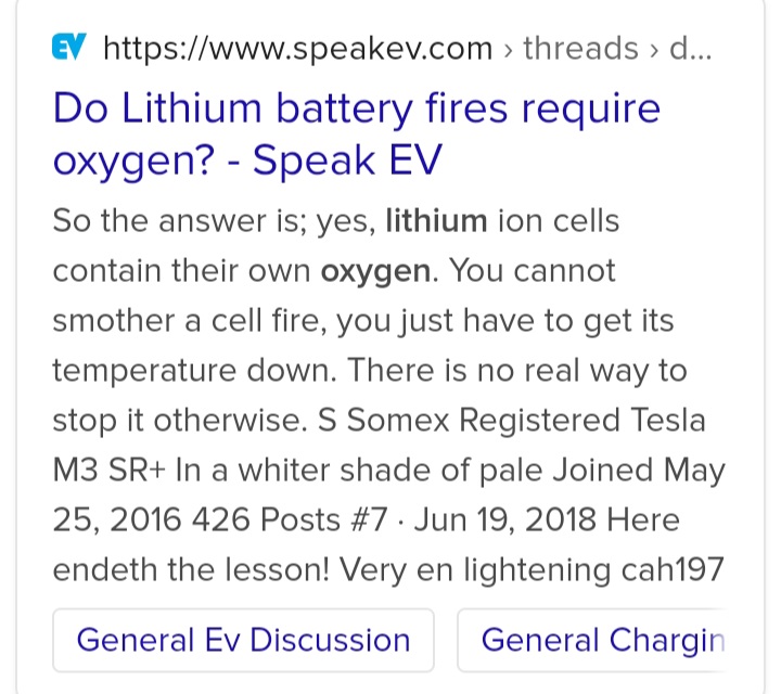

Lithium battery fires cannot be smothered.
A battery bag may make it worse by containing the heat until the bag burns up.
