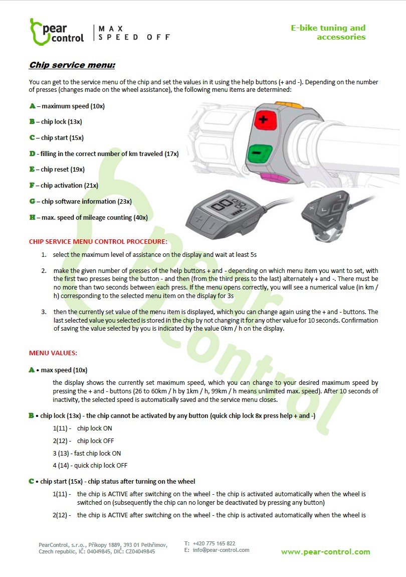

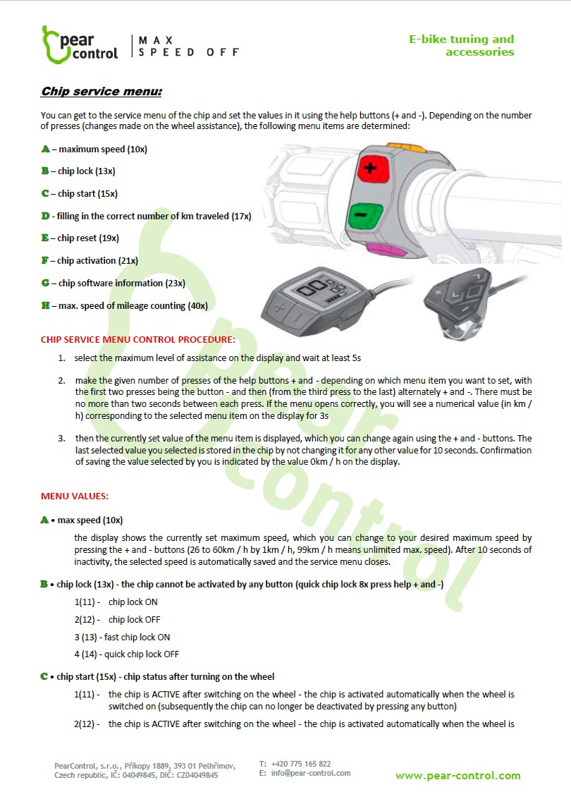

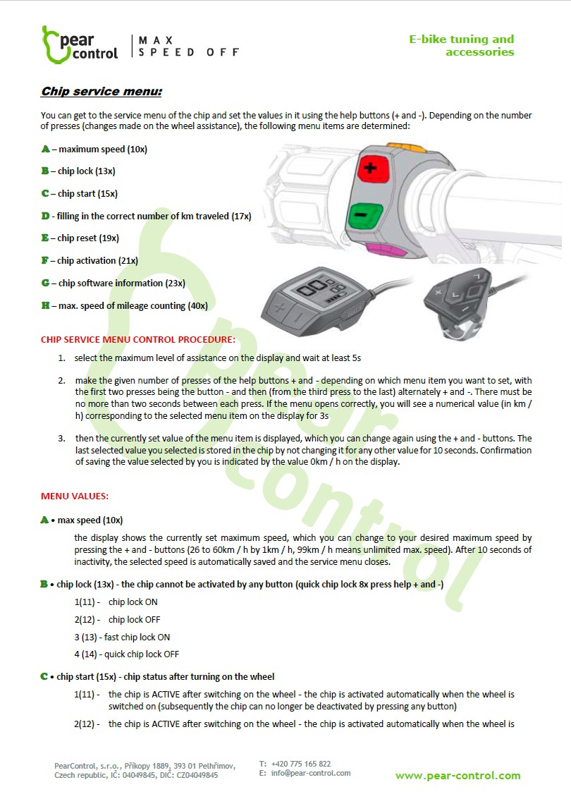

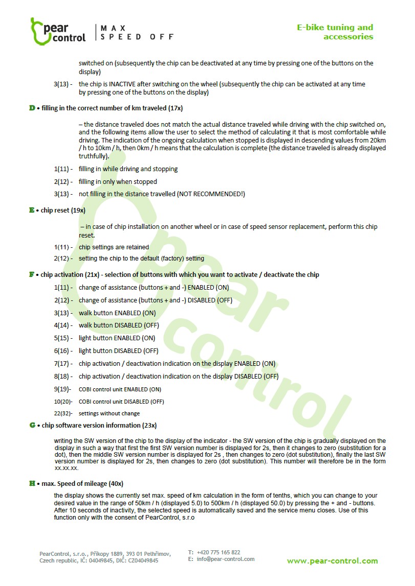

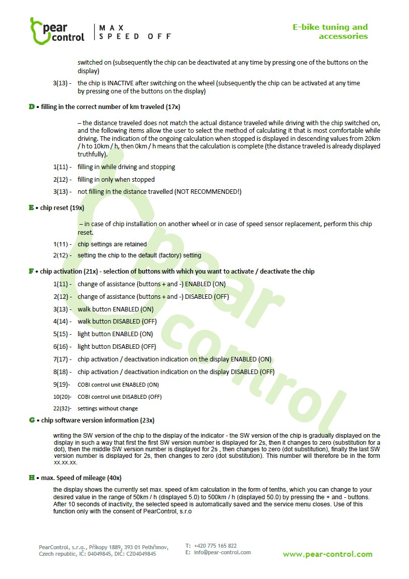

Hi, I've now installed the peartune, but cannot figure out how to activate it! Could you tell me what buttons you press to do this? Thanks!
Press the "Walk" button for 1 second. You should note the TCD will temporarily display "speed" 5.6 to indicate it is enabled, if the display reads 0.0 then it is not enabled. I set mine as enabled by default when turning on the TCD. If you need to change any of the defaults, the correct sequence of button pressing is vital and not as intuitive as the instructions suggest, let me know if you need any help with that!
View attachment 144272View attachment 144273
Thanks for your quick reply! I did press the walk button for 1 second, and it just kept saying 0. But after playing around with it for about 30 minutes, and watching their YouTube video, I found out that I can press F1 (the top button that controls the light), and then I can press +-+-+-+-+- (10 times). Then the TCD displays a 10, which I assume is the maximum speed setting, and I was able to change the number there to 45 kmh. At least, I think I changed it, I wasn't able to actually test ride it as we have a storm here right now.

So I rode the bike into work today. I still couldn't figure out how to enable/disable the PearTune, but I did press the light button, and then +/- 10 times, and confirmed that my maximum speed was set to 45 kmh. As soon as I got onto a section with a longish stretch (no stops or turns), I could immediately tell that the PearTune was working. WOW, what a difference this makes! Normally, I would hit 32 kmh (the legal maximum speed in Canada) and I could feel the motor cut out, and turn on/off intermittently which was annoying. But now, I can continue cycling with assist and I reached speeds of about 44 kmh on flat sections.
I live in Vancouver and have massive hills that I cycle up and down every day. When going down hills I used to easily be able to hit 50 kmh (without the PearTune), but the ride would begin to feel a bit unstable around 40-45 kmh or so. But I think this is because I wasn't pedaling fully, and applying brakes etc. When I got up to 44 kmh today, pedaling on the flats, the bike felt completely stable.
This is a game changer for sure. I still find the PearTune control difficult to deal with, but I'm hoping once it will become easier once I hear back from Katerina (to confirm how things work) and once I get used to using it.

Hi, thanks again for your advice. I commuted into work this morning, and just wanted to follow up.
So when I first started up my bike this morning, I couldn't get the walk button to do anything except to change the assist level, and start the bike in walk mode. So, I pressed the light button, then +/- 10 times, and confirmed that the max speed was set to 45 kmh. I wasn't sure if the PearTune was enabled or disabled, so I just started my commute. Once I hit the first straight section, I could tell immediately that the chip was enabled. I could attain speeds above 32 kmh with ease, and my motor would no longer cut out at 32 kmh (and give that annoying on/off feeling above 32 kmh). It was a glorious ride.
When I got into the office, I played around with the walk button a bit. Now, I can sometimes get it to display a 9 when I press it for one second. It doesn't happen every time. I'm not sure if it's because it's cycling from on to off, which would show a 0 (and I might interpret it as not working). The bike starts into walk mode whenever I get it to show a 9, which is kind of annoying.
I think it's going to take me a bit of time to grow accustomed to how the PearTune control works. But at least it's installed, and seems to be working correctly so far.
Thank you again for your help, I would have no idea how to do this without your advice! It would be very useful to have some written instructions for how to control the PearTune on the 2022 Turbo Vado 5.0. I will try to write those up once I figure this thing out. :)
