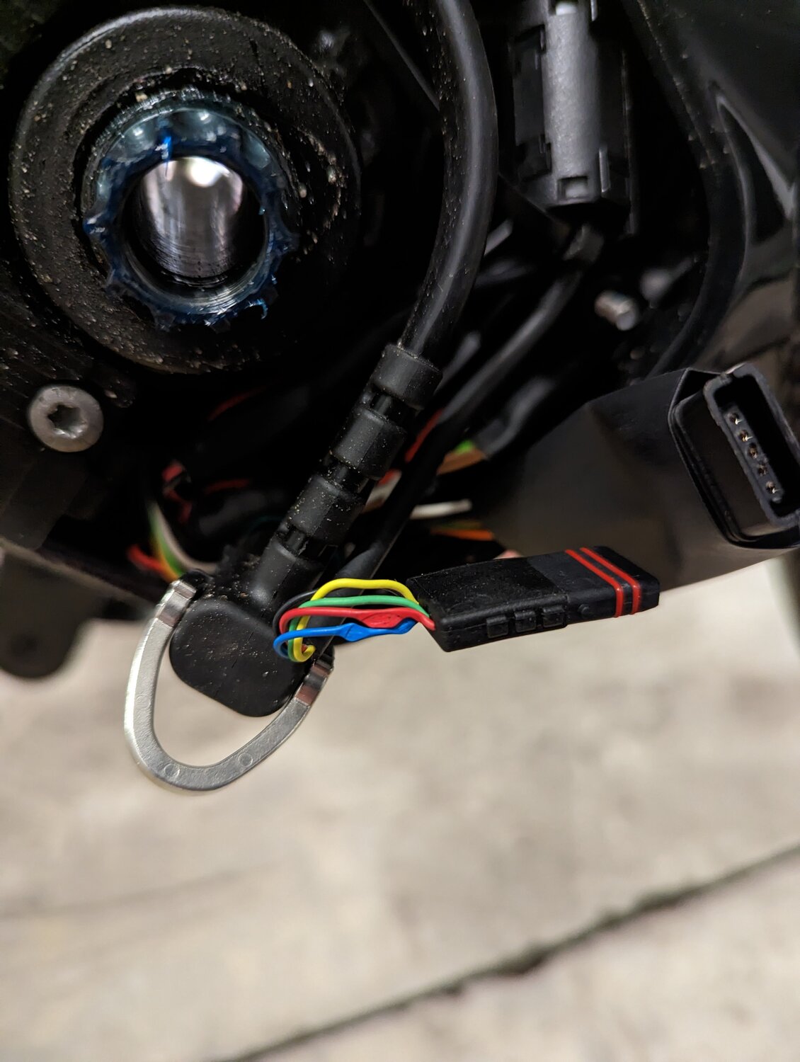

So I opened up the motor housing today in order to put some shrink tubing over the large connectors, since I didn't have the appropriate size when I first installed. While doing so, I noticed that two of the wires (blue and red) from the original bike connector had been squished, creating a couple small holes in the plastic insulation and exposing a tiny bit of wire on each (see attached photo). This must have happened when I reinstalled the cover last time, which is weird because I'm usually a very careful person. I guess it could have been pre-existing too (I donrecall a rarad error a few months ago, before I installed the PearTune), although it seems even more doubtful that this would happen at the Specialized factory.
Anyway, I installed some heat shrink tubing over the original Specialized connector and about 4" up the wire. Because the tubing had to be large enough to fit over the connector, it didn't seal tight against the wire at the other end, but I'm hoping the 4" is long enough to keep the water from the damaged wires. I then covered both connectors with the larger heat shrink tube. I gave it a test ride, and everything seemed to work, so we'll see how it fares in the rain next time. (I live in Vancouver, so commute in the rain for about half of the year.)
I am guessing that if these wires were damaged, that could be where the water was entering the wiring, causing the radar error. Does anyone know if the blue and red wires are for the radar? If I continue having problems, I suppose the next step is to have that wiring harness replaced. Hopefully I can buy just that since harness, and not a complete set of all harnesses for the bike.
I'll update this thread after a few test rides in the rain, in case it helps anyone in the future.

It just occurred to me that I could probably seal up the tiny holes in the wires using a hot glue gun. If I have any check radar errors in the rain going forward, I may open it up and give that a shot before replacing the wiring harness.
Edit: my brother who is a mechanic said to just put some RTV over the holes then cover it in shrink tube, and it will be fine. So I'll give that a shot if I have any troubles. :)
