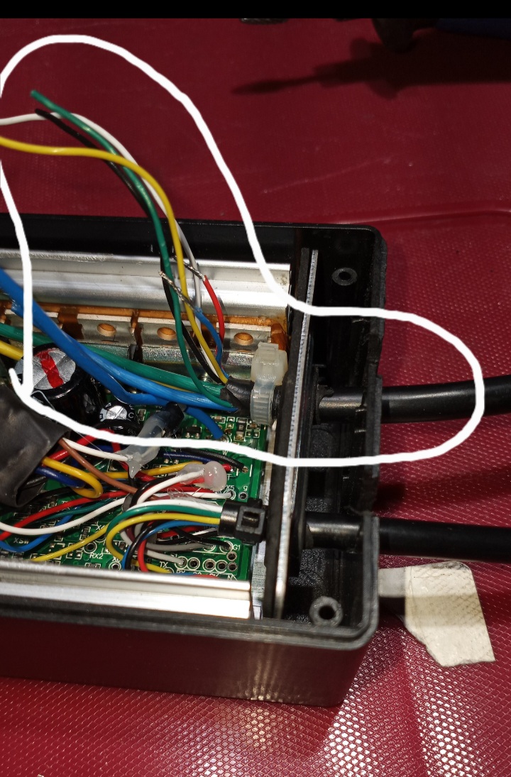

thats the cadence sensor. it would be pointless to have more than one you just found wheel rotations. the accuracy is in setting the right wheel circumference.My speed sensor is tucked away nicely and protected inside my hub motor.
It's the white wire in the motor cable.
A single magnet on a spoke gives you one pulse per rotation.
I've got 6 magnetic pulses per revolution,.. way more accurate and immediate.
