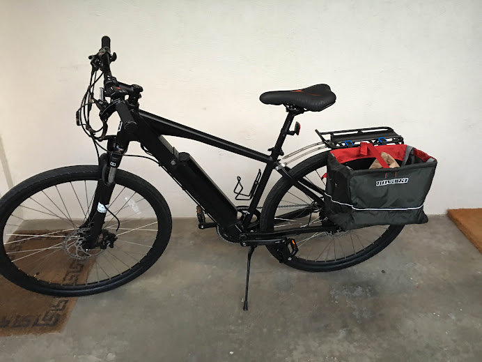

Looks like my front brake caliper has leaked. Not sure why and not sure if it needs to be replaced. It didn't leak while the pads were on the bike, I removed them to see if there were any wear lines from it rubbing. Pads were out of the caliper and I squeezed on the front brake lever and some oil came out.
Maybe it's a piston seal leak? I have no idea.
Any ideas or tips?
Any ideas or tips?
With most all hydraulic disc brake systems if you squeeze the lever with the pads not inserted, it may leak and even pop the pistons out completely. Please contact us directly so we can help you with the service of the brake caliper. [email protected]
