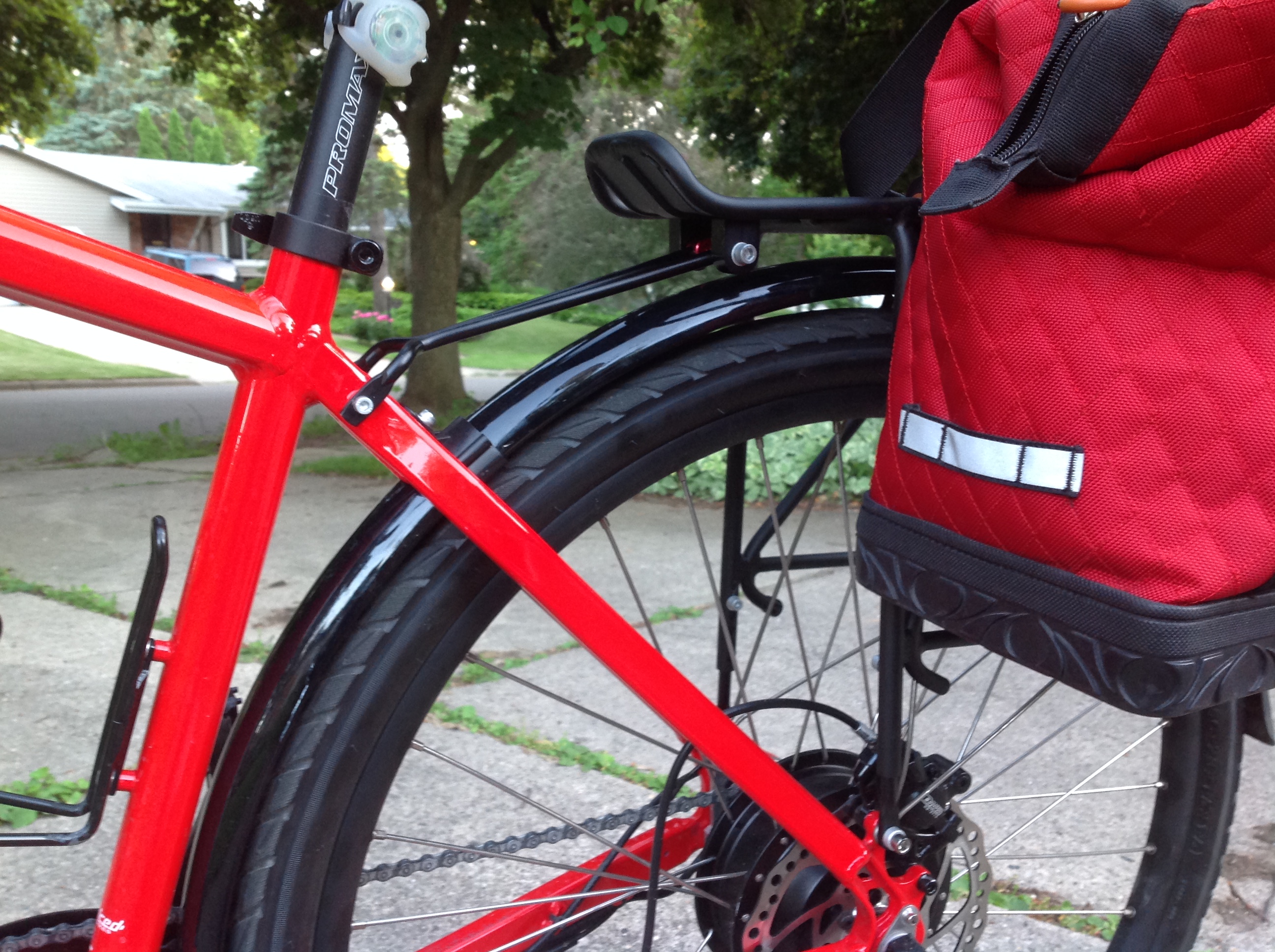

3) Biggest complaint by far: Difficulty with mountable rack. I'm about $130 in the whole with the topeka rack and paneer set up unless I can figure something out. (I know its on the Tora's radar though)
All in all I am ultra pleased with the bike and love it. Even after having ridden several bikes from larger companies at the bike expo. I am hoping to see other people start tagging these bikes on instagram. I have been using #crosscurrent along with #juicedbikes (the cross current hashtag brings up all sorts of non bike cross current images)
Here is a picture of my rack, axiom, and panniers.

Rindy,
Which rack do you have on the CC? Any mods to make it fit?
The drive side has a open mounting point & from the picture it looks like one of the disc brake mounting holes was used for the rack & fenders. I don't think I would do this myself, but it probably wouldn't affect the brake.
