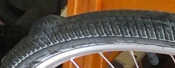

Have Schwalbe tires on both ebikes. This is after 700 miles on a non-ebike, 700c Kenda Kourier w/Kevlar Shield. Tire was always ridden smack in the middle of psi limits. Can't quickly patch this, this is call for a ride fix!

I think it's better to use e-rated tires. Just an opinion...
You better get a body float seat post if your going to ride that tire!

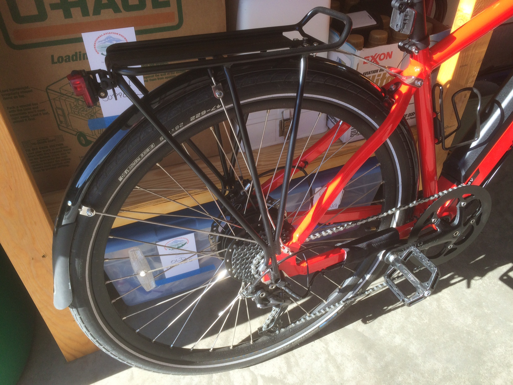

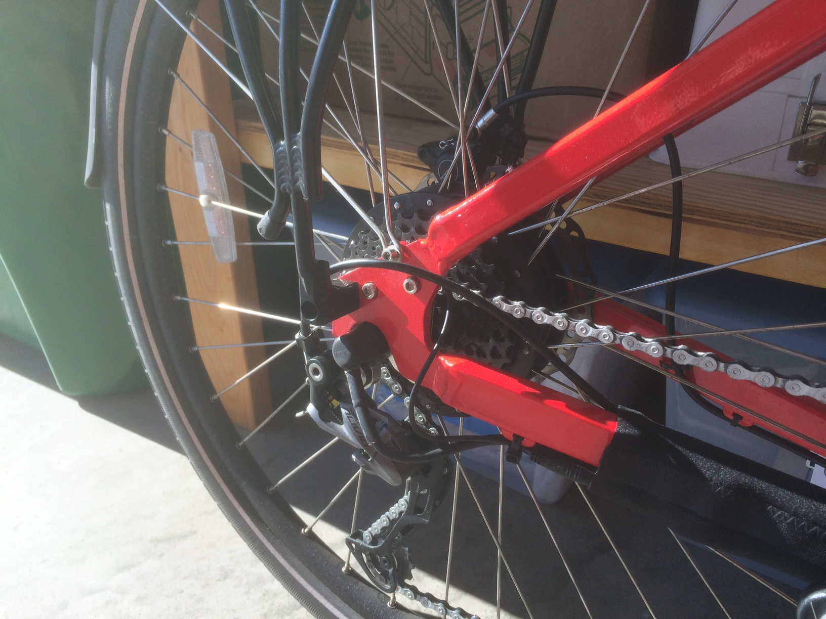

With Rich or Robbie's help, I had a Topeak rack mounted so I could use it with their MTX Trunkbag. They tapped the rear dropout to receive the machine screw fasteners.

@EriderM the dropout was drilled and then tapped for fasteners suitable for the rack. If you have a decent tap set, it should be a straightforward task once you bend & arrange the rack's 4 mounting points to suit. FWIW - and I'll bet you already know this - the Topeak gear seems to be first class. Patricia looked at those two panniers, once I unzipped and revealed them, and said I'd be going to the store a LOT! :p
