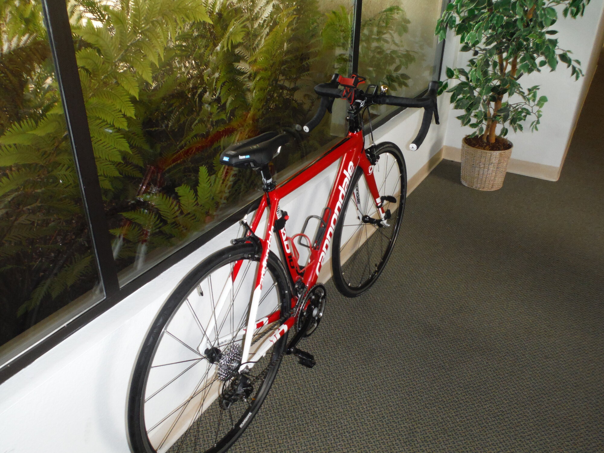

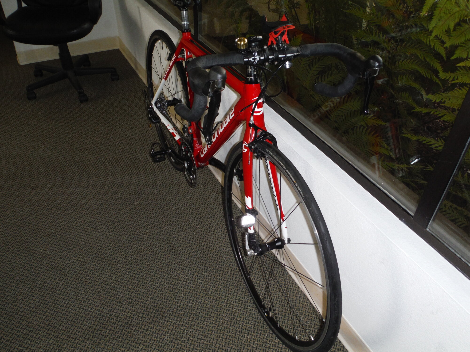

If you are going for light weight, look at cannondale & orbea built bikes.

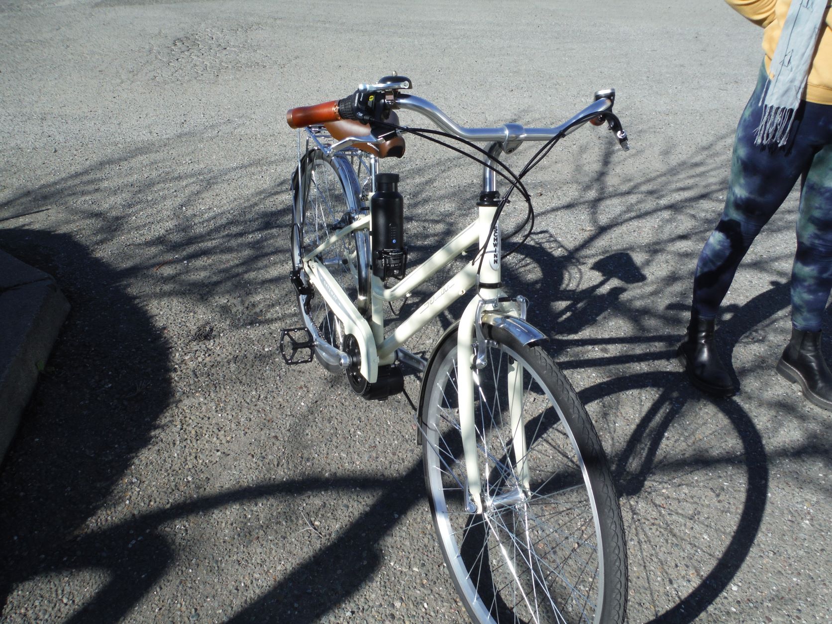

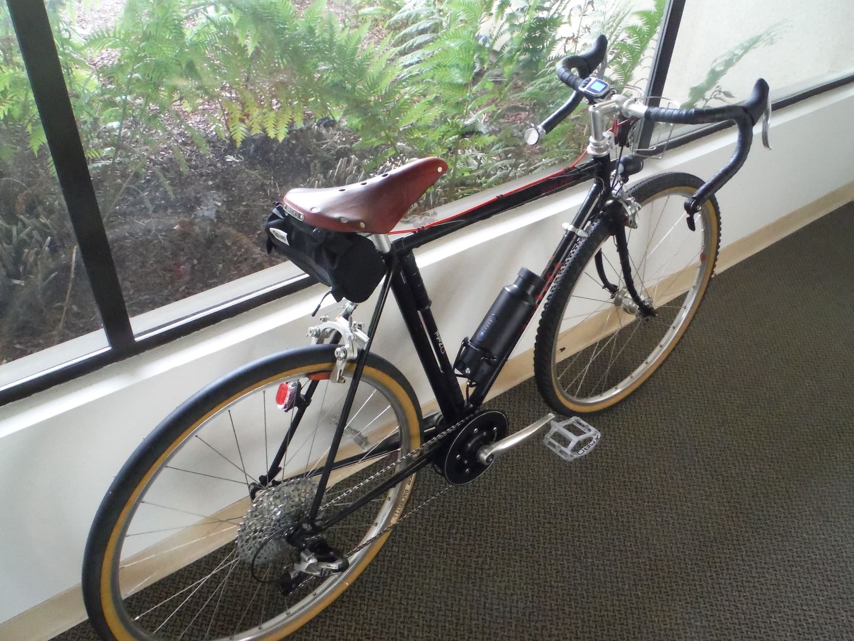

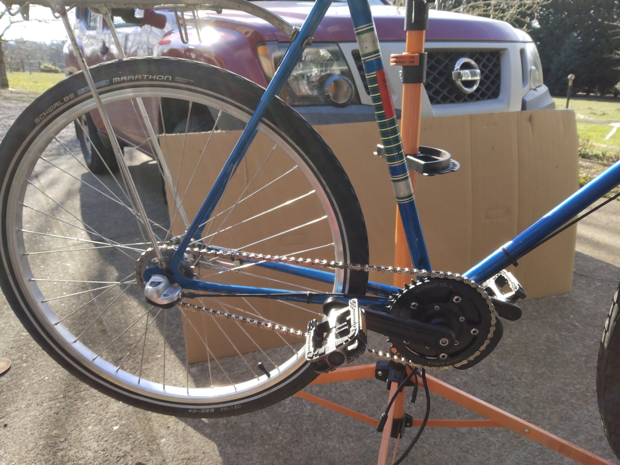

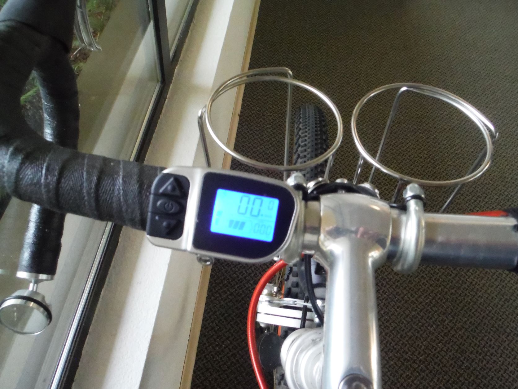

I've built the bike left with a geared hub kit on the front. You want a lot of weight on the front if you're going to do that. The kit allows me to buy any brand battery, not a patented single source battery that came from the motor vendor. I paid $630 for the 840 wh battery that is now 3 1/2 years old. I paid $221 for motor controller brake handles pas pickup display. That one wore out in ~4500 miles. I got my money's worth. Installation materials were $80 more. I bought a replacement $740 geared hub motor before the failure, and had it on in two afternoons.
People whine about the messiness of external wires tie-wrapped to the frame. I find having 18" of extra wire looped up on the fork, I don't have to unwire the motor to replace a tube or tire. Just cut a tie wrap & replace it. I find dorman crimp terminals from the auto supply to be 100% reliable, compared to some patented battery contacts on invisible press in batteries.
