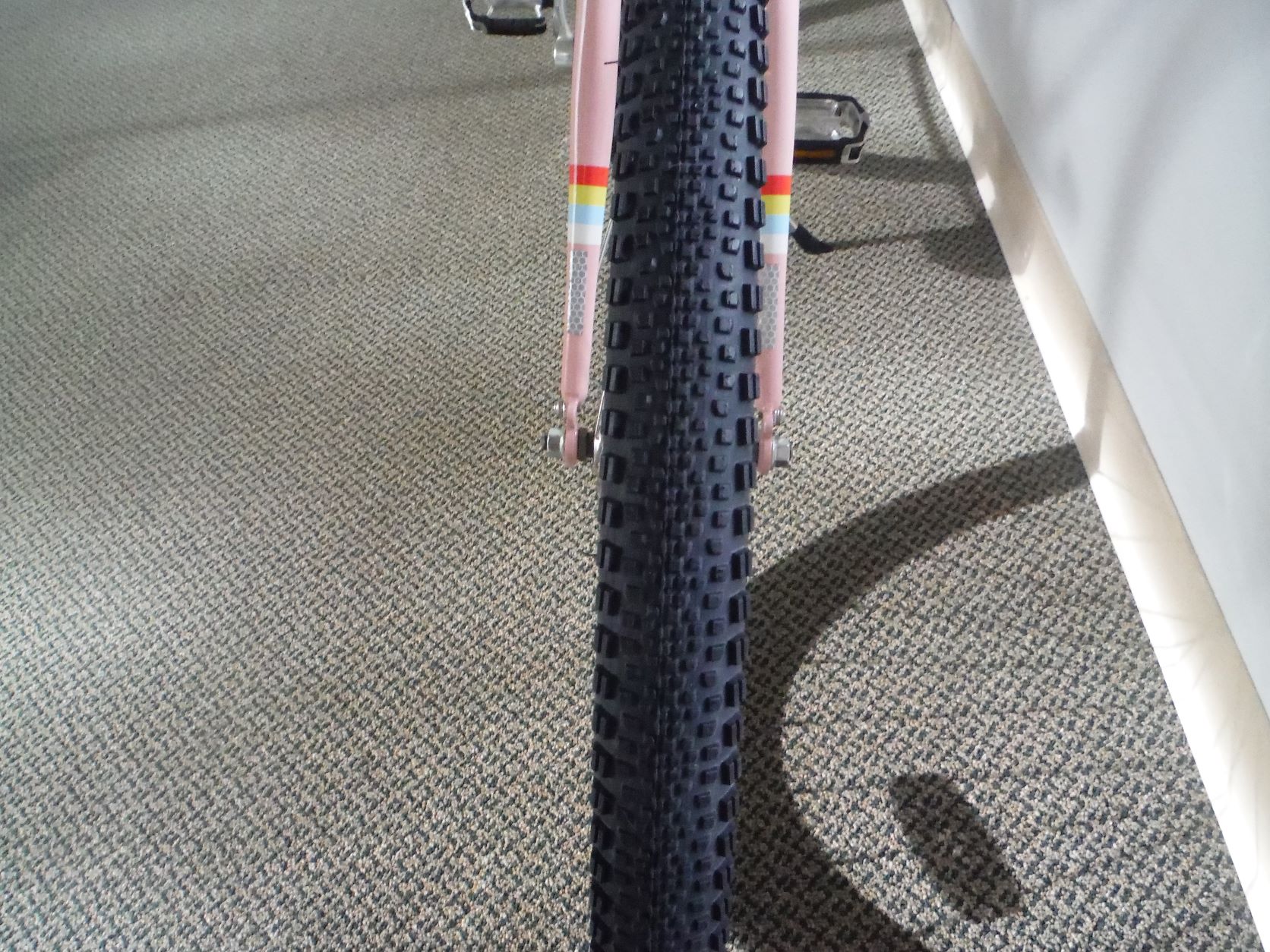

The primary advantage of a mid-drive is that the force is multiplied by the gears. That is not true with hub-drives. At least run it through a three speed to see the benefits. IMO a motorized fixie sounds like a death trap. Just measure your tire clearance. Use both height and width. I am digging some WTB Riddlers. They barley fit one of my bikes at 38mm. It may be that your bike is a little too narrow to make a good conversion. I do not like going under 32. Just go with the largest that will safely fit the rim, frame and brakes.

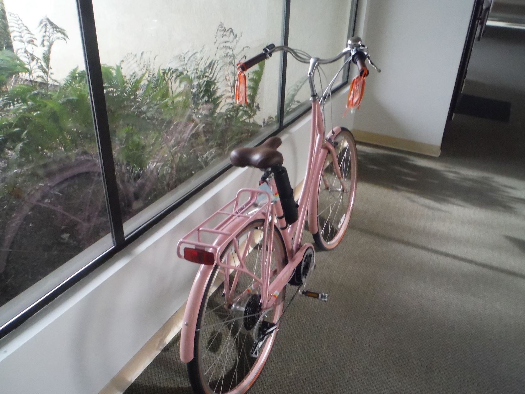

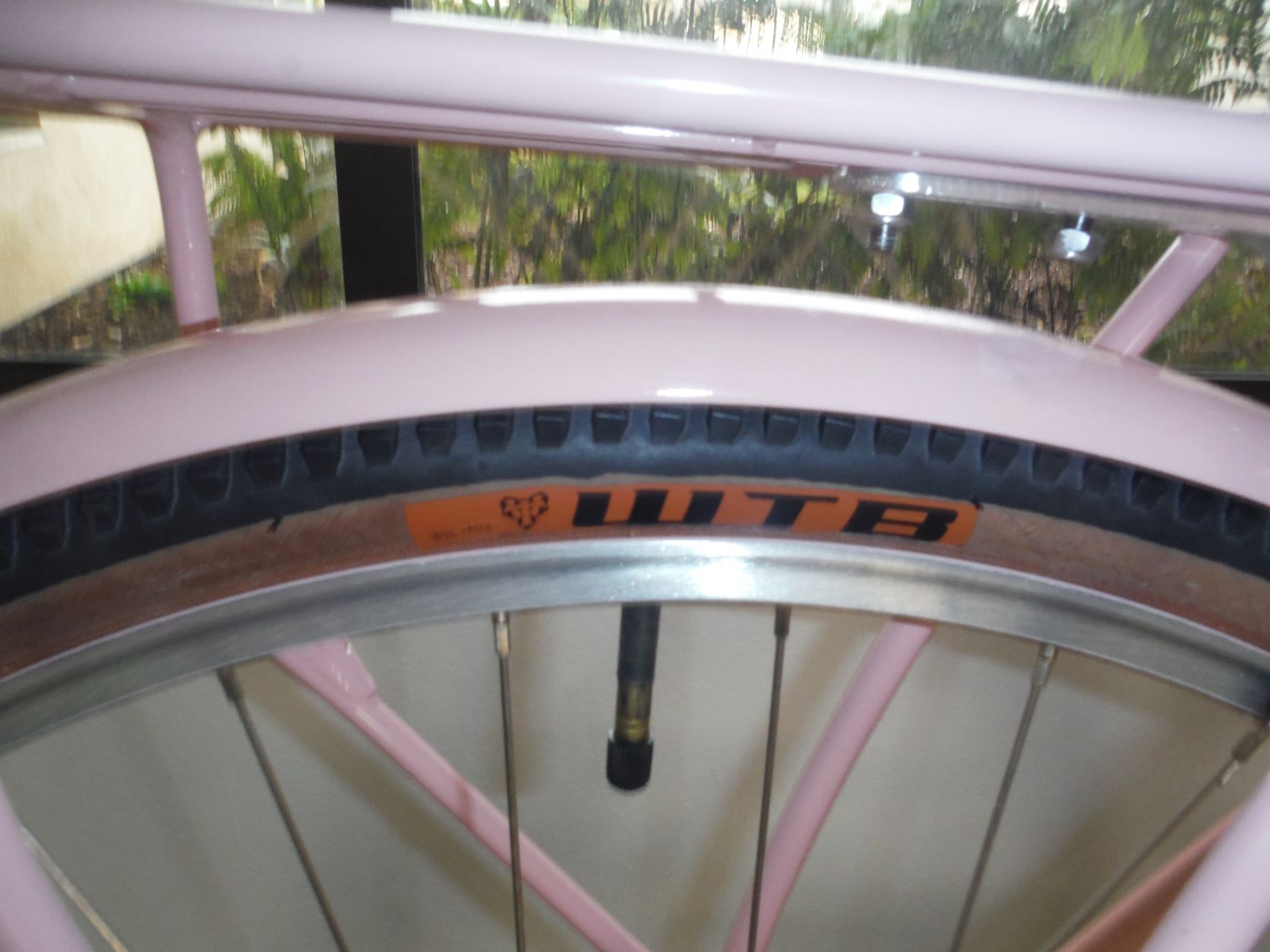

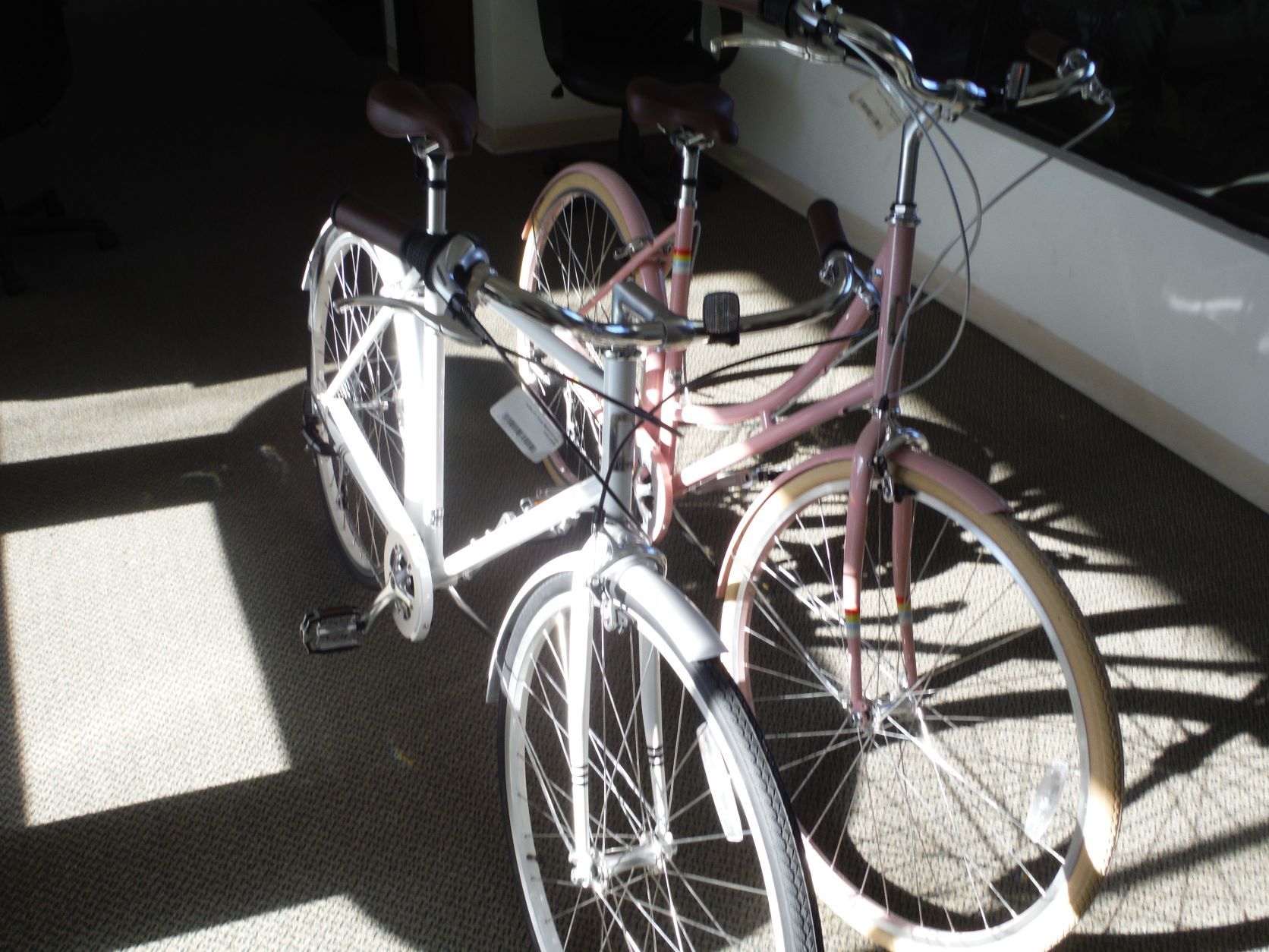

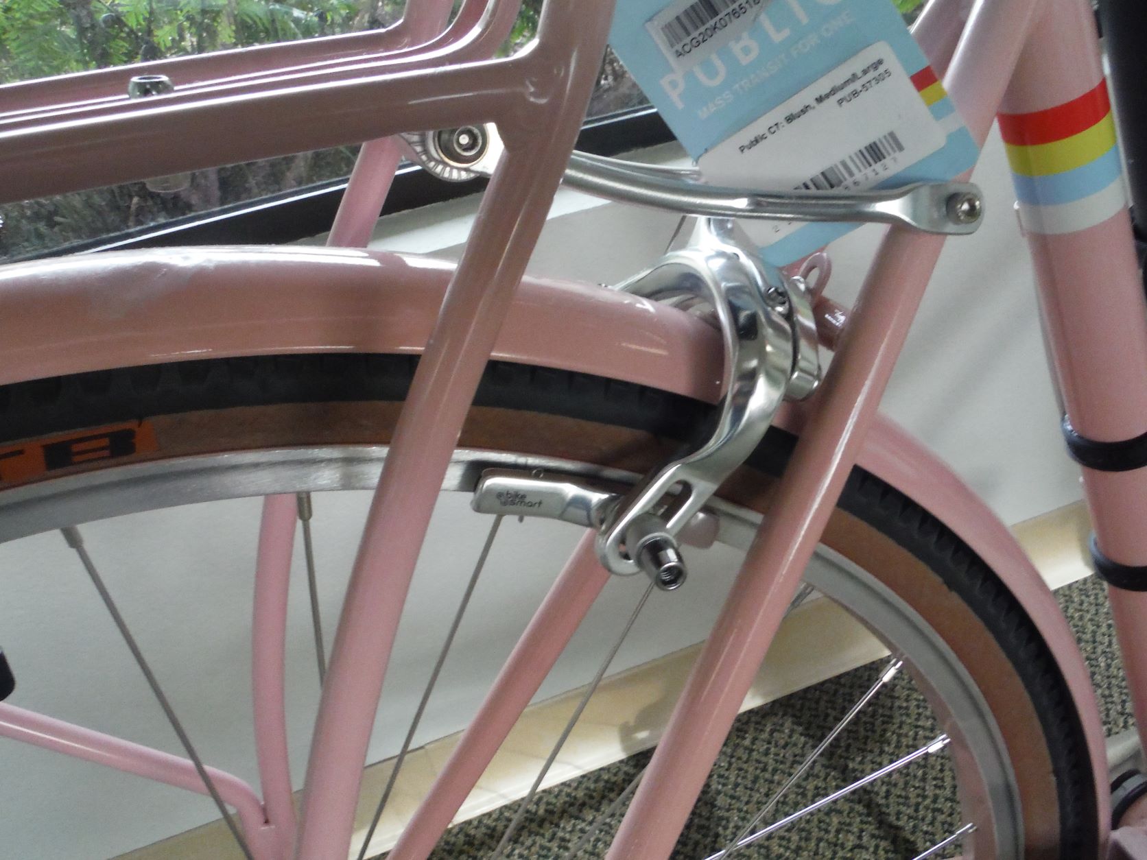

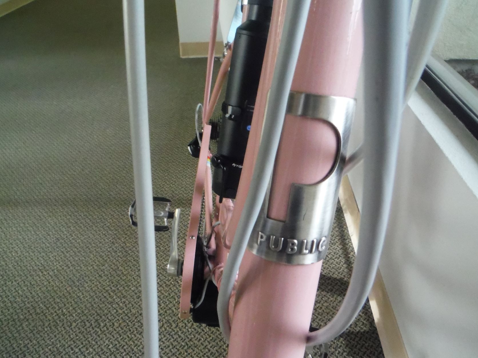

Take a look at moustache bars. You will need to put a caliper on yours to find the diameter before you order. Others have already seen this but I finished the pink bike yesterday. It feels nothing like a scooter. It just amplifies your input. It took a while for some parts to arrive for the build.
You're builds are so clean!
And this is more of a personal petpeeve than criticism... But we got to think of away to eliminate the plastic ties around the downtube... They're like salt in my eyes 🥵
Maybe some smaller version of this... attached with some 3M VHB Tape?
