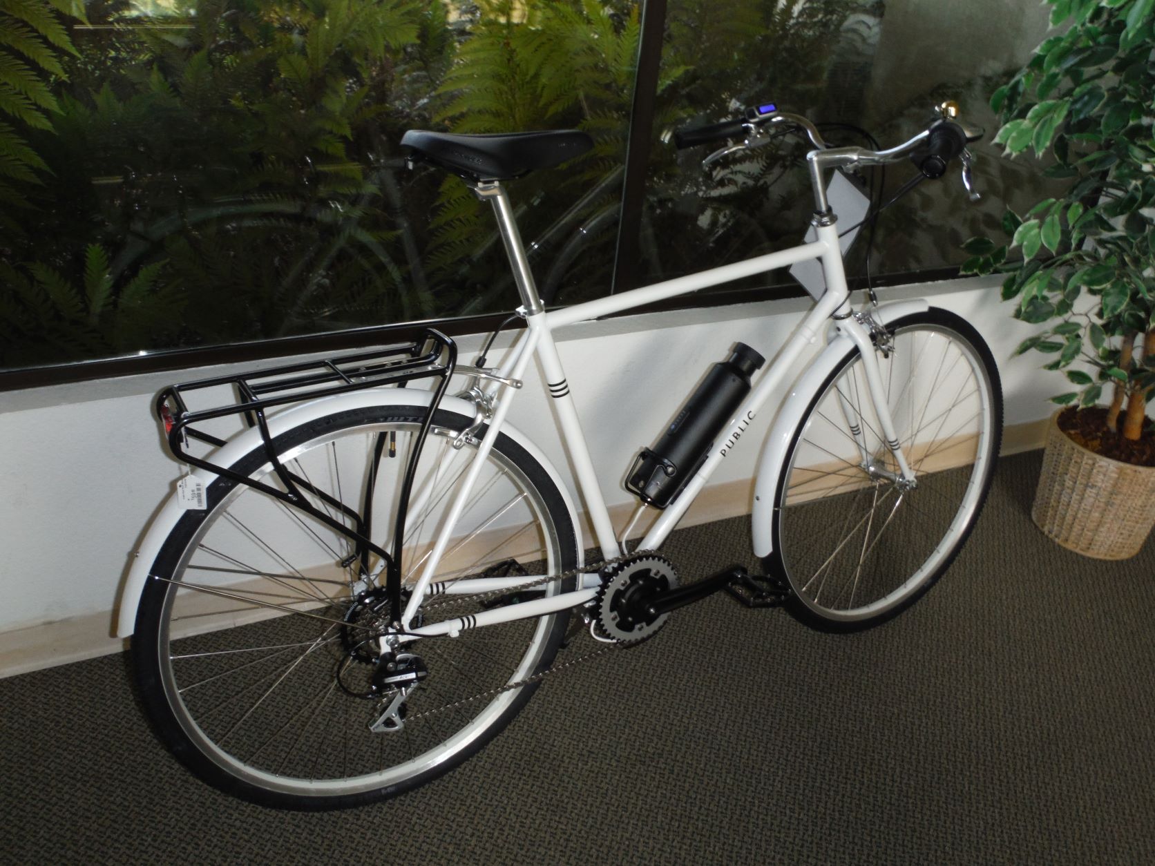

If I already told this story, please forgive me. I guy who is an anesthesiologist and has an electric cargo bike I made for him brought in an old bike for me to fix up. When I added everything up, it would cost $695 to repair but would still be an old bike with old bearings... So I immediately went down to the LBS and purchased two bikes with all new parts for $549 each. The parts are worth more than the bikes. Here is one of them, converted.

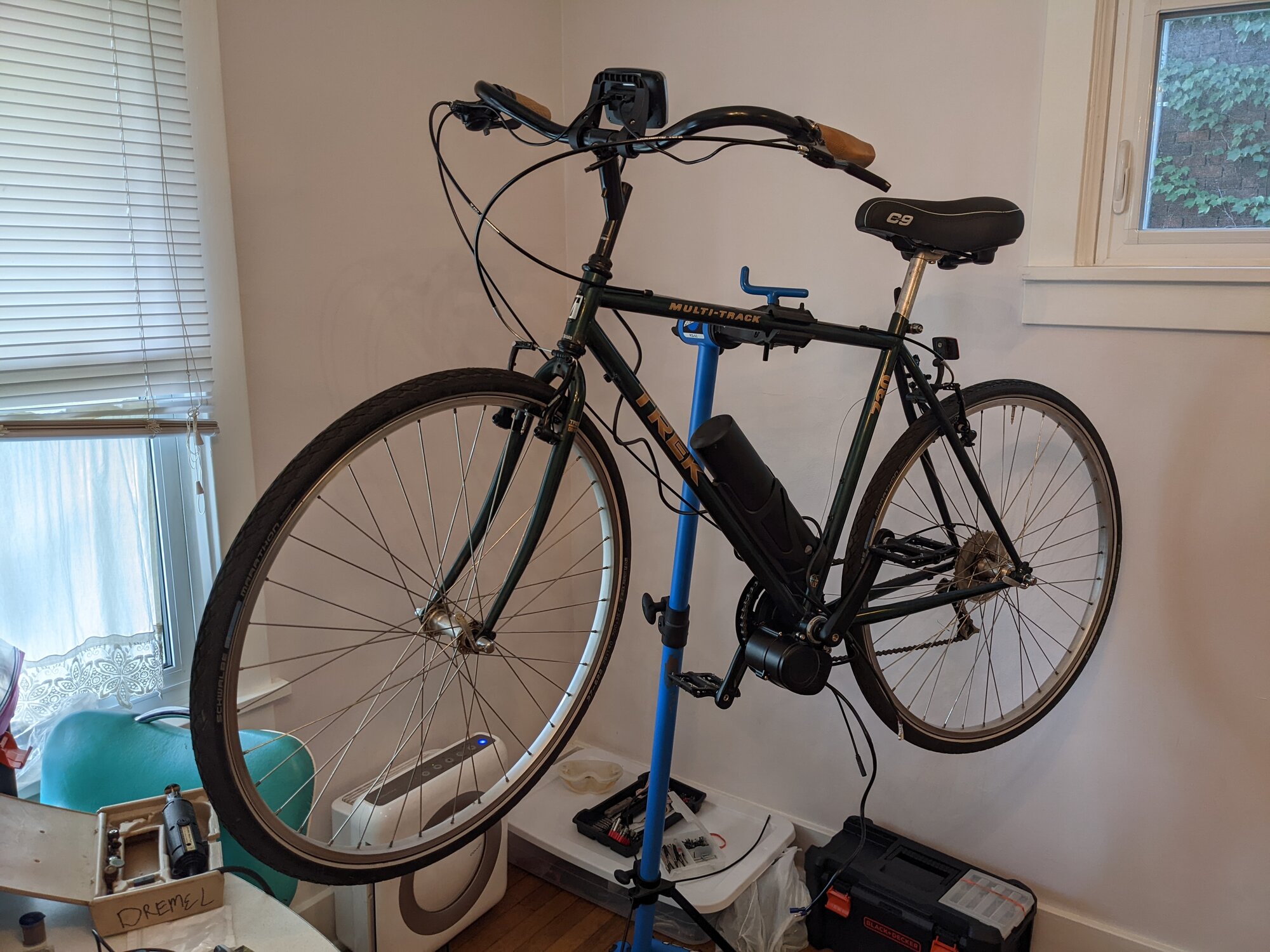

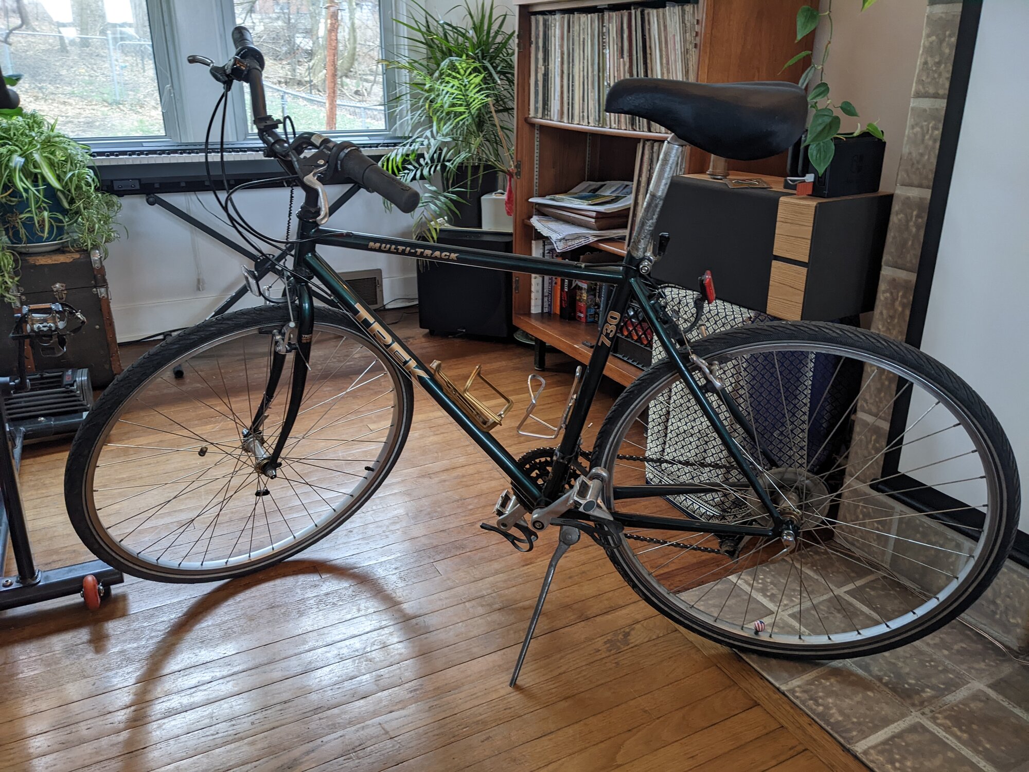

Thank you @PedalUma and everyone else on here for your help! I ended up buying a $100 Trek Multitrack from the 90s. Most all components had to be replaced. I knocked my head against the wall a lot learning about bicycle repair and the mechanics but it's so rewarding now I have my bike rolling with the Tongsheng TSDZ2 kit! Here it is:

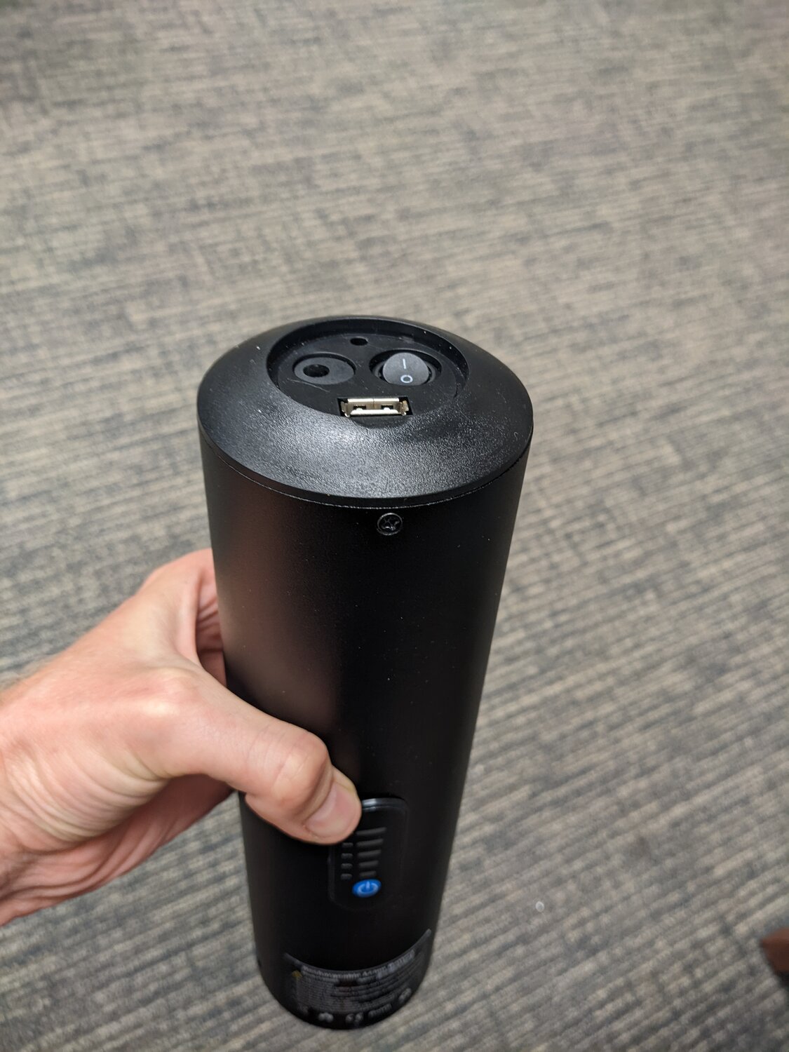

Unfortunately the battery cover came off the battery when I was riding. @PedalUma may I ask what you use for the top of your batteries to make them look like a legit water bottle? Do you just take a water bottle cap off of a different bottle and fit it?
Thanks again!
You will need to cover that as soon as you can. You do not want any exposure to being bumped, dust or water. I recommend going to your local bike shop an purchasing a plastic water bottle. Saw the entire top portion of the bottle off including the threads. Use automotive gasket sealant to attach the portion with threads to the top of your battery. After several hours of curing, then thread on the cap. This will protect the vitals, give access, wile providing with the look you are after. It is so wonderfully subversive that you can now blow past that braggart from E. Europe and his fake Strava with your $100 bike. I love it.
@doubleaxe, Make sure that you do not run any shift housing or wires between the motor and the bike's BB shell. You have the eight-pin display. You could take up the display wire slack by running it beside the rear brake housing along the top tube and then down back of the seat tube. Any extra can be made into a figure-eight by the motor mount to disappear. Or it can gently arch at the seat stay to take up extra.
