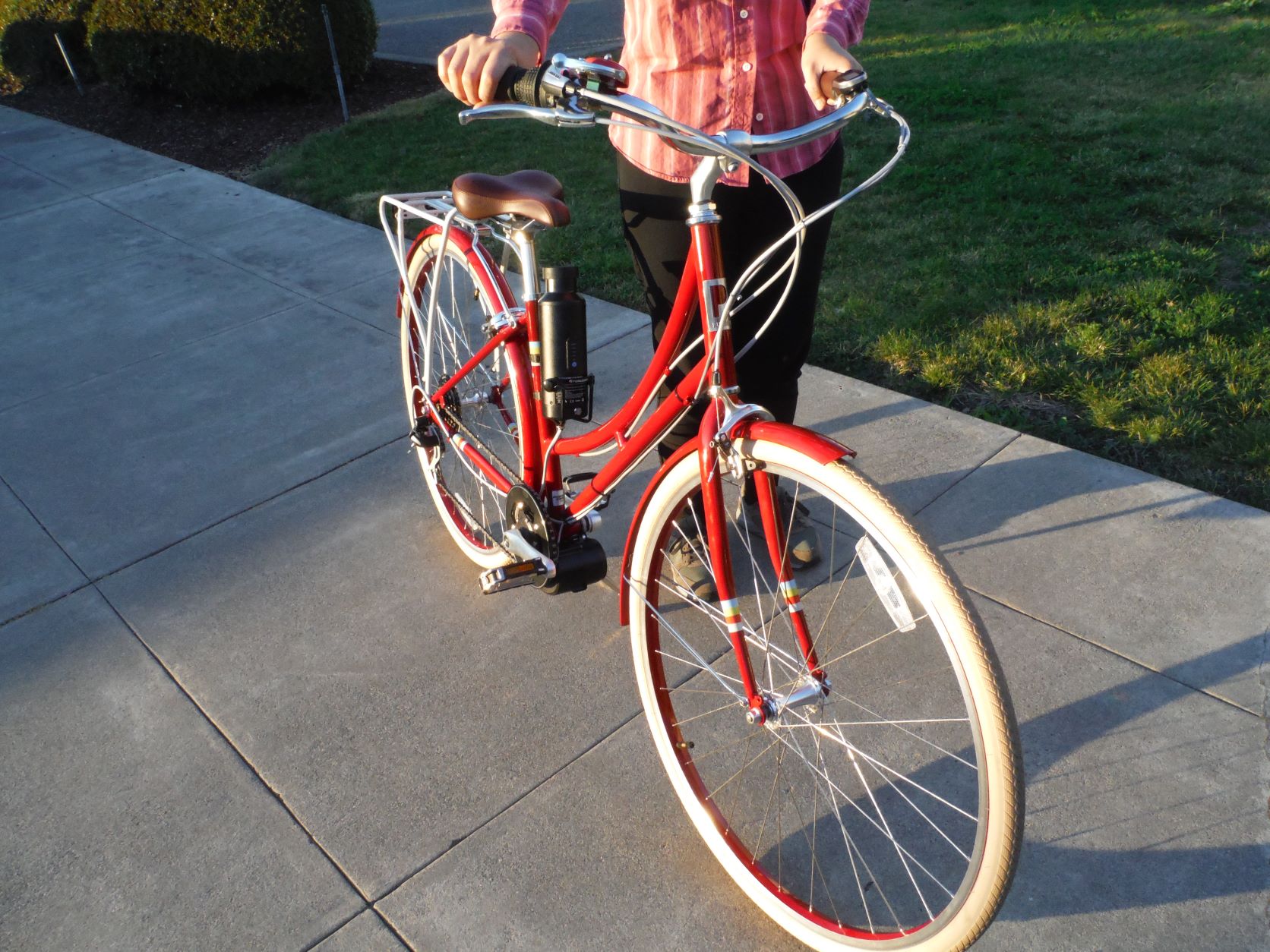

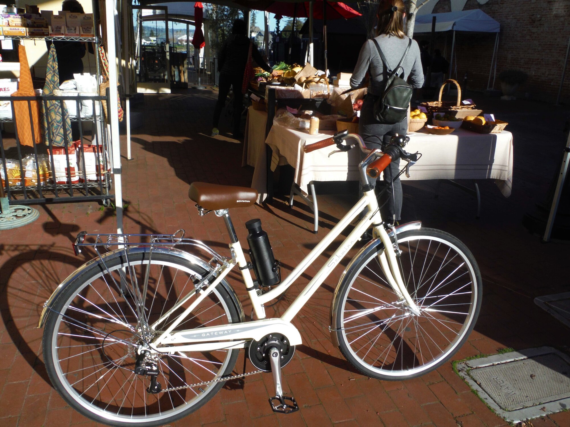

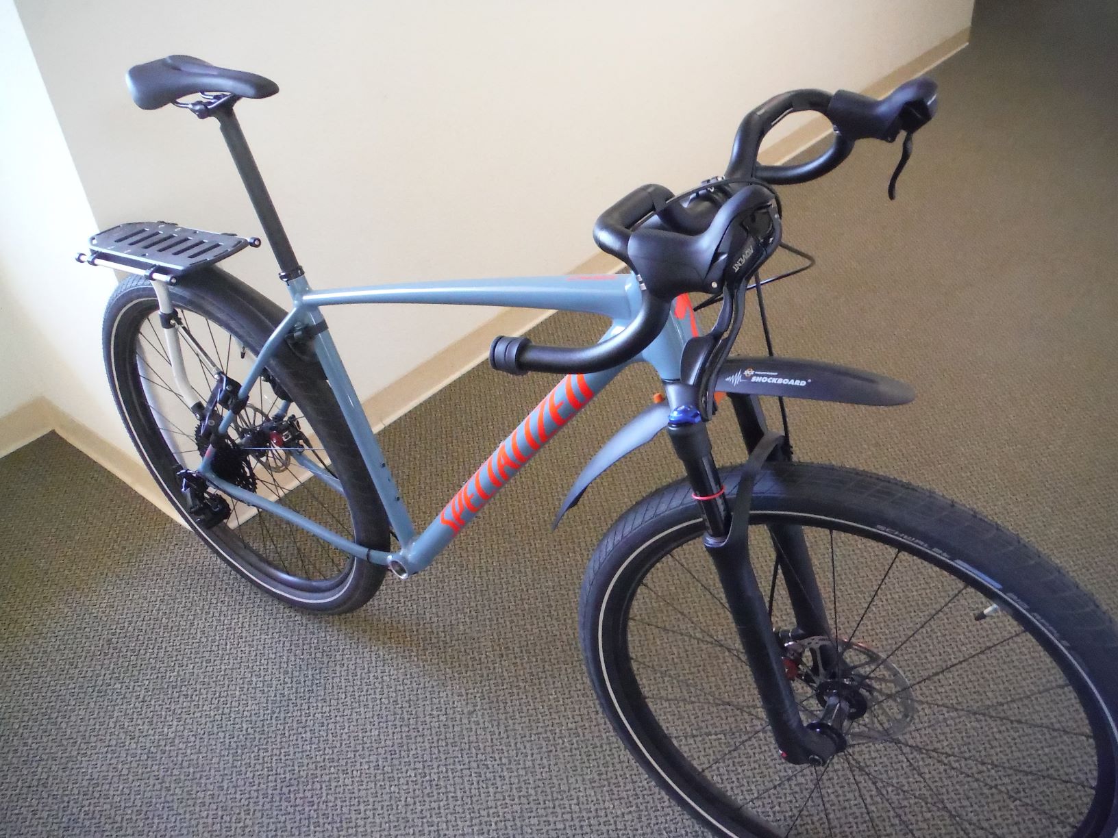

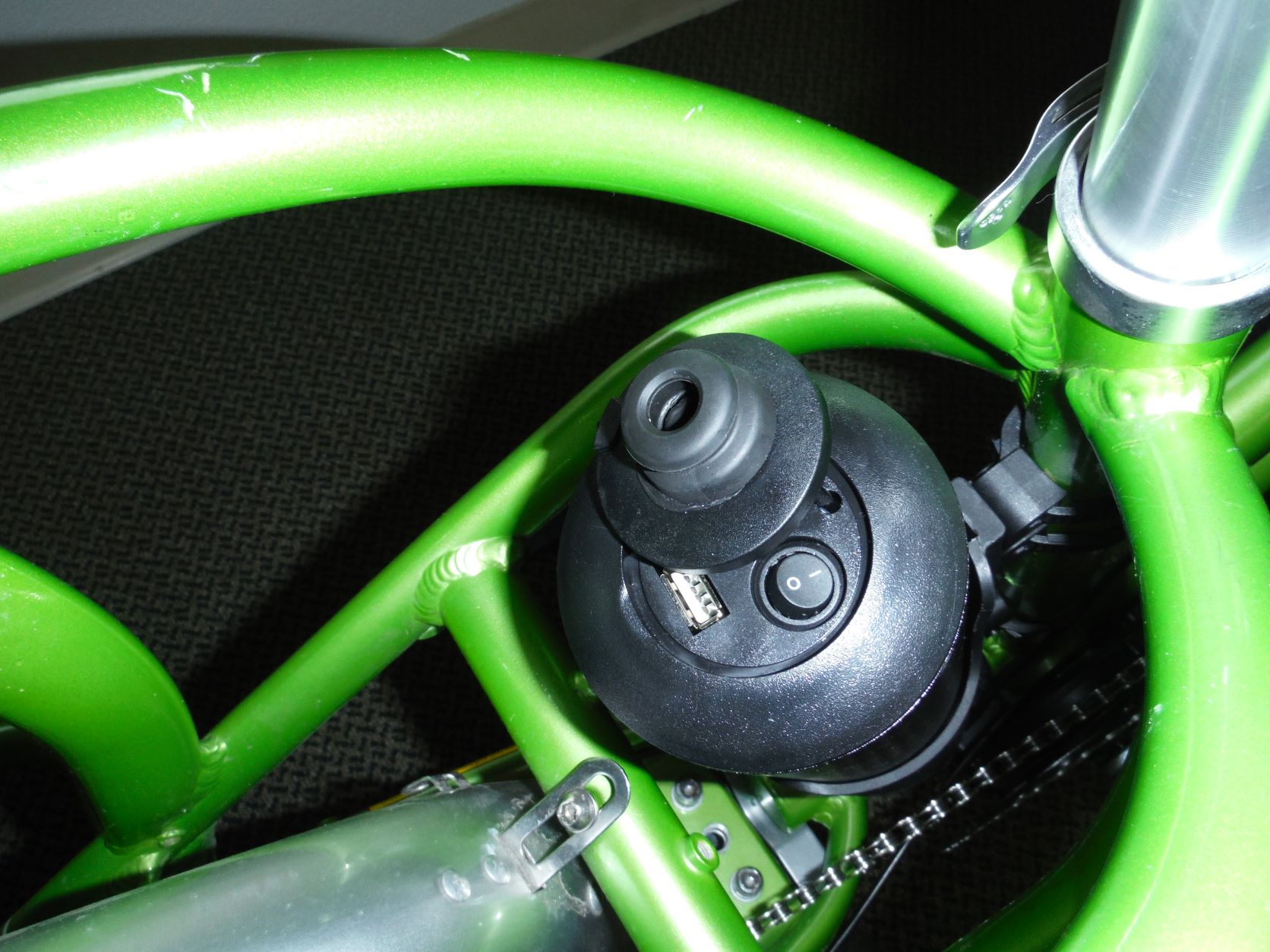

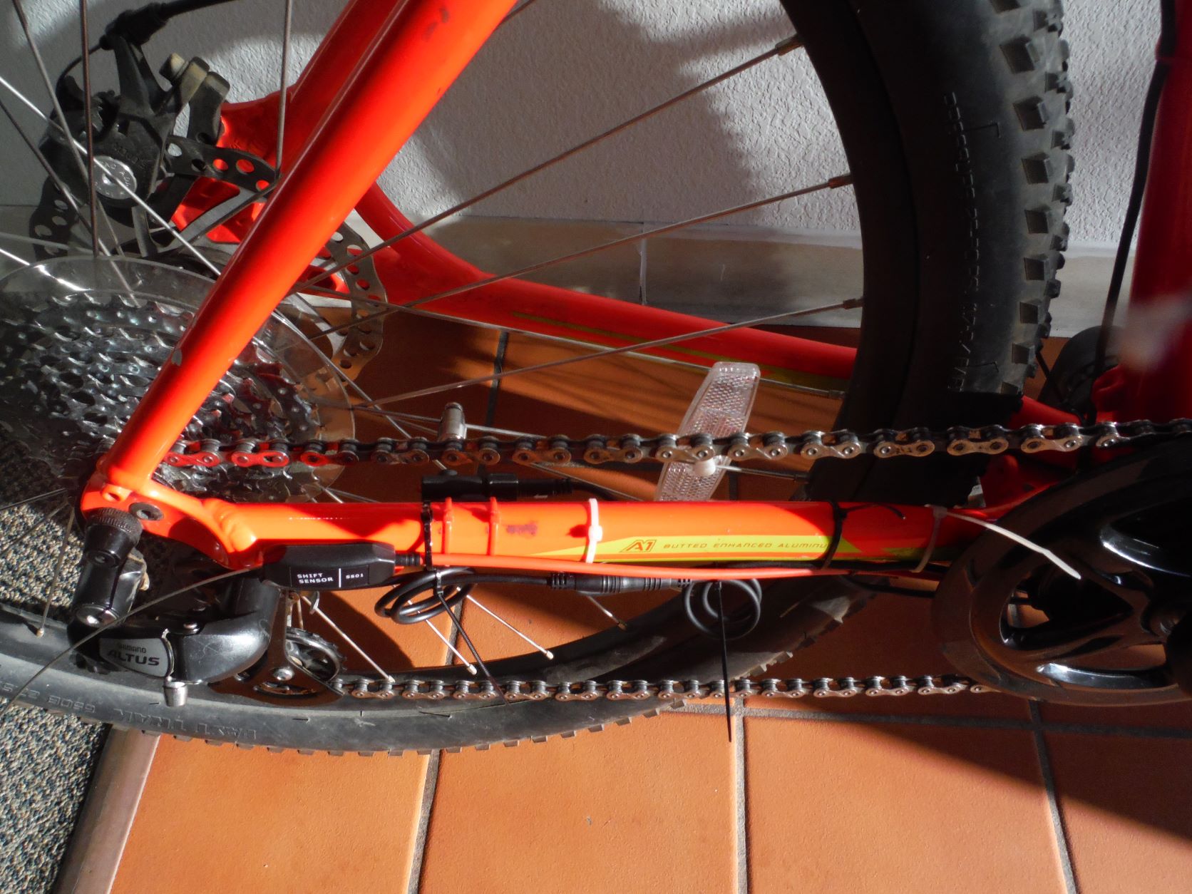

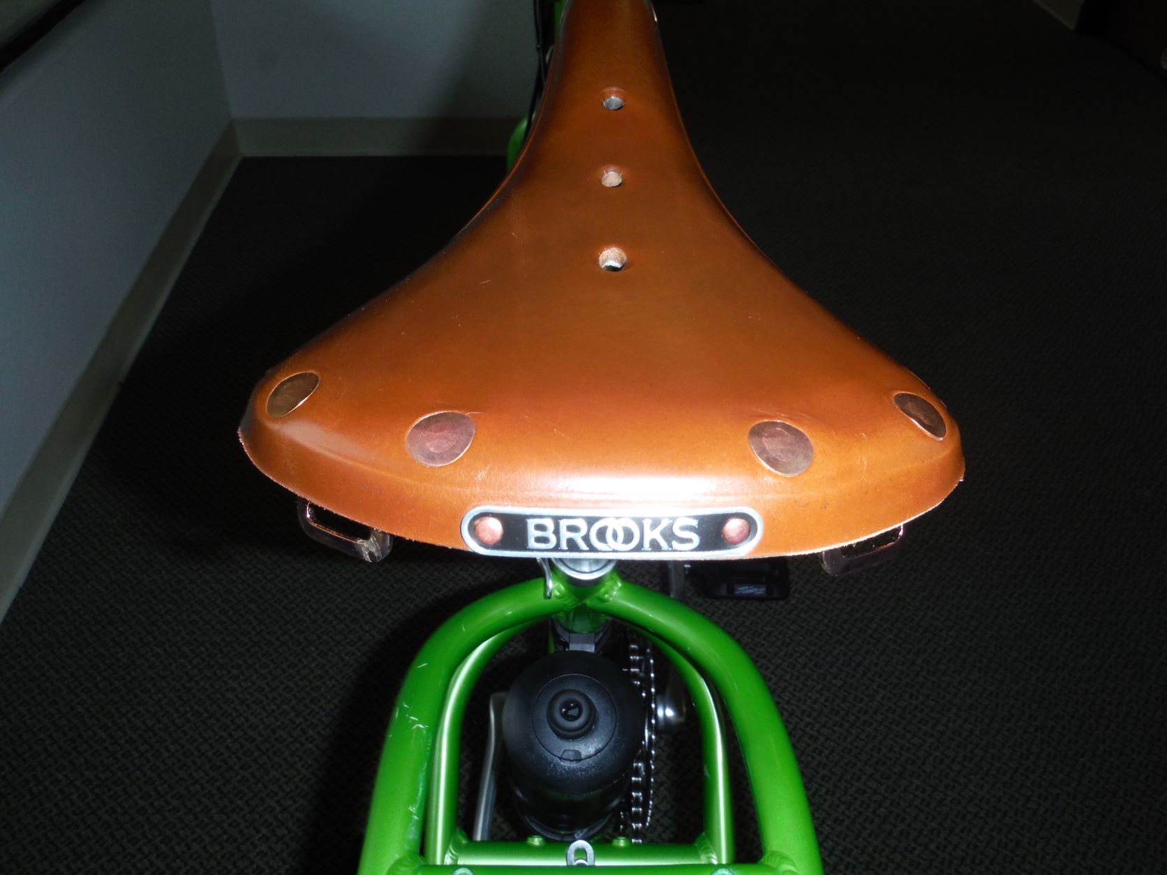

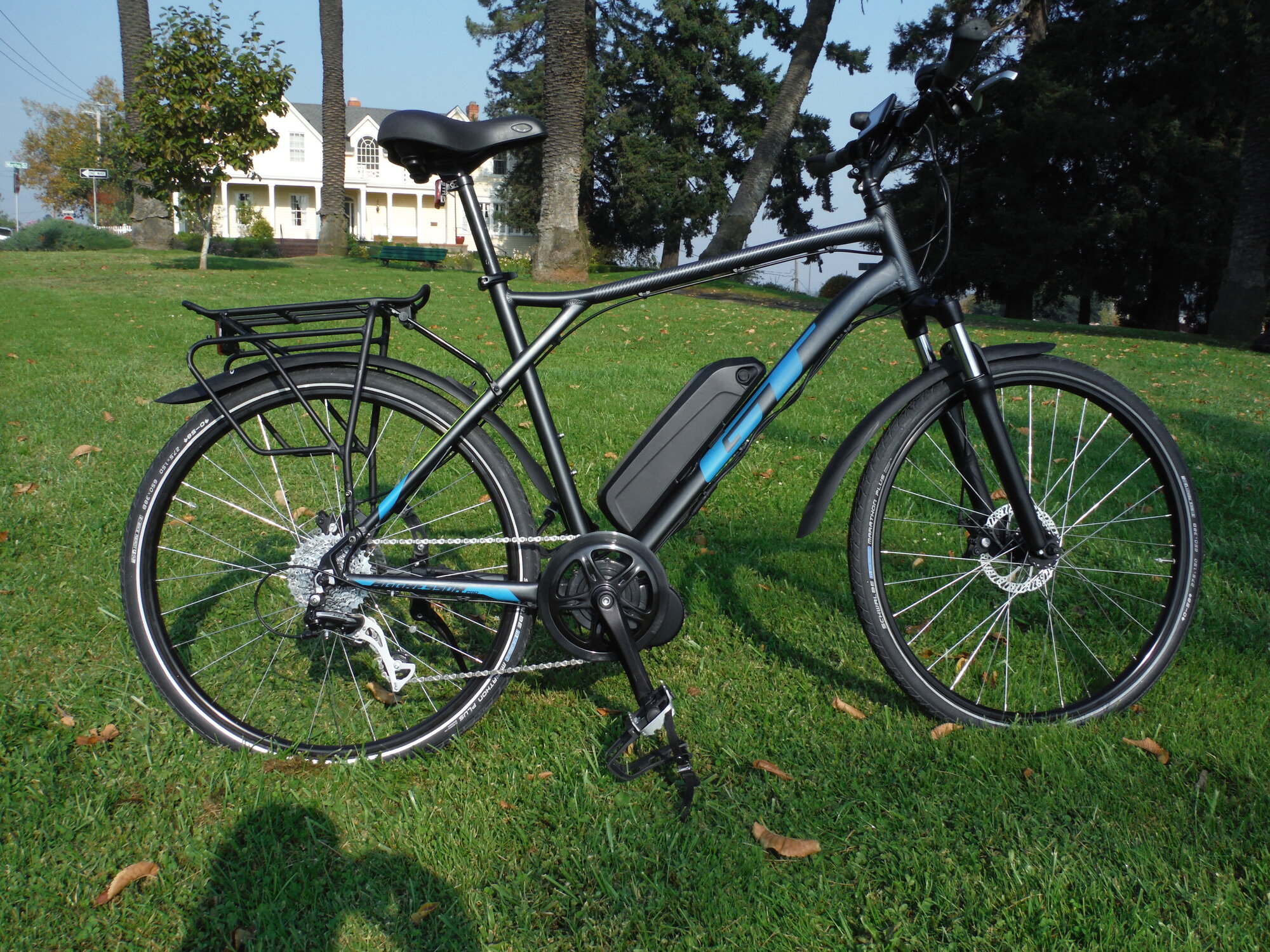

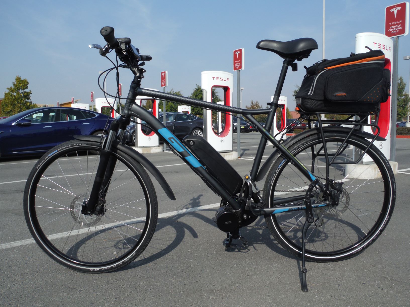

This would be a fun project. I love classic bikes with lugged frames. Here is a British one I did about six-months ago. The battery goes in the water bottle cage. You can see the connector. It is 85Nm. And here is a new red bike that made electric last week for a woman who just moved here from Japan. She will be trying a carless life style for one year. Just beef up the tires and brakes on the Peugeot and you will have a better bike than the ones from stores.

John, I don't sell anything or ship anything and do not have a recipe or formula. Each bike is different. I am just a mechanic with a little workshop. The motor is torque sensing. You can search for them. The six-pin is much cleaner that the more common eight-pin. I am crazy for this $299 Target cream colored bike. That was a clean build. It looks like they want $329 now. The Univega would be cool.

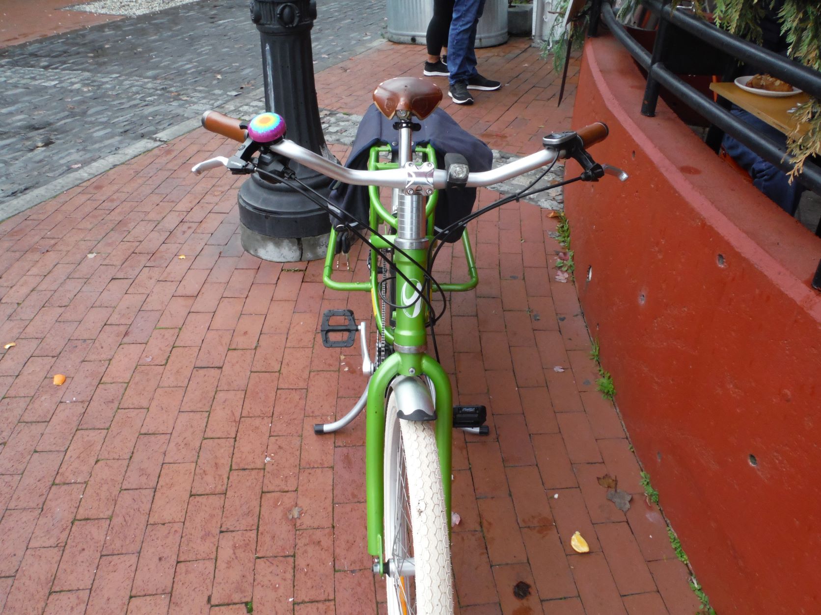

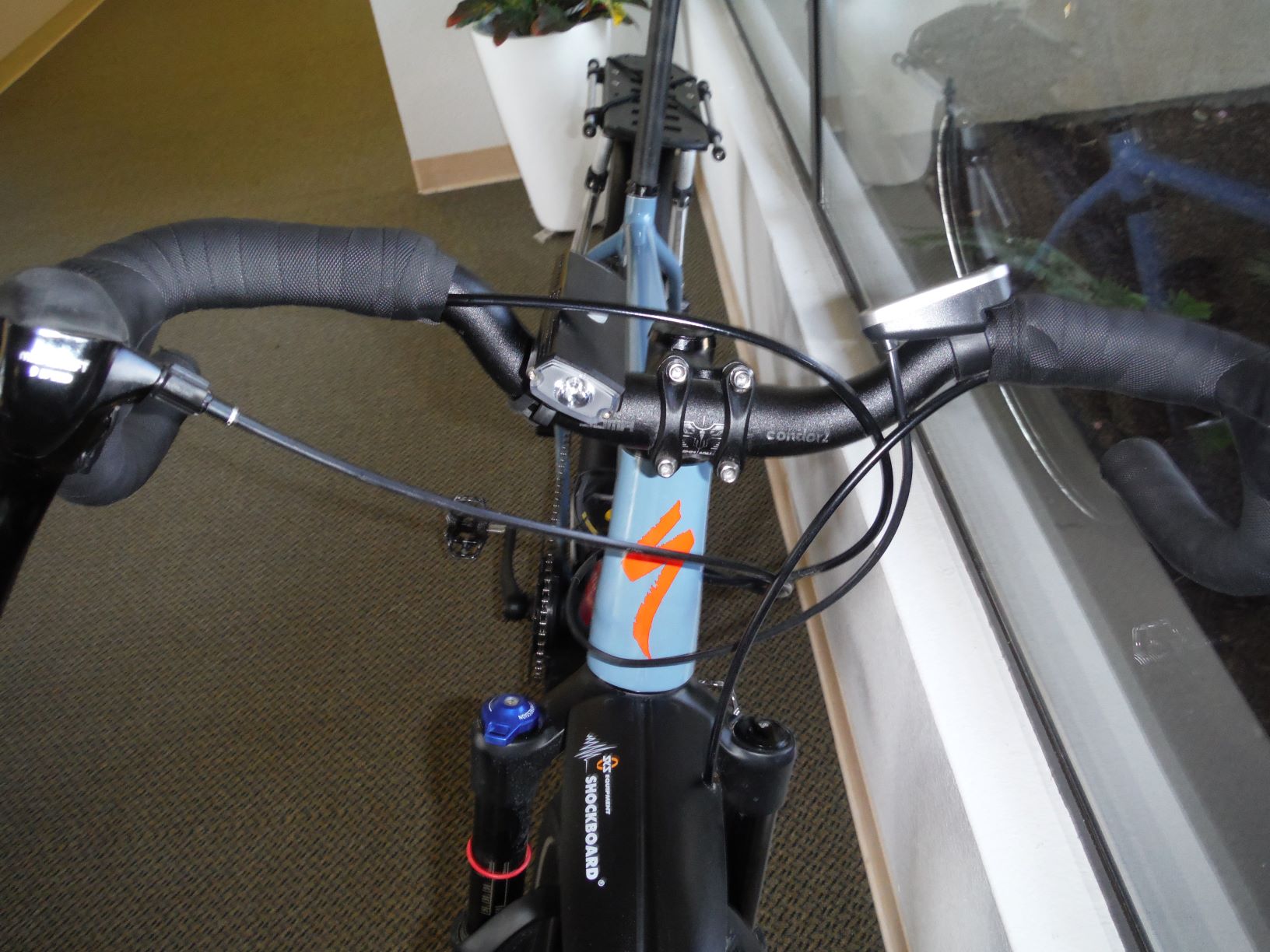

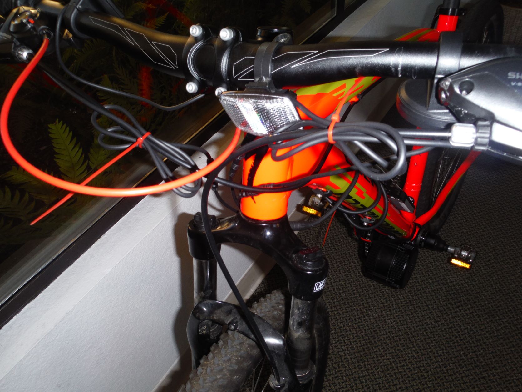

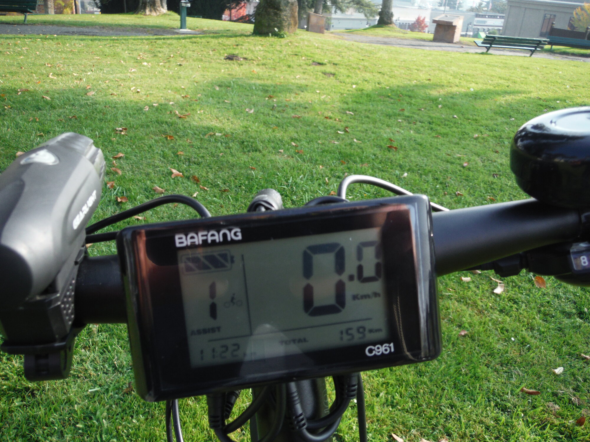

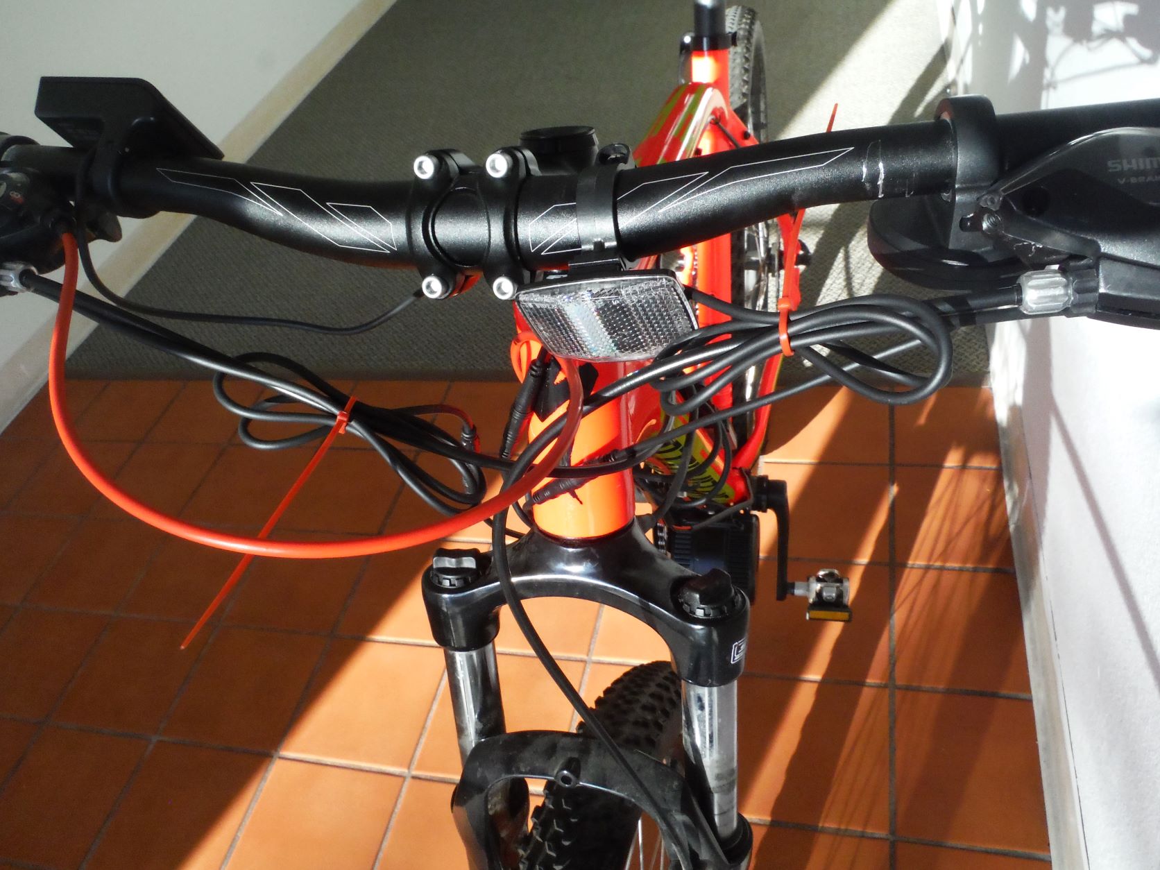

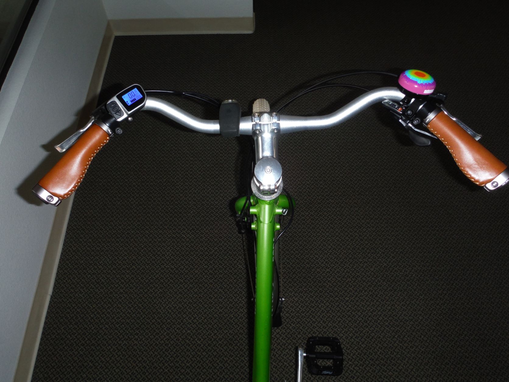

John, Some guy from Eastern Europe accused me of selling stuff here, so I am sensitive. I just want to encourage others. I mostly use TSDZ2 motors. Sometimes Bafangs. 36V & 350W is very nice. Do not install a speed sensor or throttle. Those will make life suck. I came upon not installing them by accident. It makes for a HUGE improvement.
One more thing. There is a secret compartment behind the chainring. It is for hiding extra wires so you do not have a zip tie mess at the HB.

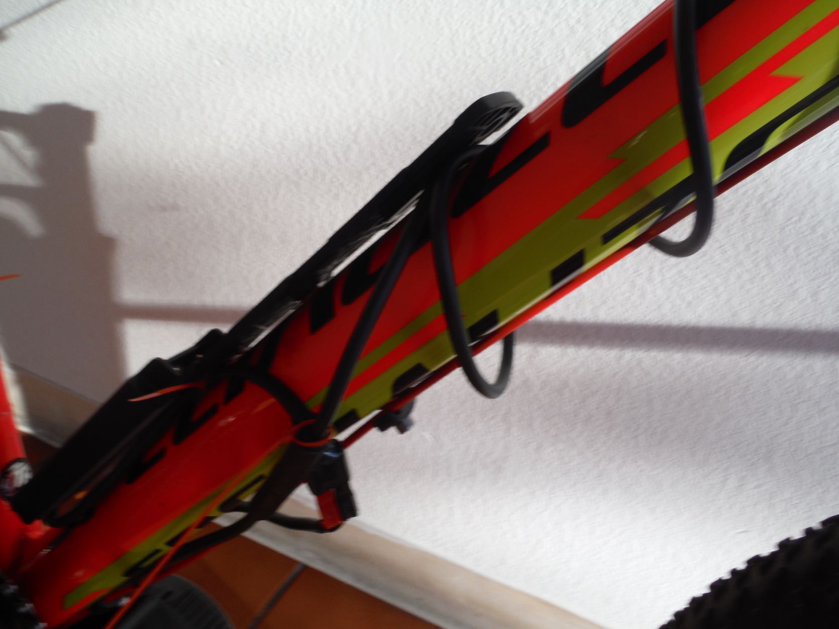

Check this guy's build! Then one of mine.

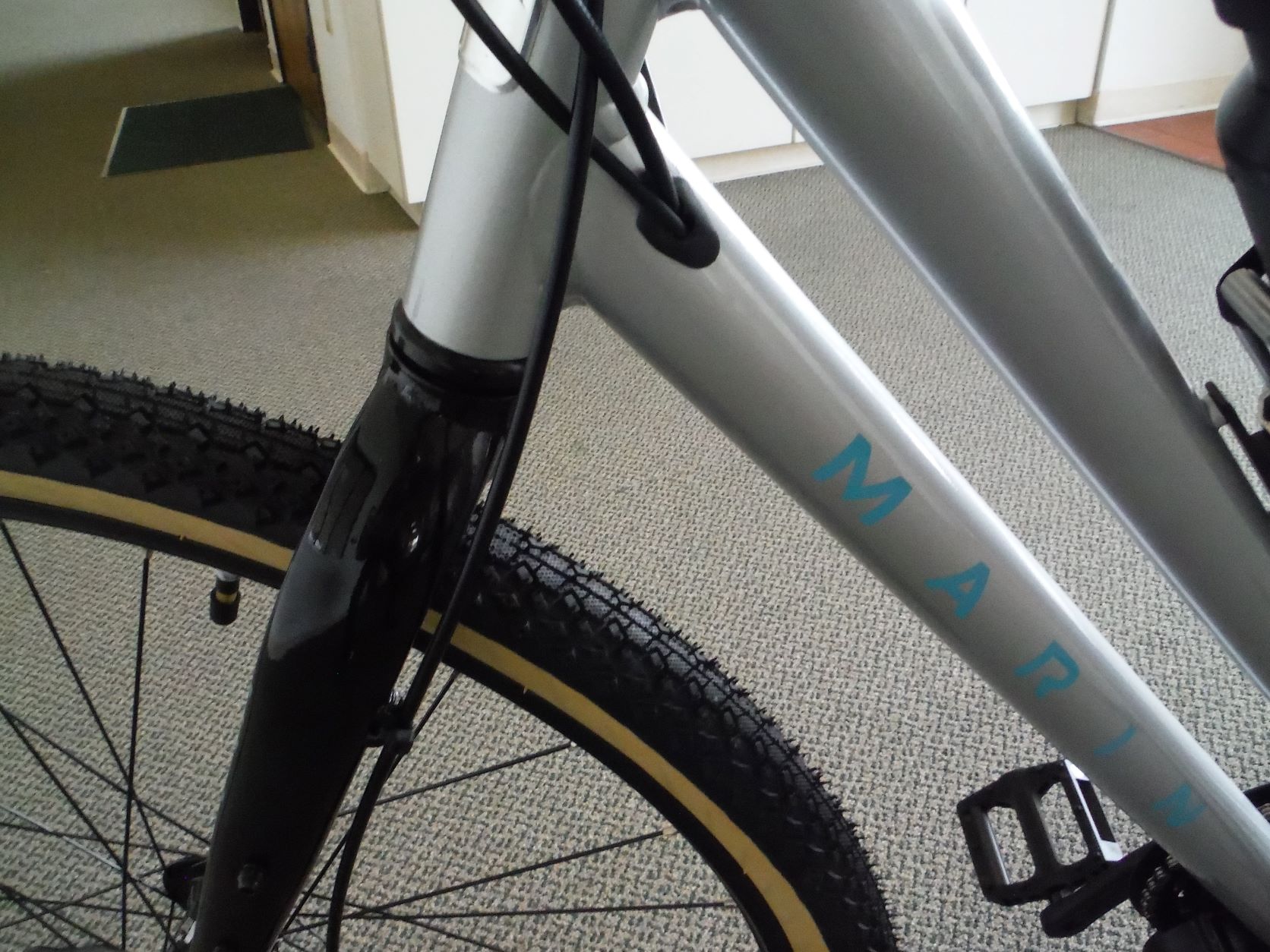

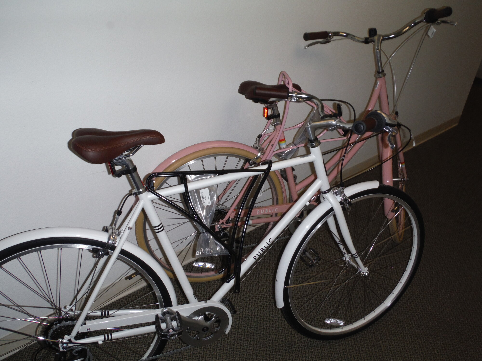

I am not saying that Target bike is for you. I am saying that you can take a less expensive bike and make it nice. A guy posted the price tag today on a $18,049.99 bike. That is not for you either. I joked him that that must be the price in Turkish lira.

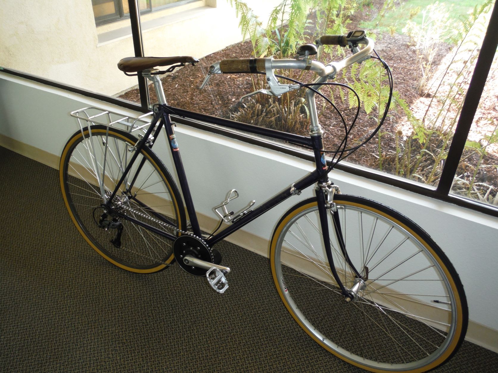

@john peck, a Univega just came in.
John,

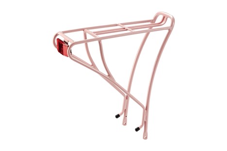

I priced out what it would take to fix this old Univega. $595. That motivated me. I just purchased two new bikes with classic lines for $549 each and another $45 for nice matching racks. That is about the same money as the old bike's repair. I will convert them to sell. I paid a kid at the bike shop the equivalent of a 12 pack of IPA to drop them off after work today. If I repaired the Univega it would still be an old bike. These two are sweet. They MSRP at $700 each. I think it is a great deal.

I think that someone only selling factory made ebikes might say such a thing. I would not convert most road bikes. Those are designed for race day to win that race that day. They are already pushing the limits in every way. You need some margin. They have drilled out chains to save grams. I turned down converting that red one this weekend. I also think that someone without experience might say such a thing. Not out of malice or self interest but because they just do not know. I like steel frames a lot. But many bikes are aluminum and that is fine. Mountain bikes are very good. They are strong and tough. You can just swap tires. Here is one I rode three times today. I put a stronger drivetrain on it and ditched the mountain bar for a gravel bar. A Boda Boda makes a wonderful commuter. It has extra strong wheels and carries 250 pounds on the rack. Here is a green one.

I have a 80s road bike that's extremely light. I've swapped the drop bars for more of a straight bar and it now has a rack in the back. I have some pretty skinny tires on there as well.
I'm just wondering if I were to convert this to an electric, do you have any suggestions for what type of battery to get? I'm new to the topic of electric bikes but am very curious.
I would mostly be using it for commuting around town. I live in Pittsburgh and there are a number of potholes around and the drivers are not the most bike friendly.
If you really like the bike... I say go for it. Follow @PedalUma 's style/lead and you'll be good to go.
Wait! Are the shifters on the downtube? I haven't seen that since... Well 1980's!

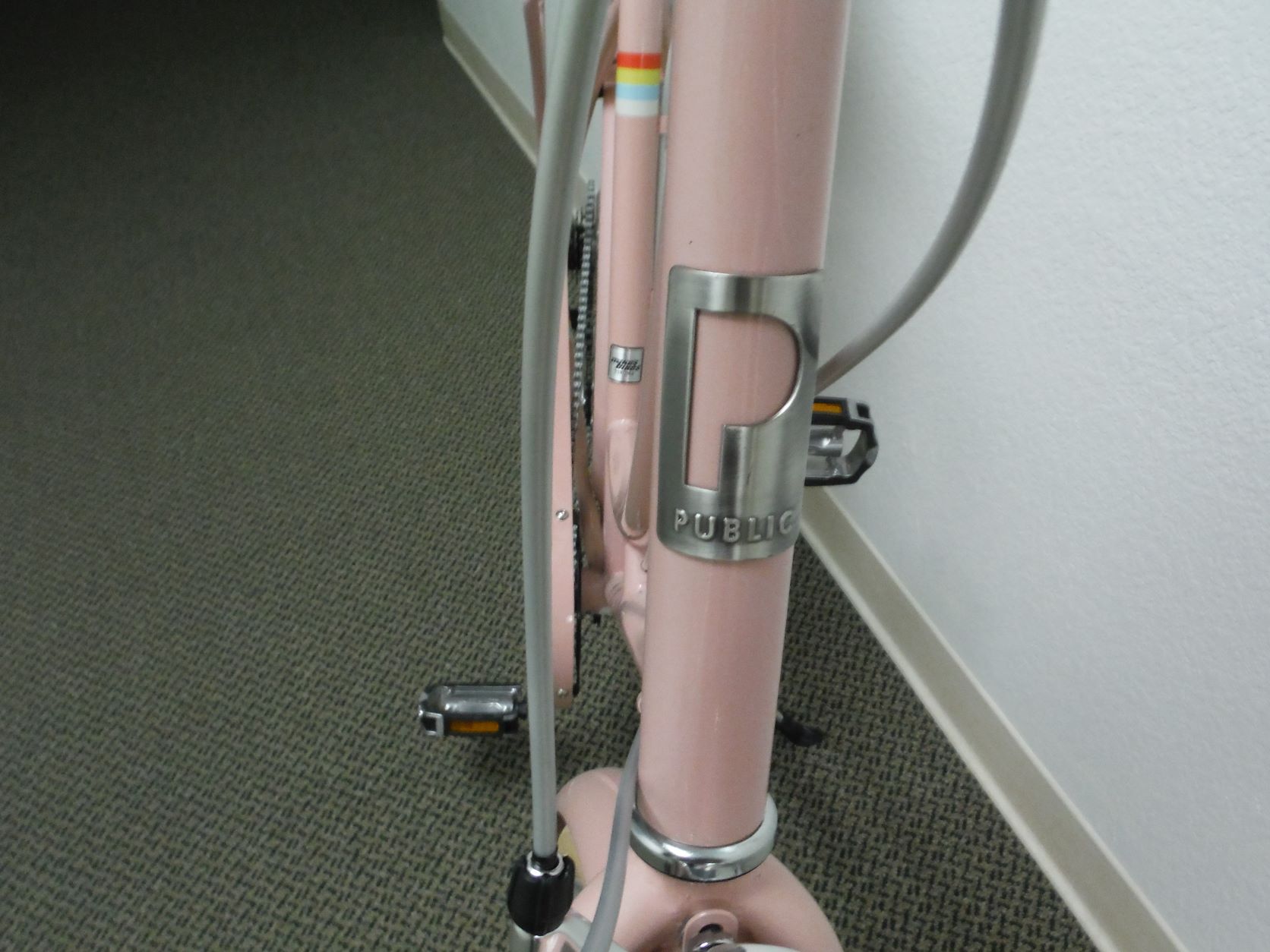

Those bikes arrived, almost an hour late. I am so happy. Look at how the rims match the frames.
