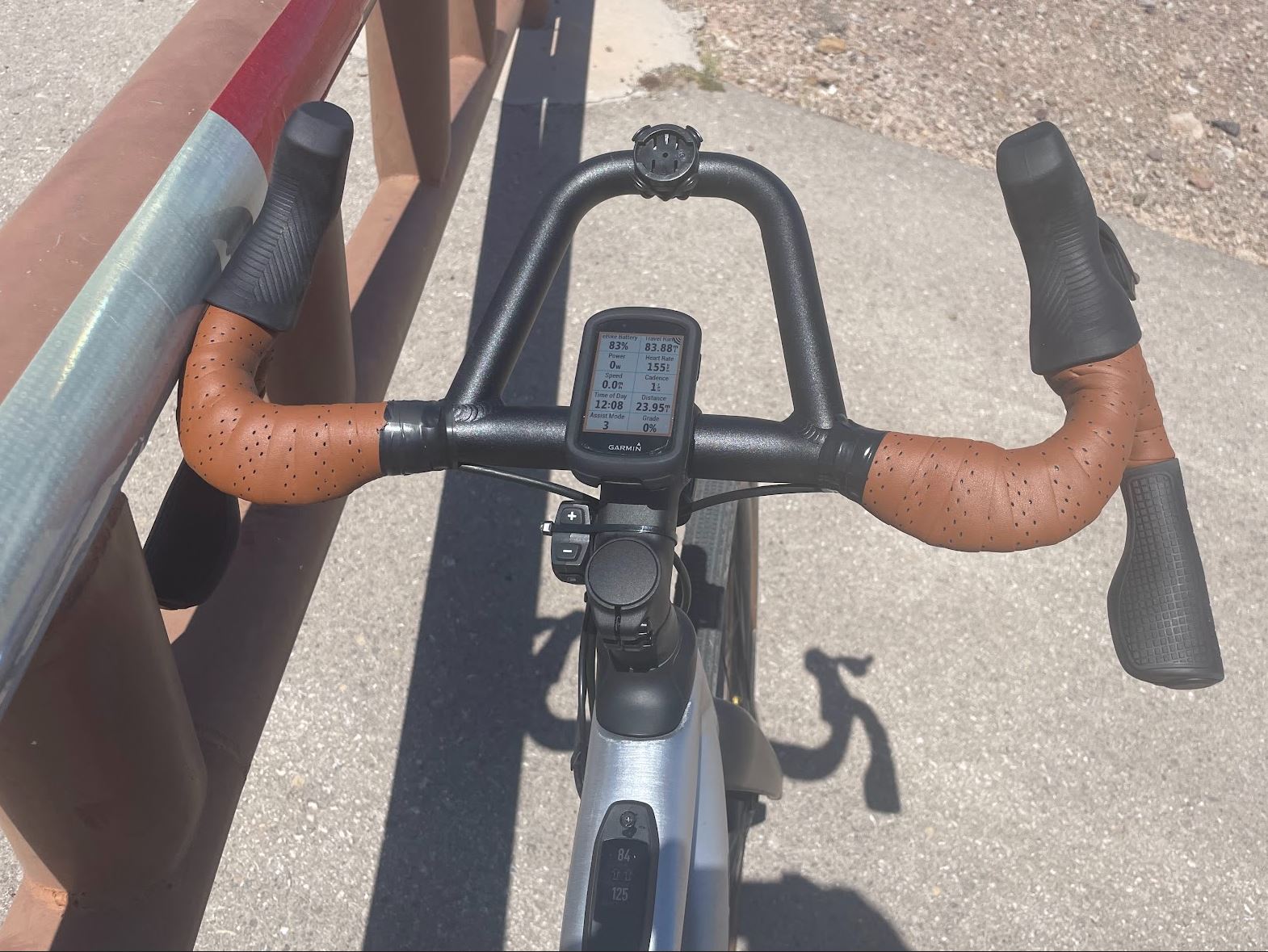

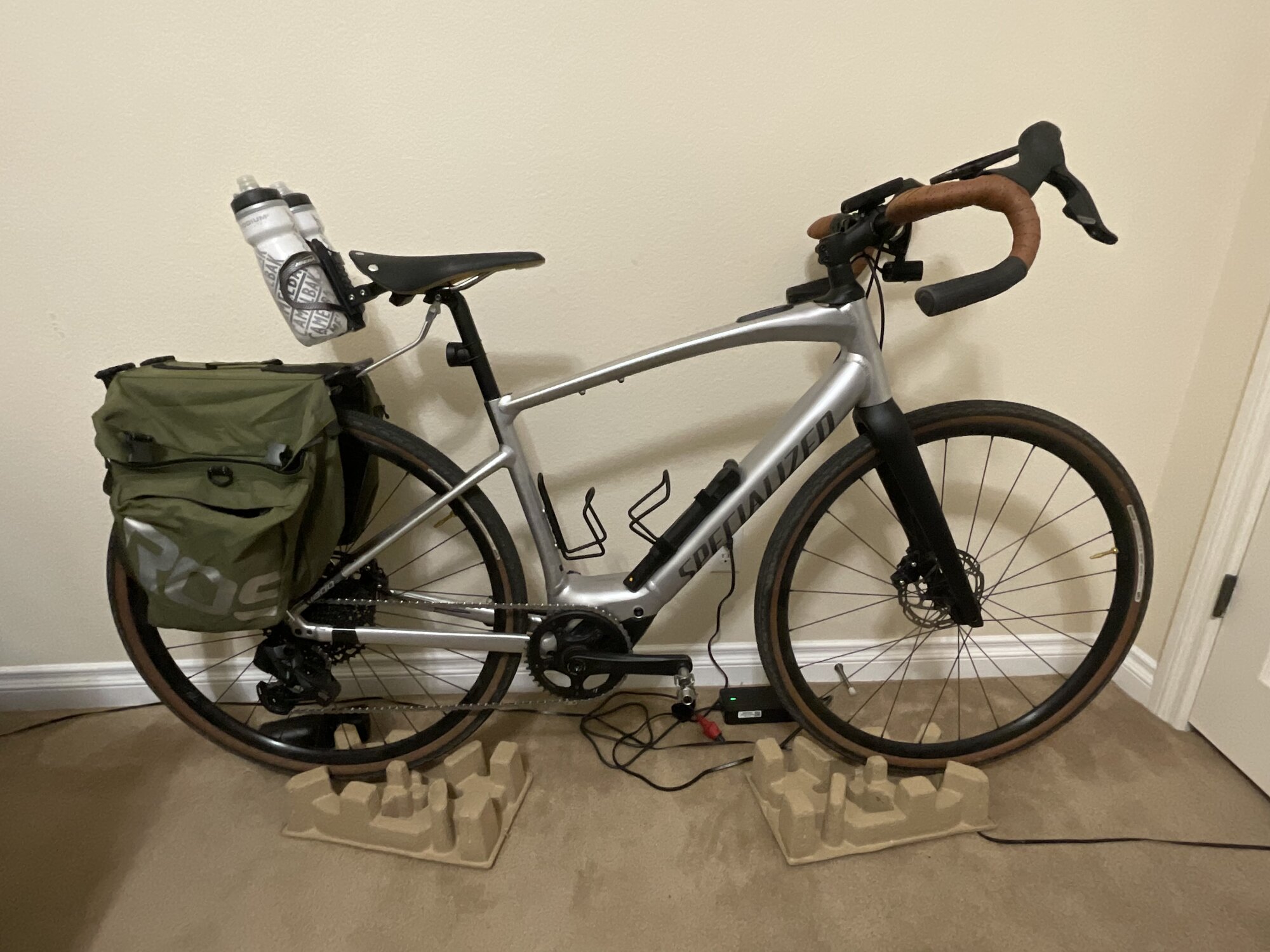

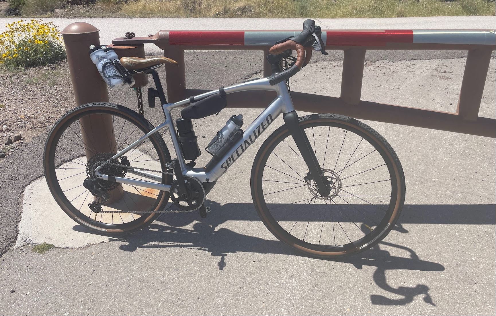

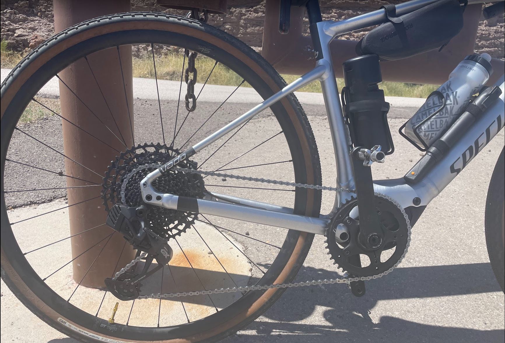

This project has been on my bucket list for quite some time now. I finally converted my SL 5.0 to a drop bar. I went with SRAM Rival AXS and a AXS GX Rear Derailleur (mullet setup). For the bars I went with REDSHIFT's Kitchen sink and their ergo grips. It was a fairly straightforward process; I did have to remove the motor to remove and install the new hydro lines however. First shake down ride was great. I'm enjoying the relaxed riding position, but still can get low on the drops.

I really like the brown/black combo. 👍
Were you able to keep the original calipers?
Thank You, I have a new brooks saddle should match great but I, not ready to go through the break in process yet lol.
Sadly I needed to replace the calipers since the tekro ones are mineral based and sram are DOT 5.1

Nice mods! What Brooks saddle are you going with?
Thank you, I have a B17 but decided to go with the C17 Cambium since I plan to use this bike more for bike packing.
