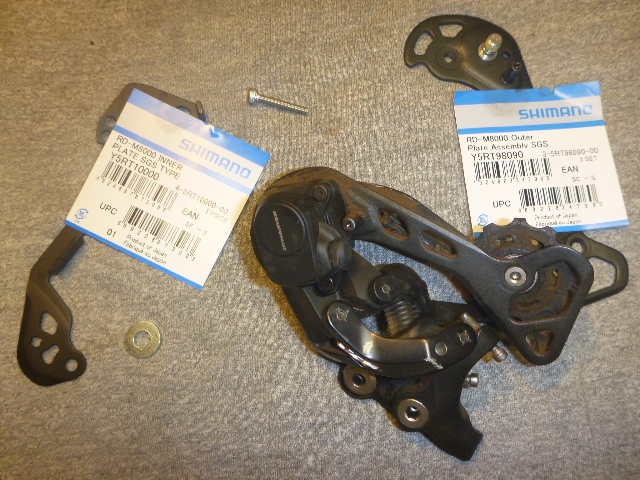

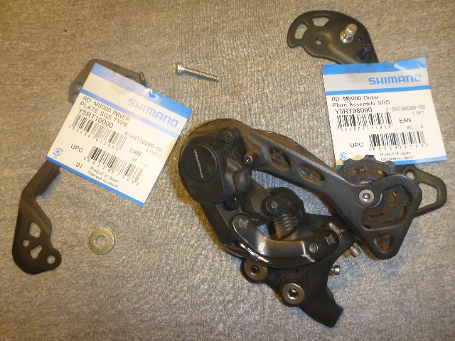

So all the new parts are in. I'll be converting my medium cage XT Shadow Plus derailleur to a long cage, changing out the cassette to a 11-50t, and changing the chain from 120 links to 126 links.
Yesterday I tackled the derailleur;
A new long cage derailleur is something like $120 so I went with the $27 solution, new cage arms and a longer B screw. Obviously my derailleur needdd a good cleaning anyway so as a first step I took it apart...

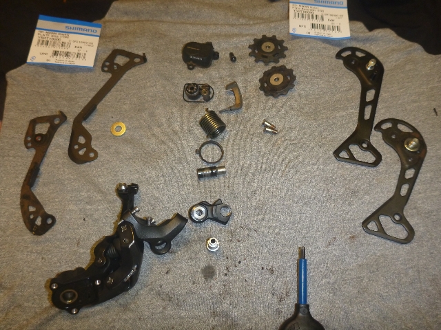

Lots of parts, even without removing the 3 adjustment screws! I scrubbed most parts in warm soapy water them 'orange' degreaser followed by a rinse in the water and air quick dry with the compressor. My normal practice is to lay the parts out in order of disassembly to help me remember how to put them back together! I did take the silver colored dust cover/spacers off the jockey wheels expecting to find loose bearings that I would clean and grease. They've got sealed bearings! So a quick clean and dry for them was all that was needed. After cleaning all the parts I sparingly added grease where needed using a silicone grease on o-rings and the smallest parts and Park tool's poly grease elsewhere. Time to reassemble...

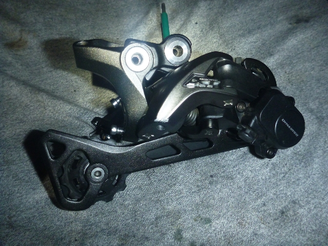

My almost like new and very clean long cage derailleur is ready to reinstall on the Vado, after I change the cassette. The clutch had me stumped for a bit. Luckily I had my wife's Vado available as a reference. I was assembling the clutch correctly. I just needed more spring tension on the arm. I got this my extending the derailleur's cage for clearance and rotated the arm 360° to preload the tension spring. Worked great! On to the cassette...😎

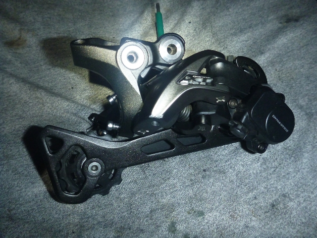

Oops! Found an assembly mistake this AM when I double checked my work. If you zoom in on the last pic above you can see a directional arrow on the lower jockey wheel. It's pointing the wrong way for the chain feed! At least I got the jockey wheels in their correct positions; there is an upper and a lower wheel with different teeth patterns.
The upper wheel has its directional arrow going the right way...🤣 Go figure.
