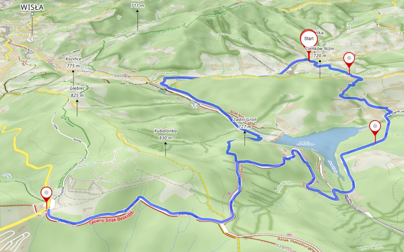

Now, you have inspired me. Next summer, I need to climb up the Kubalonka from Wisła and descend on the way back. I can remember a travel by car... Night, fog, and rain ;) The Wisła - Kubalonka road is also being closed for the winter!
