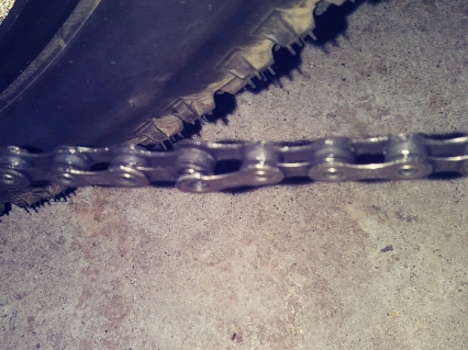

Good catch! you avoided the walk of shame.Well, remember that 9 speed x 126L chain nonsense? Both my son and I have a number of good experiences spacing chains together. This one hasn't worked out so well;
After about 50 miles I was getting an intermittent click from what felt like the cranks. This is what I found the next morning after I went out to the shop to check it out. An outer plate on the shorter spliced section had popped loose. Not good, but I didn't have to walk home! I thought this might actually be the plate where we made the splice so I took this 1/2 link out and replaced it with another master link.
Didn't work. Another outer plate came lose on the very next ride, also from the spliced in section of chain. Hmmm.
The spliced in section had come from a brand name ebike compatible 11-speed chain with ~500 miles on it. There is probably some extra stress shifting through the 11-50 cassette vs the original 11-42 but this seems awfully sensitive.
The LBS had an 11 speed 126L ebike chain instock so I installed that as a solution. We'll see...![]()
...and no walk of shame, so far..Good catch!
