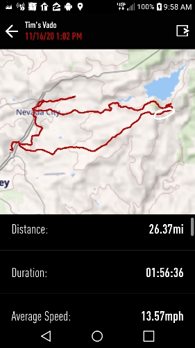

Update on the gearing, and new chain; so far, so good after several longer rides! Shifting is smooth and reliable, though the transitions between the last 3 largest cogs is a bit rougher as there are bigger tooth count jumps to get up to the 50t cog. No visible chain damage.

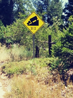

I rode out to the steepest grade I know of (that isn't a crazy MTB trail) to test the new granny gear.
View attachment 71664View attachment 71665
The County Public Works Dept has this road section signed with a grade of 31% at the top and bottom as a warning to trucks. I can't confirm the grade on our USGS topo maps, but they have a minimum contour interval of 40 feet so they leave a lot to the imagination. My take off these maps is that the max grade is more like 22%, but all I really cared about is a test for the new granny gear. It worked great, shifted into the largest cog smoothly. Didn't need to stand to get to the top, unlike last Spring when I rode this with my 11-42t cassette. This gearing change will do the job for me, i.e. guaranteeing I can get home regardless of how tired I am! 😎
Got home with 27% battery remaining after 26+ miles and 2,600 of climbing on a beautiful fall day.
It was a wet afternoon so I talked my wife into driving out with me to this steep road grade to check the 31% grade posted by the County. As I slowly rolled down the grade she was watching the slope on her inclinometer (retired Engineering Geologist). It hit 17° (31%) on a section near the top that was maybe 50 yards long. So, the County signage is confirmed, this is a 31% grade! 😯

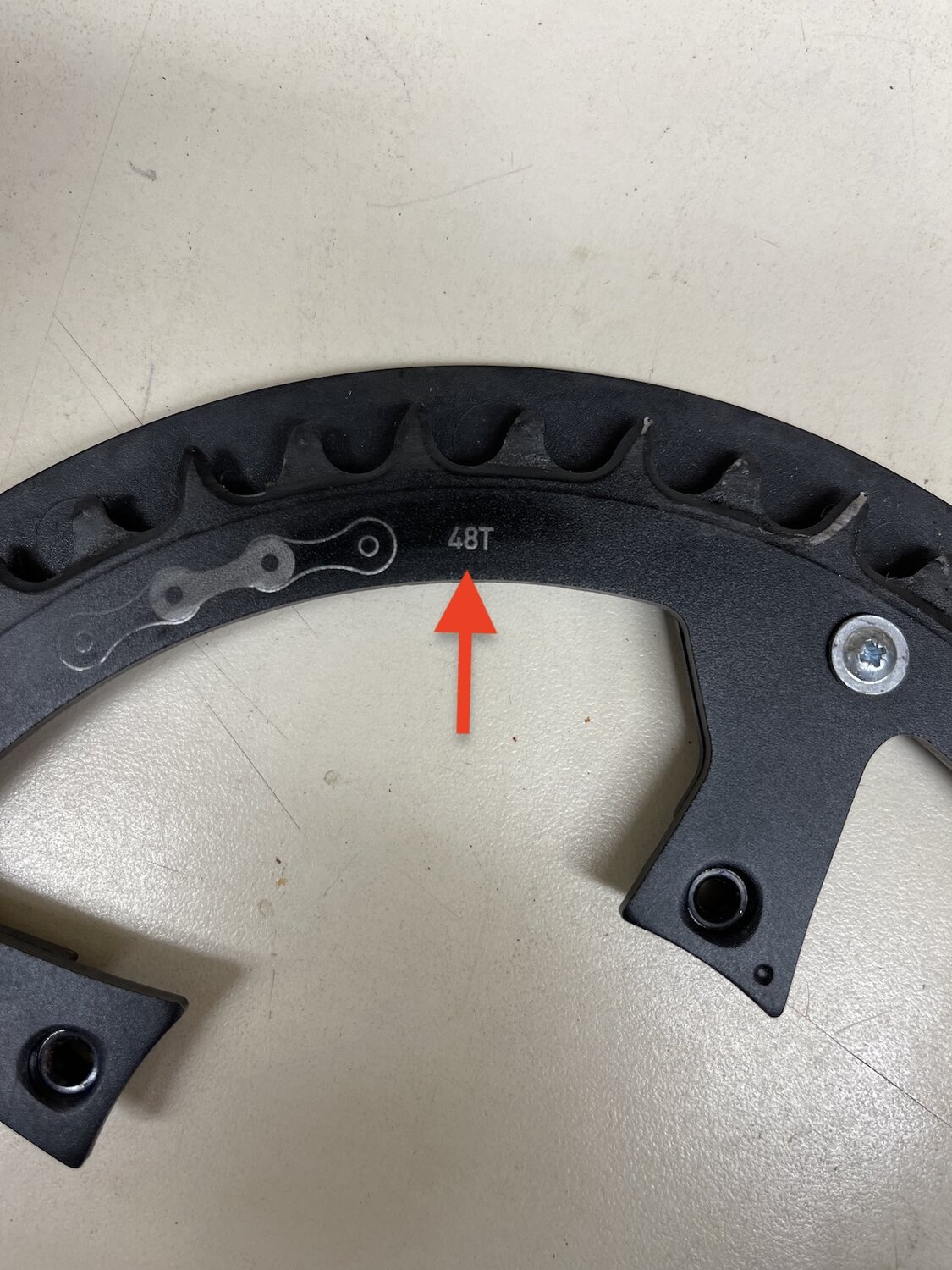

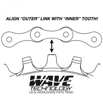

Stefan, can you elaborate as to what the proper Narrow-Wide pattern is with regard to the installation of the chain?
Regardless it is a Narrow-Wide or Wave chainring, you should always look at the chainring and the chain from the top, You will notice some chainring teeth are wider than other (they might be shorter at the same time, but always wider or located to the outer side). The point is to put the chain with the wider link onto the wider tooth. That's it. If placed properly, you will see how the chainring teeth perfectly fit the chain.
Sometimes, there is a diagram on the inside of the ring how the chain should be placed.
