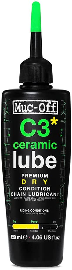

I strip off all oils and use dry ceramic lube that does not attract grit.

Dr. Who (X) and his Assistant like these products. I am in the dry West. I may use a different product in the Tropics or in England.
Engine oil (wet lube) for me to ensure that it is properly lube.
Dry lube won't cut it in my range.
