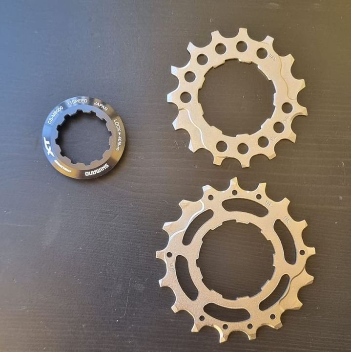

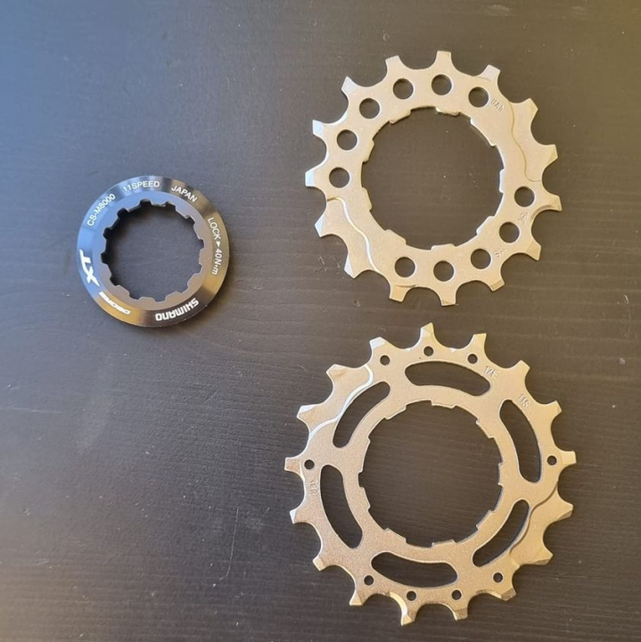

I have ridden my Vado 5.0 for 2,000 miles without the chain replacement (1% elongation). Because of my negligence, I had not only had to replace the chain but also the 11, 13, 15, and 17T sprockets of my cassette. Additionally, a new lock-ring was necessary, as the sprocket replacement for this e-bike was done earlier for several times. This expensive cassette allows replacing as many as 8 sprockets out of 11 if needed.
