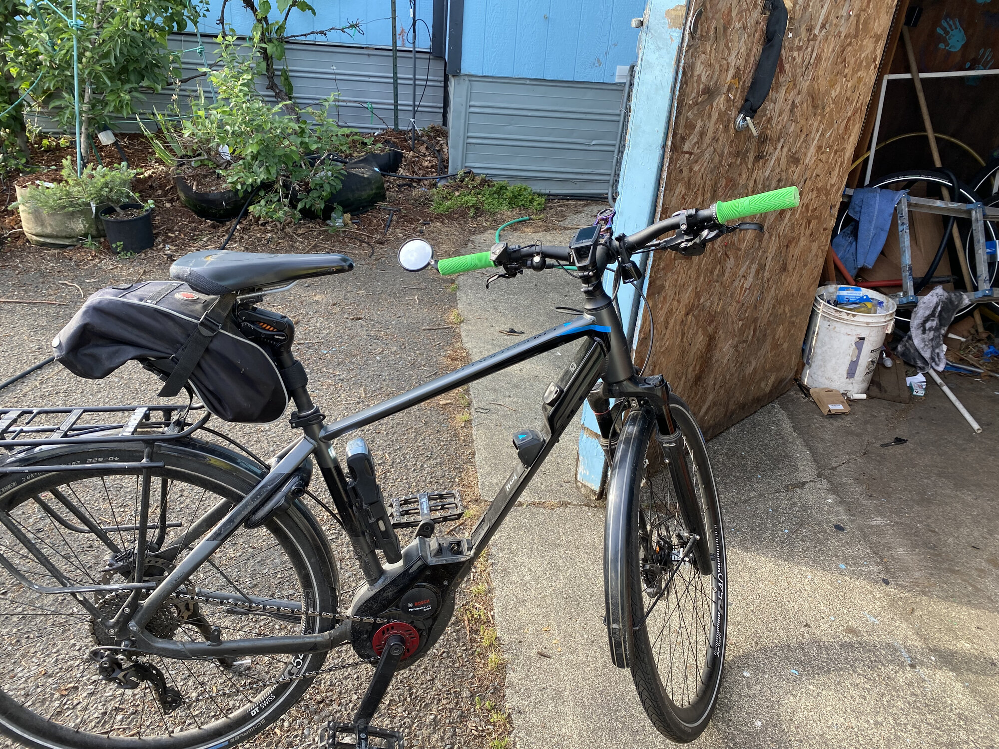

doing this helped a lot. getting rid of the chain guard and adding this chainring guard.
Is that a Miranda chain guard? Whatever it is, any chance you remember where you got it and for how much?
sure just bought another for our tandem. https://www.amazon.com/gp/product/B01N5A610D/ref=ppx_yo_dt_b_search_asin_title?ie=UTF8&psc=1 you also need this guy to remove the locking. there are cheaper ones maybe 15.00

I have almost 12,000 miles on my cassette and chainring. well maybe a couple thousand less on the chain ring. its starting to get noisy though, but we are talking 5 chains so far. the chain guard is the plastic thing that covers the chain mostly.the chainring guard is what I posted picture of and a link I like the sram chainrings they are really durable. https://www.ebay.com/itm/373426632781

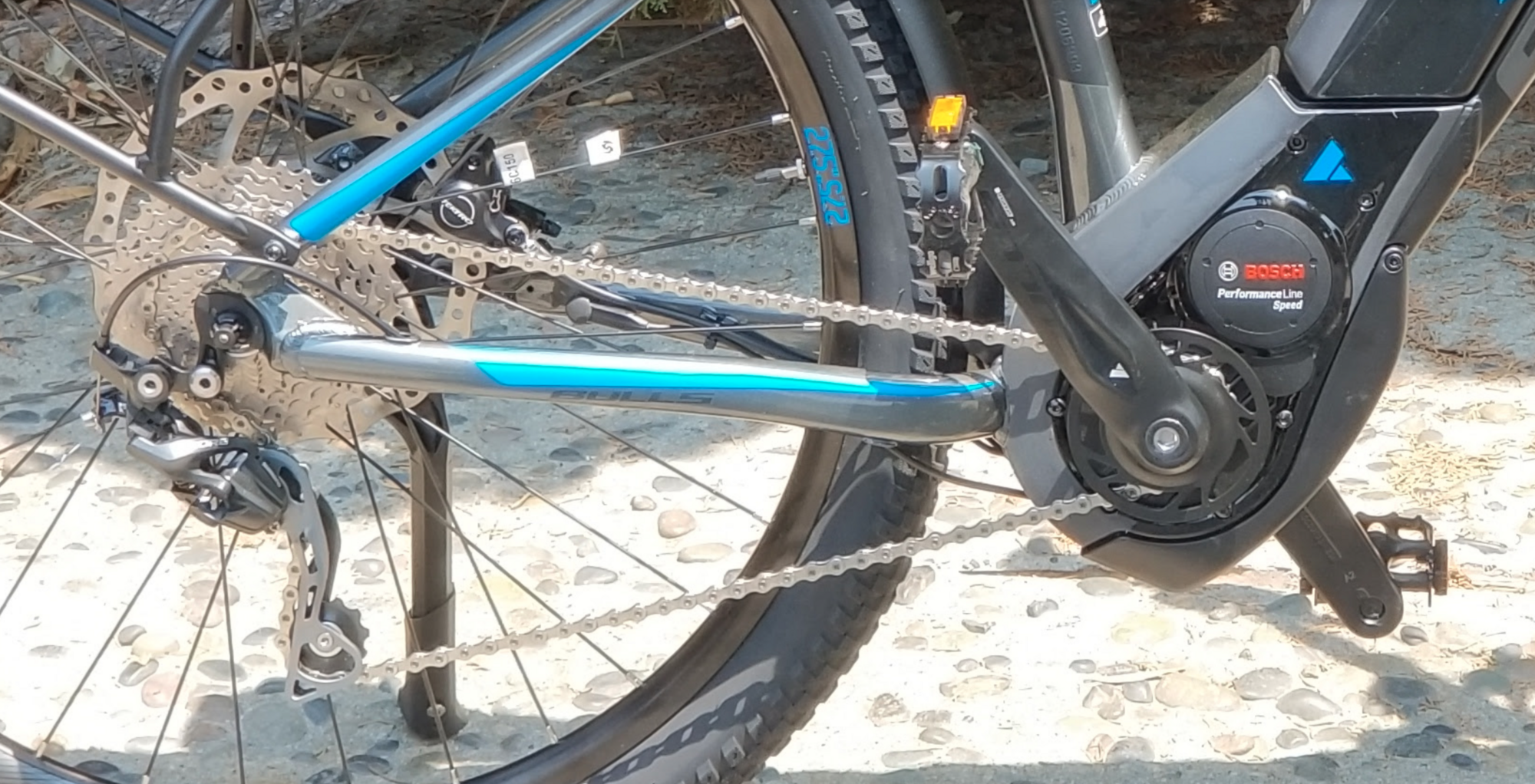

@fooferdoggie - Ok then, I don't believe ours came with a plastic chainguard, just the black chainring guard. I just wanted to be sure I identified all the parts we should replace. See this photo below from when it was new.
Other than number of teeth and if it's for ebikes, do you know if there's anything else special we should look for compatible chainrings on the 2018 Performance Line Speed motor?

our tandem had that one too but in the crash it got trashed. so you dont need a new one unless it brakes. ours was attached to the crank arm and then the crank arms had to be replaced it was gone. thats the right chainring. you need this tool or one like it https://www.amazon.com/Park-Tool-LR...ds=bosch+chainring+tool&qid=1632344996&sr=8-3
I use a 18 I can climb hills great and 30mph is where I spin out. but 16 would really give you some climb ability. anymore I can get up any hill on tour and don't need turbo now.
Oh if I understand correctly, I should only replace the chainring guard shown in the photo unless it broke, (and it hasn't). Maybe then I should only replace the front chainring. I'm looking for 15t or 16t only (18t is too large for her with the hills she needs to climb).

yes I would not chan the chainring guard unless you like the looks of it. yes if she has trouble then a smaller chainring will really help. it will get noise though I found. but thats the right one you have the second Gen motor it looks like.
