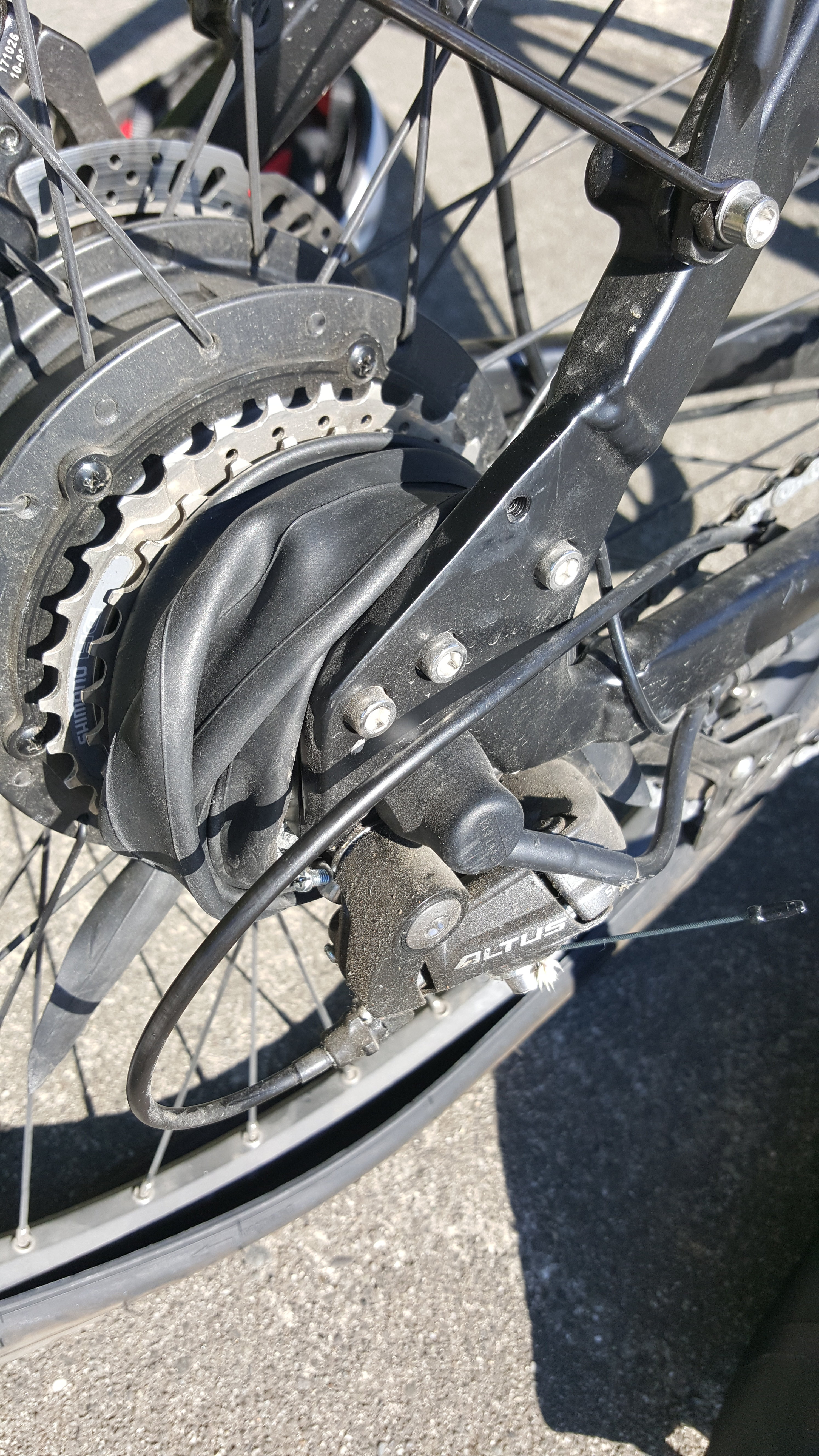

Just ripped one of my CCS Kenda tires (probably on glass). Might as well upgrade to the Schwalbe while I'm replacing. This Amazon one is the same one that Juiced offers as an upgrade right? (700C x 45C)

After replacing the tube it was scary riding 10 miles more on this:

Never had a flat in my life before this catastrophe (thats the inner tube wrapped around).
No i guess i cant limp home with an ebike flat and i am worried what damage i might have done to the sensors. So i appreciate the tire recommendations and amazon link. Lets see how my first ever replacement goes.
View attachment 24161No i guess i cant limp home with an ebike flat and i am worried what damage i might have done to the sensors. So i appreciate the tire recommendations and amazon link. Lets see how my first ever replacement goes.
Sensors should be fine. I had a pannier bag bounce off and get jammed, in that same area, so hard that it bent spokes and cracked the bike rack and sensors we're ok.

Actually that is a great question. Never having had a flat before in my life i guess i made a stuipd assumption that a new inner tube means a new tire. I'm almost too embarassed to ask where i get a replacement inner tube for my ccs, size etc.
No problem, you can see in the picture that I posted that the tire rubber was completely ripped so I had to replace. Just inspect the inside and outside for punctures or glass. If there is a tack or something just pull it out and the tire will still be usable. Small holes are fine, just apply a piece of duck tape on the inside of it then throw a new tube in.
