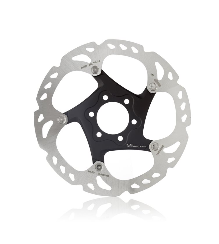

these are the ice tech pads I put on the bike with cooling fins to reduce brake fade on long descents.
The rotors I put on are also use the Ice tech with aluminum centers for lighter weight and more efficient heat dissipation. from Jensonusa.com
Shimano XT SM-RT86 6 Bolt Ice-Tech Rotor
6 Bolt Style, 160mm​
6 Bolt Style, 180mm​
View attachment 83196View attachment 83197

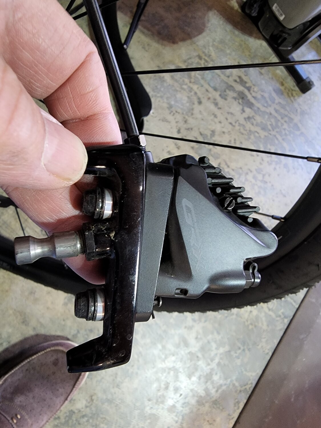

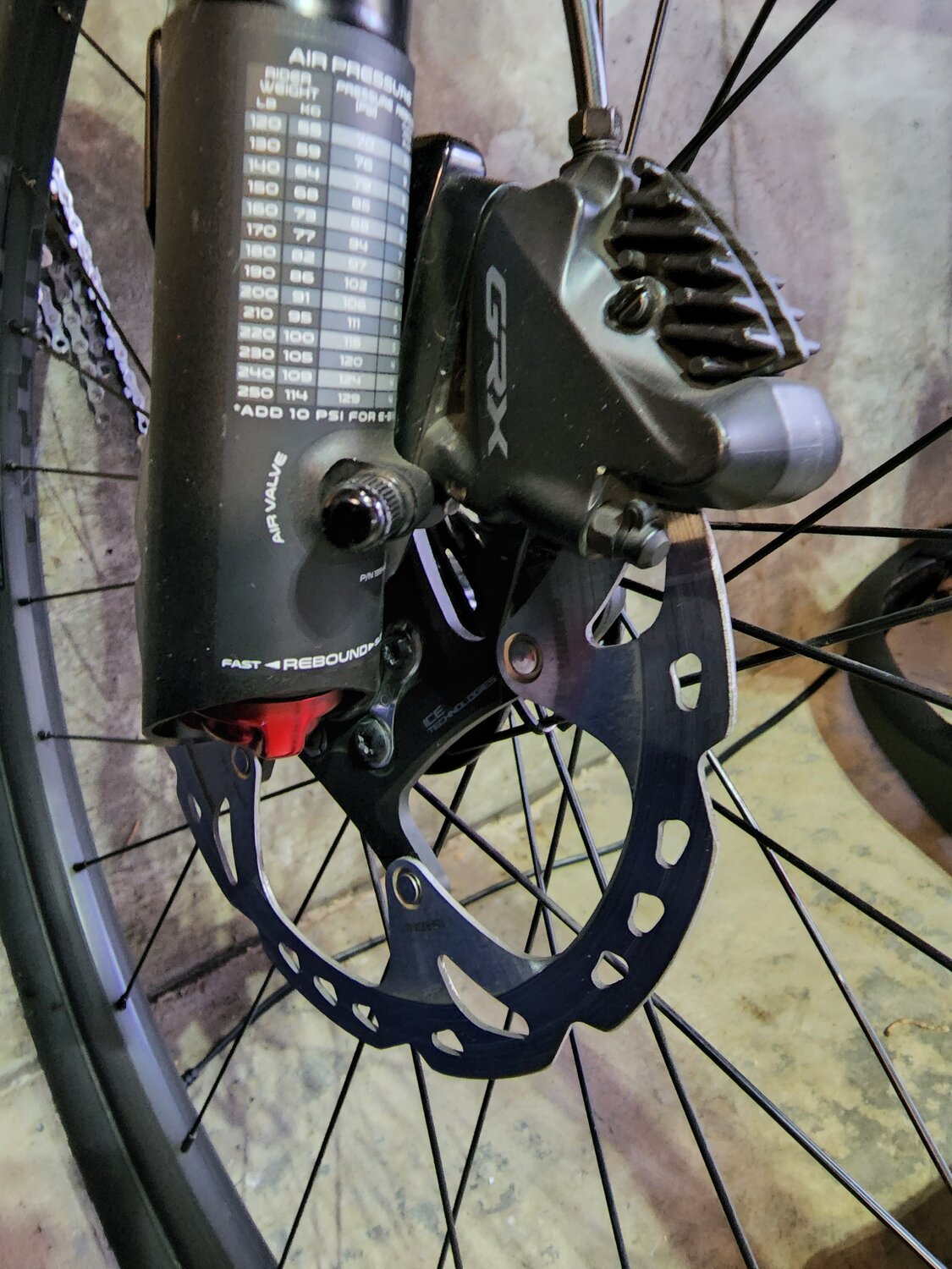

Hey! I've ordered the same rotors to upgrade the factory ones. Can you post a picture of your front caliper? I've noticed that mine came with a 160mm front rotor so I'll need to buy an adapter for the caliper in order to fit the 180mm front rotor.
The rotors that came with my Topstone Neo 3 were 180mm front and 160mm rear. Here is a photo of the ice-tech rotor I put on the front. Obviously it came with the mount adapter already in place so the swap was simple. I also pulled the proprietary brake rotor mount for the lefty fork to take a photo that shows the spacer/adaptor for the 180mm rotor.
View attachment 123031View attachment 123032
That's great, thanks so much for the pictures! Are there any markings or branding on the adaptor? From the pictures, it looks like this one: https://bike.shimano.com/en-US/product/service-upgradeparts/shimano/ISMMAR160DDB.html
It's funny how my Canadian spec'd bike has different parts. I didn't even check the bike when I ordered the new rotors, I looked at your post and checked on the Cannondale Canada site where it's listed as having 180/160 rotors. Only noticed this yesterday while out riding! I also have a carbon seat post from the factory which I think is a bit of a oddity as well.
Max
Max
No marks that I can see without dismounting the caliper (which I am not inclined to do). It does look just like the one from Shimano. given that the Canadian version is a class 1 while the USA version is class 3, the USA version should have the 180mm rotor up front as it is programmed to higher assisted speed.
thanks for the quick response, I'll order that one and see if it works!

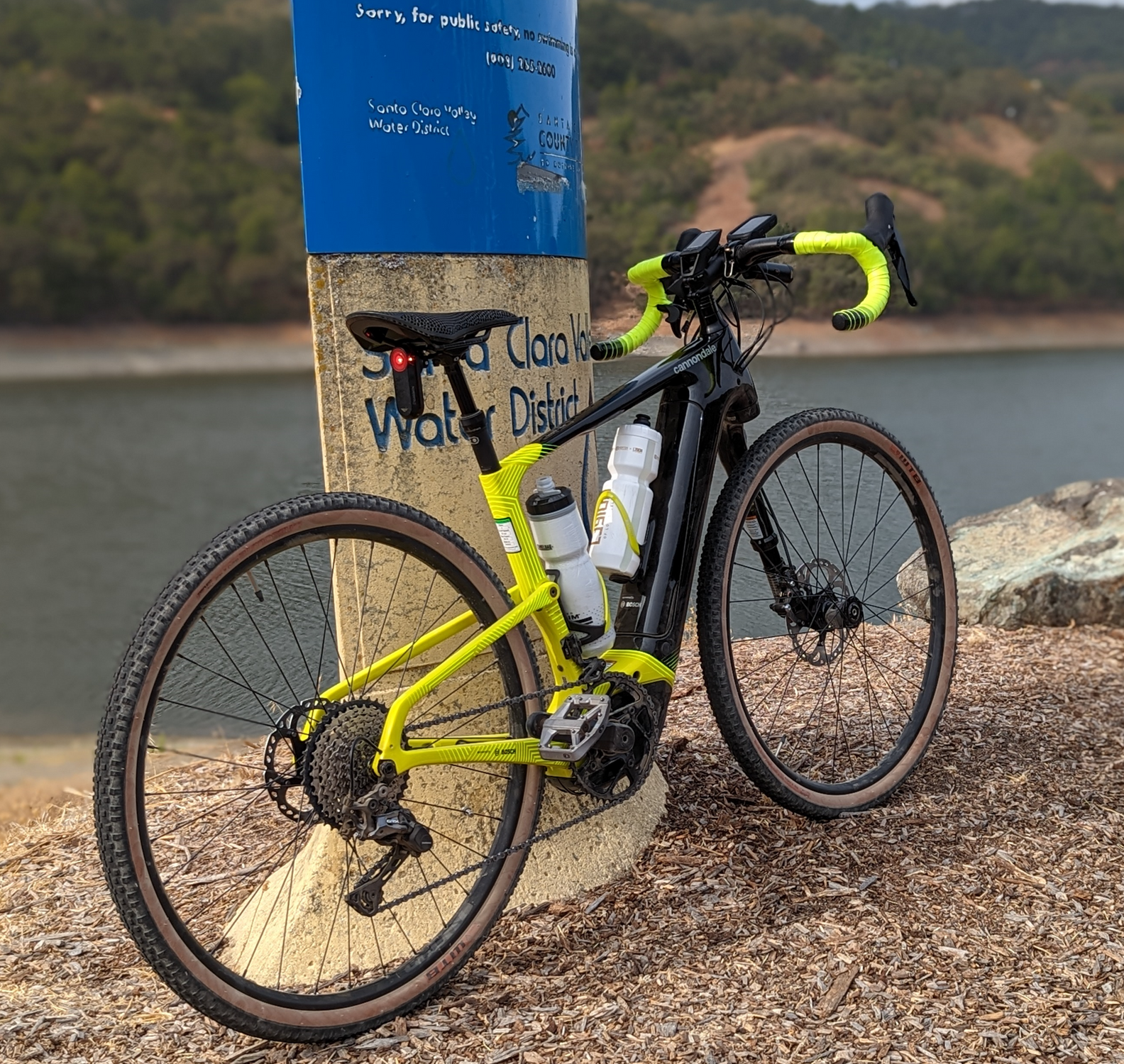

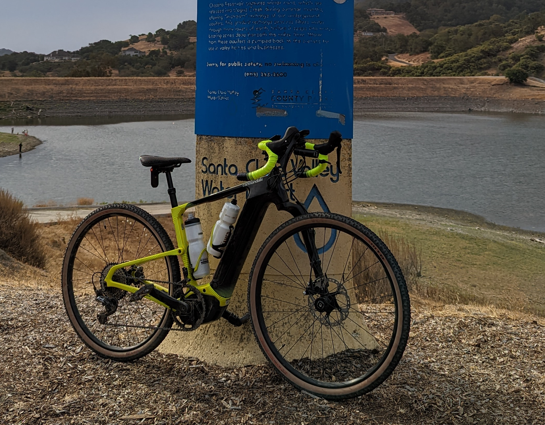

Greetings! Just wanted to drop a note as I recently picked up my Topstone Neo Lefty. Picked it up about a month ago and absolutely love it. It's my second gravel bike. Lefty will now be dedicated to those offroad rides with my other gravel bike being permanently placed on the trainer.
After some mishaps at REI (first build came with a cracked freehub, second build was pretty bad with lots of loose bolts) it was put through about 100 miles of testing to determine first mods. It came out of the box pretty good but just needed a couple finishing touches. The Cannondale alloy bar was narrow and having carbon bars on both of my other bikes I knew I wanted a little more vibration damping. Was also really needing a dropper post. (And I hated that fizik Aliante saddle that came stock.)
  • Upgrade list:
    • Kiox display
    • Post: Crank Brothers Highline dropper post w/drop lever
    • Saddle: Fizik Argo R1 Adaptive saddle
    • Handlebars: FSA K-wing AGX carbon
    • XT rotors
Found some Lezyne cages that pretty much matched the paint and with that I think it's now perfect. Have only around 200 miles total over the month but looking forward to many more!

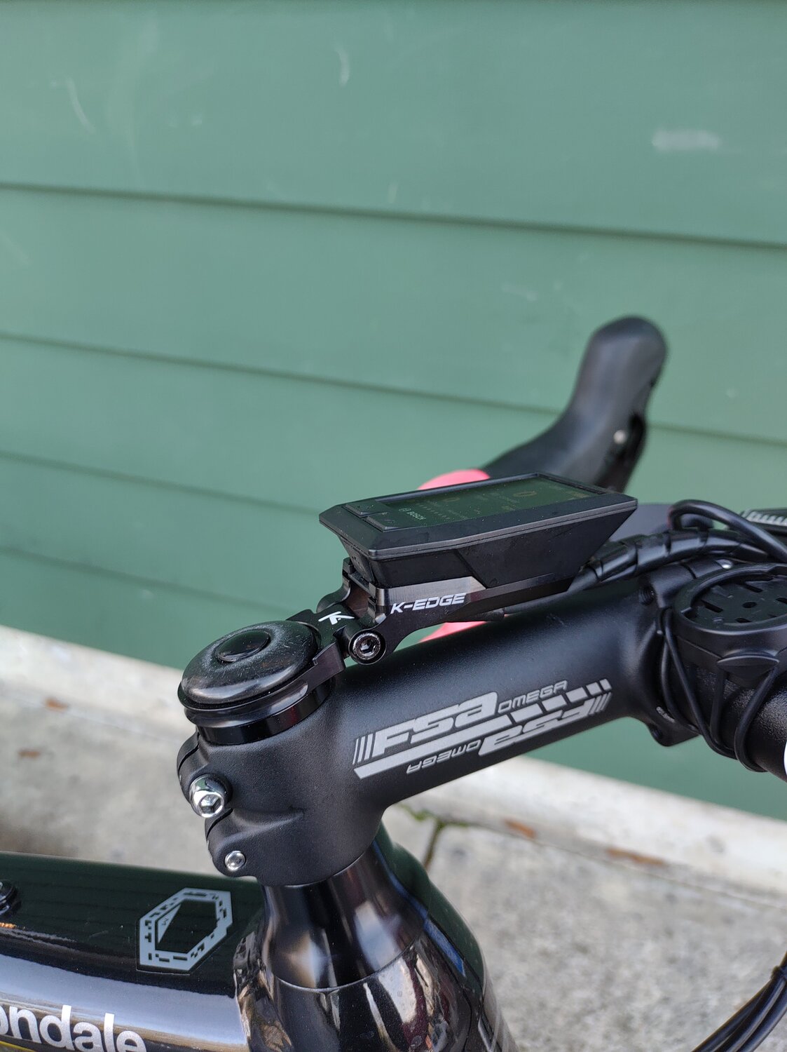

I've got those bars and Kiox on my Topstone Neo 5, you'll need to source a different mount for the switch cluster since you can't slide the stock mount around the flared portion of the bar. I used a Specialized headlight mount as it has a quick release style lever opening so I can clamp it to the bar after the bar is mounted to the stem. Also I'd use the K-Force Kiox mounts for either up front mount or more adjustability on the headset top cap.
See below!

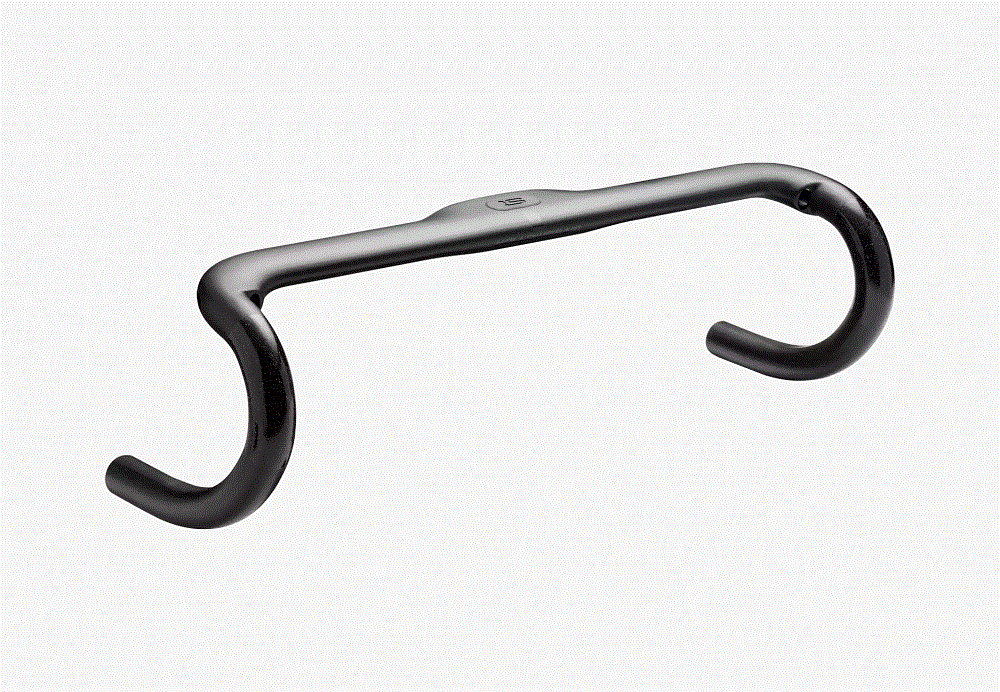

Anyone swap out the stem/handlebar for internal cable routing? 2 extra watts isn't a deal maker but would be a cool clean look
I've got carbon FSA bars that can route internally but haven't as there's no point. Cables will be exposed from the bars to the portion on the head tube where they're run inside.

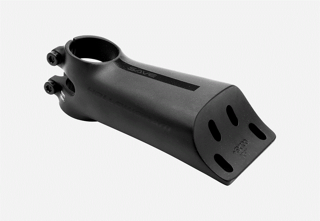

Cannondale offered this bar and stem as options on the TS Neo 2. Not much exposure it appears. I think the kiox can be mounted there also.
