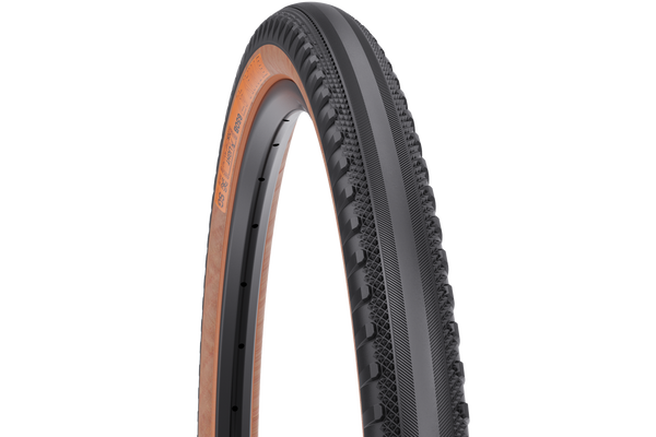

What do they expect us to do if we put wider tires on the bike (which will increase its outside diameter and therefore its circumference) or 650b wheels?
I'm running 650b Shimano GRX wheels with WTB Byway tires (47 mm) and they're fantastic on both road and light gravel / trails.
carsonjones: A question just out of curiosity... I know that you have both 700c tires and wheels and 650b wheels with wider tires and that you can hot-swap between the two sets on your Synapse Neo 1. Do you do this often, or do you find that you are mostly leaving one set of tires/wheels on the bike and ride "wherever"? I have been toying with the idea of having two sets of wheel/tires or perhaps just getting a bit wider tire than the 32c that came on my bike. I have been doing pretty well on gravel roads with the 32c tires, but there are a few roads that I wish I had a wider tire.
Thanks in advance for your reply, NH-Senior-Gal
@NH-Senior-Gal - I typically ride with the 650b / 47 mm wheelset and ride mainly farm roads / gravel roads / rail trails. A caveat is that the WTB Byway tires, while 47 mm, also are slick down the middle with tread pattern on the sides. This makes them ideal for the type of riding I do and means that I don't lose a lot of speed when on regular roads. I do switch out to the 700c / 32 mm wheelset if I'm doing all road and doing longer distances (e.g. 80 km+). I've also had situations where we'll be travelling to a destination ride and there's been concern about one of the tires losing air. I'll take the second set of wheels knowing that I'll be able to ride no matter what. I've been fortunate also that the wheels are truly hot-swappable, meaning I don't have to faff about with fine-tuning the derailleur alignment. Your local bike shop should be able to set up both wheelsets this way. I highly recommend having the two sets and you'll certainly appreciate the much wider tires for days on gravel roads and trails. It lets you ride comfortably pretty much everywhere.
Thanks for your answer! This also helps me answer some questions that I've had from some e-bike wannabes. ;) The WTB Byway tires look very similar to the WTB Expanse 32c with the exception that the 47 tires have a little knobby on the outside edge in addition to being wider. The smooth center tread is great on the road and both tires have this. It's good to know that you don't have to fiddle with stuff after hot-swapping your wheels!
I too have found that the "correct" tire choice can vary significantly by trail. I've ridden some really hard packed trails that are possible to ride on a set of 23 mm racing slicks. But I've been on other trails that even a 700 x 40 tire with a tread pattern feels like it's not enough tire. You can ride the trail but there are some sketchy moments and you'd feel more comfortable with an even wider tire. Plus personal preference has a lot to do with it as well.
As a result I've accumulated a bunch of different tires and I'll probably need to ride another 30,000 to 40,000 km's to wear them all out!

I have a pair of 650b x 47 WTB Byway tubeless tires on my Cannondale Topstone Neo Carbon 3. They do very nicely on rocky, gravely logging roads, when inflated at 22-25 PSI and are superb on roads inflated at 28-32 PSI. Very grippy on pavement and amazingly durable on rock strewn dirt roads. I really like these tires set up tubeless. No flats in almost 2,500 miles. One self-healed puncture center tread with a 1/2" staple that healed leaving a dime size latex tab on the outside of the tire covering the staple. It leaking out about 2 or 3 psi before sealing. No hiss or air lost when I pulled the staple out.
I have heard good things about those tires. Thanks for sharing your experience!
I have a tire similar to the WTB Byways (47mm Specialized Pathway 2Bliss) and I'm very happy with them. The Pathways are great on most surfaces, but not much fun on sandy surfaces.
I've been running mine at 40f/45r. I'll have to lower them a bit to see how they feel. Maybe they'll behave better on sandy pathways.

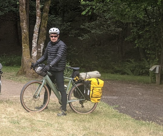

Just added a rack and pannier setup to the bike for touring. Really impressed with how the Ortlieb panniers and Bontrager rack fit the Synapse Neo. Can't wait to try it out!
FOLLOW UP: Aug 22 2021 - tried out the new touring setup today on a nice 100 km ride. The new rack and pannier system is fantastic and the bike performs and rides really well.

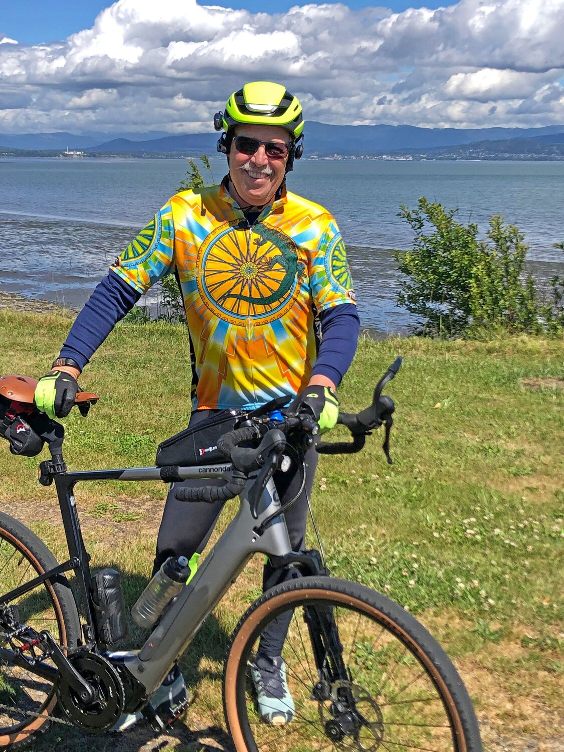

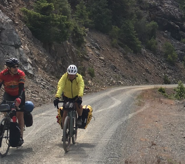

I'll be using the Synapse Neo for some bike packing/touring trips that are typically asphalt and gravel road/trail routes. It's important to note that I haven't actually done this yet. I won't be doing much in the way of single track or heavy gravel routes. To address your question, I think you could make the bike work well for touring. While it lacks a full touring layout, the Synapse Neo does have a rack mounting option and with today's bike bag systems, I think you'll be able to spec it out according to your needs. Simply put, I would be comfortable using the bike for touring based on how I ride and where I ride. Hope that helps to provide some additional insight.
Well....we took the Synapse 1 for a 1000 mile tour and it performed well. We had days of 60-70 miles with 6000/7000 feet of climbing and always had a charge left at the end of the day. Having a little extra battery that could be used as an extender sure would be great as it would add a very nice "cushion of comfort" in the sense of knowing you will not run out of power. I believe the only way to get an extra charge on the fly is with an entire extra battery $$$. We are take the Synapse on a second tour, Tacoma to Missoula, this June. Do you know of any way to hack a small extender battery into the system? Having to take along a whole other battery for even an extra 15 miles of power is a bummer and expensive.
