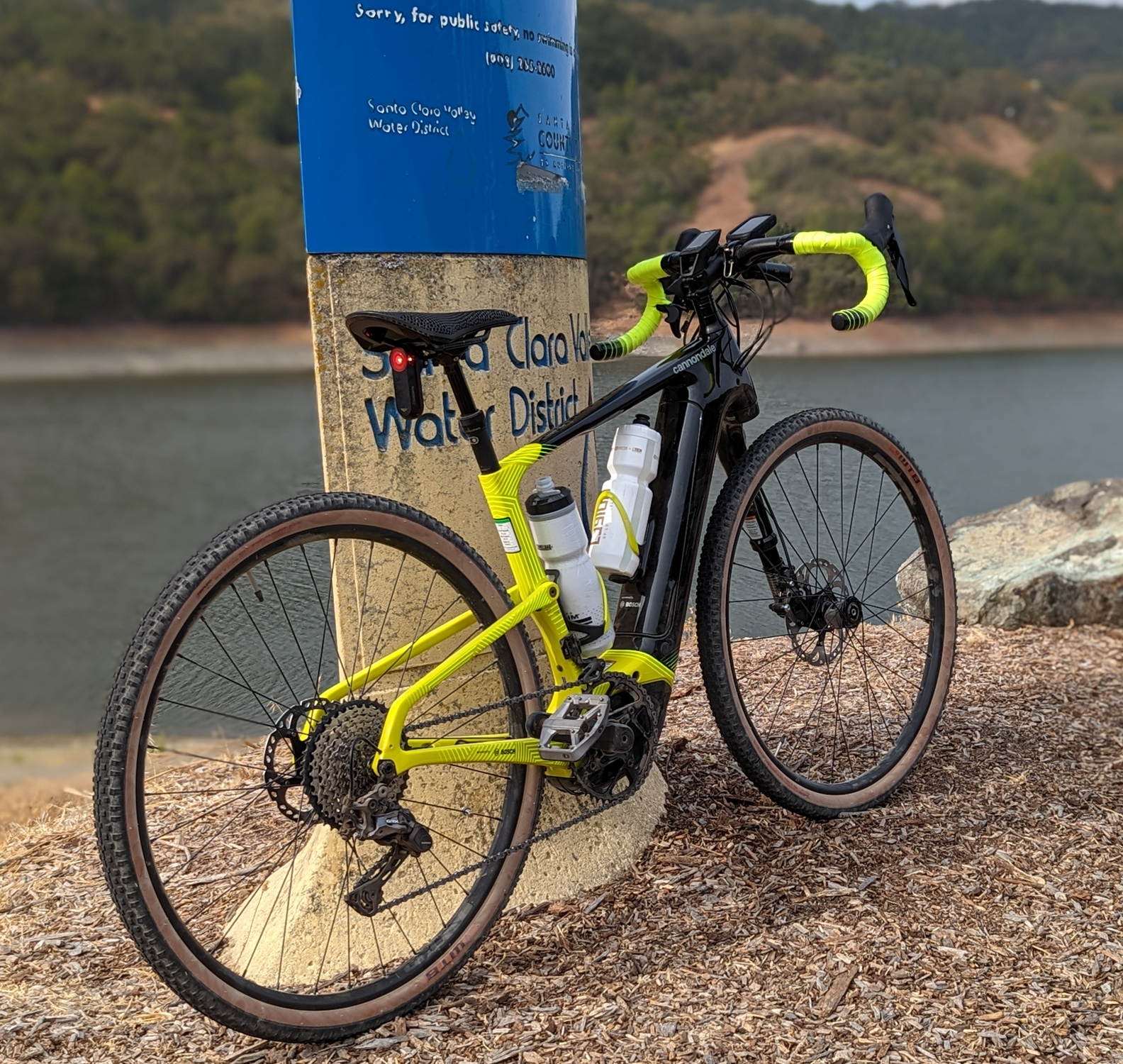

Greetings! Just wanted to drop a note as I recently picked up my Topstone Neo Lefty. Picked it up about a month ago and absolutely love it. It's my second gravel bike. Lefty will now be dedicated to those offroad rides with my other gravel bike being permanently placed on the trainer.
After some mishaps at REI (first build came with a cracked freehub, second build was pretty bad with lots of loose bolts) it was put through about 100 miles of testing to determine first mods. It came out of the box pretty good but just needed a couple finishing touches. The Cannondale alloy bar was narrow and having carbon bars on both of my other bikes I knew I wanted a little more vibration damping. Was also really needing a dropper post. (And I hated that fizik Aliante saddle that came stock.)
  • Upgrade list:
    • Kiox display
    • Post: Crank Brothers Highline dropper post w/drop lever
    • Saddle: Fizik Argo R1 Adaptive saddle
    • Handlebars: FSA K-wing AGX carbon
    • XT rotors
Found some Lezyne cages that pretty much matched the paint and with that I think it's now perfect. Have only around 200 miles total over the month but looking forward to many more!

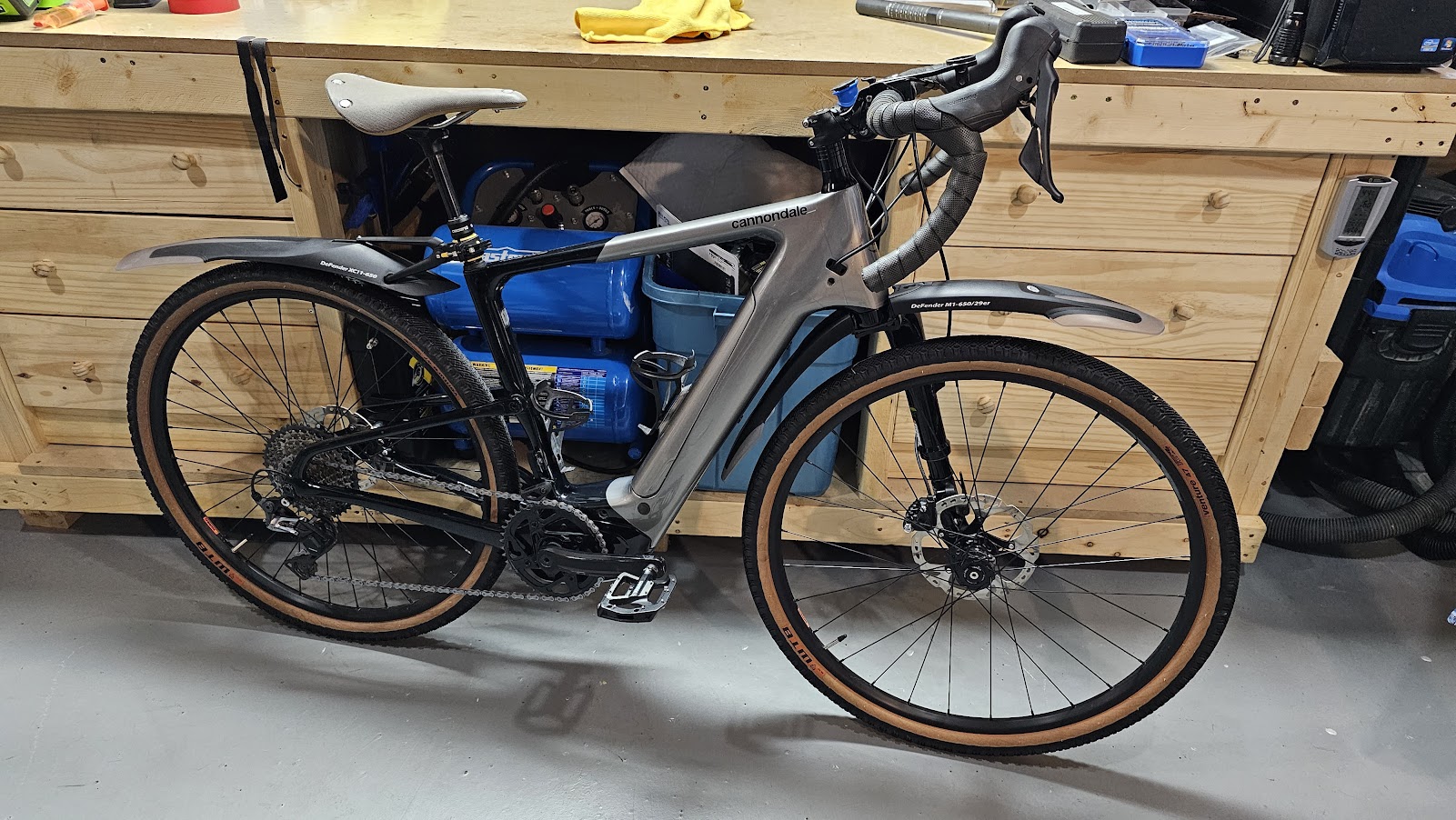

Yup! This is my current setup, running the WTB Venture and upgraded XT rotors.
Here's my fender setup:
I have MB fenders front and back and I've added another lower fender in the rear for more protection while riding in the rain.
The front fender works okay, but not great. The problem is the way it mounts. The single shock is slightly forward, which makes it difficult to get the fender to mount securely.
@Deacon Blues, What did you use to secure the SKS on the front? Just the default? (I've seen some "Lefty" adapters posted online or advertised but can't find anything recent or a reputable vendor offering them.)
Thanks for sharing the photos @Deacon Blues! I am hoping to receive my fenders within the next week or so. Regarding the speed delimiter, what happens if you accidentally turn of the display and the chip gets detected? Is there a DIY way to reset the system or is the entire system bricked?
El Wray, just the default mount for the front. It works okay, but the fender moves around a bit while riding.

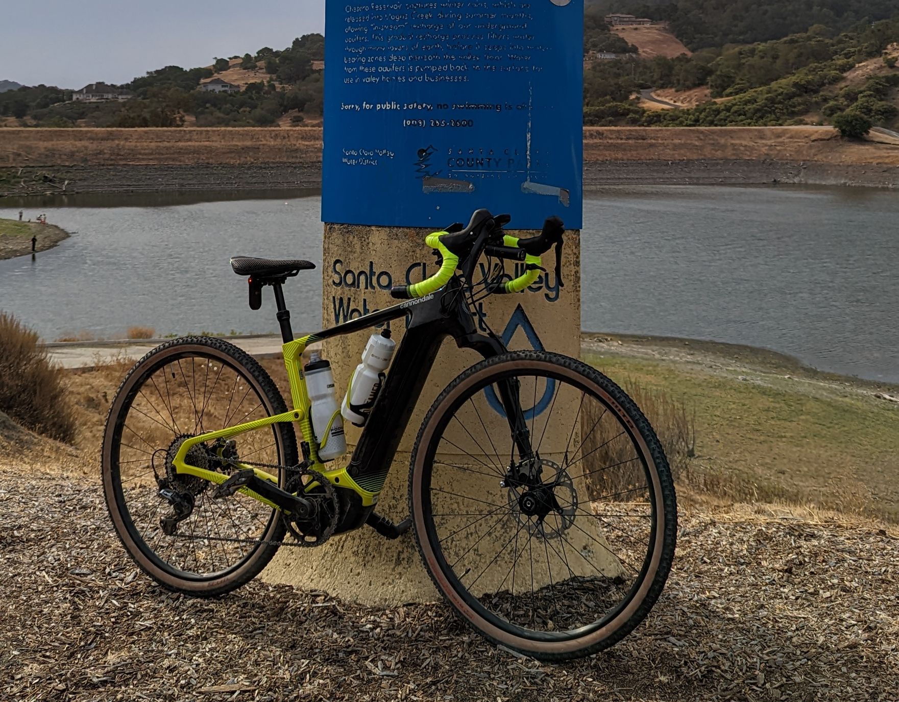

Update for everyone :cool: I've recently installed the Brand-X 85mm dropper post with upgraded jagwire cable and some Topeak M1 and XC11 fenders. I won't be running these fenders full time, they are just there for Spring riding. Flat pedals are temporary as well as I did some cold weather rides in the Fall. I have not yet gone for a ride this Spring, still some snow here but hoping to go out in the next two weeks! Dropper post installation was a bit time consuming but really straight forward. As of yet, I have not pulled the trigger on the KIOX upgrade but I am still thinking about it. Next on the list is a Garmin Varia radar.... bike season is just around the corner!
@El Wray What mount did you get for your Garmin Varia? Looks like it mounts to the seat rails. And, if it wouldn't be too much trouble, could you post a photo of the top view of your cockpit? I'm trying to see how you've mounted the Kiox/controller with your Garmin Edge as well. Thanks :cool:
