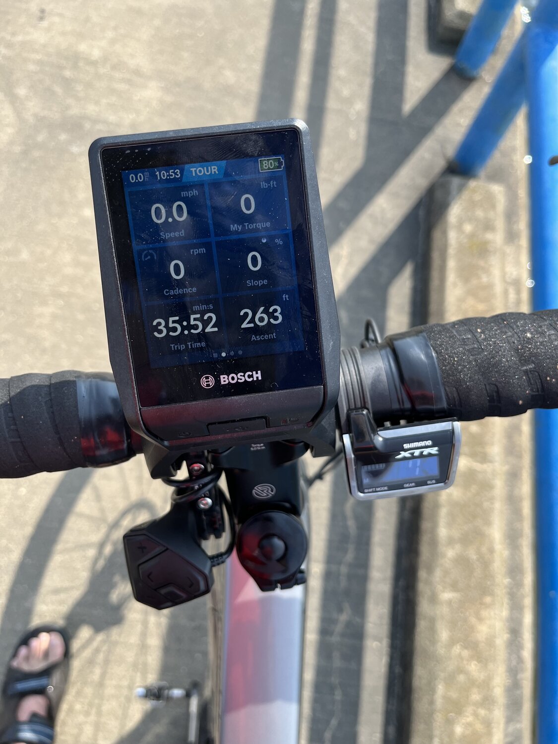

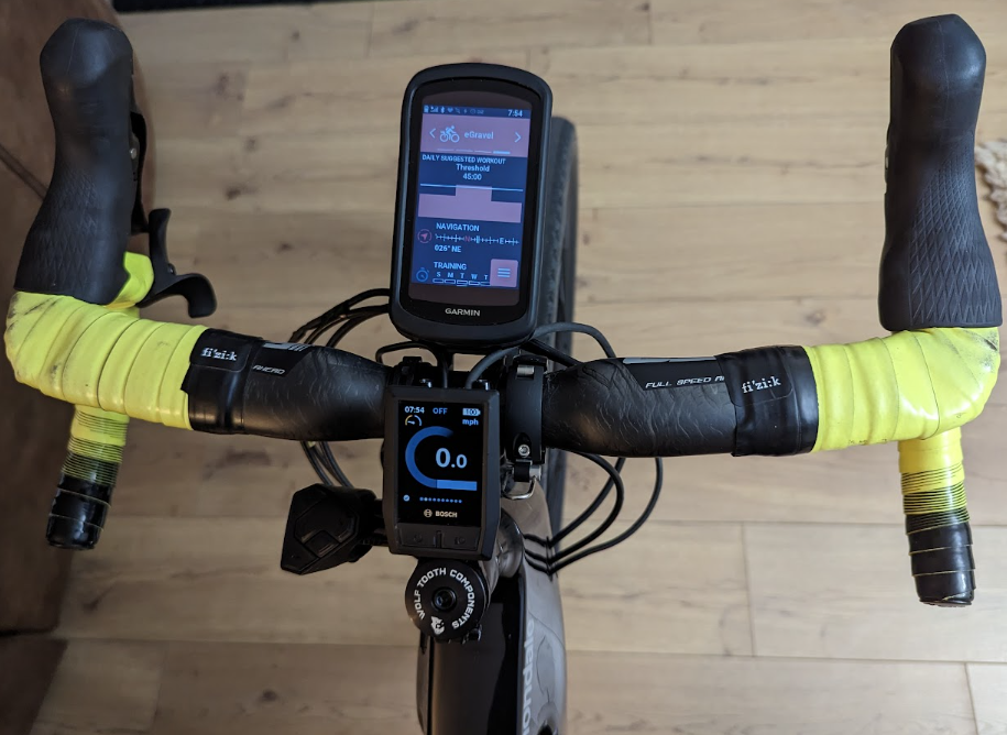

@El Wray What mount did you get for your Garmin Varia? Looks like it mounts to the seat rails. And, if it wouldn't be too much trouble, could you post a photo of the top view of your cockpit? I'm trying to see how you've mounted the Kiox/controller with your Garmin Edge as well. Thanks :cool:
I used one of these to mount the Kiox controls to the left of the stem. I cut the carbon down to size in order to not have it stick out so much. Link: Vinqliq carbon fiber extension on amazon
Cockpit details:
* FSA K-Wing AGX
* Crank brothers highline dropper remote
* Vinqliq CF mount (kiox controls)
* K-Edge Bosch stem mount (kiox display)
* KOM Cycling stem mount for Garmin (plus a Lezyne Macrodrive 1000 underneath)
* Knog Oi Luxe bell (large)
I have two different mounts for the Varia light. I tried the saddle rails on the Topstone but will be swapping to Garmin fixed quarter turn mount. I have the fixed mount on all of my other bikes. The saddle rail mount works pretty well -- the screws just need loctite otherwise one screw will eventually rattle loose in rough trails/with the dropper post moving about.

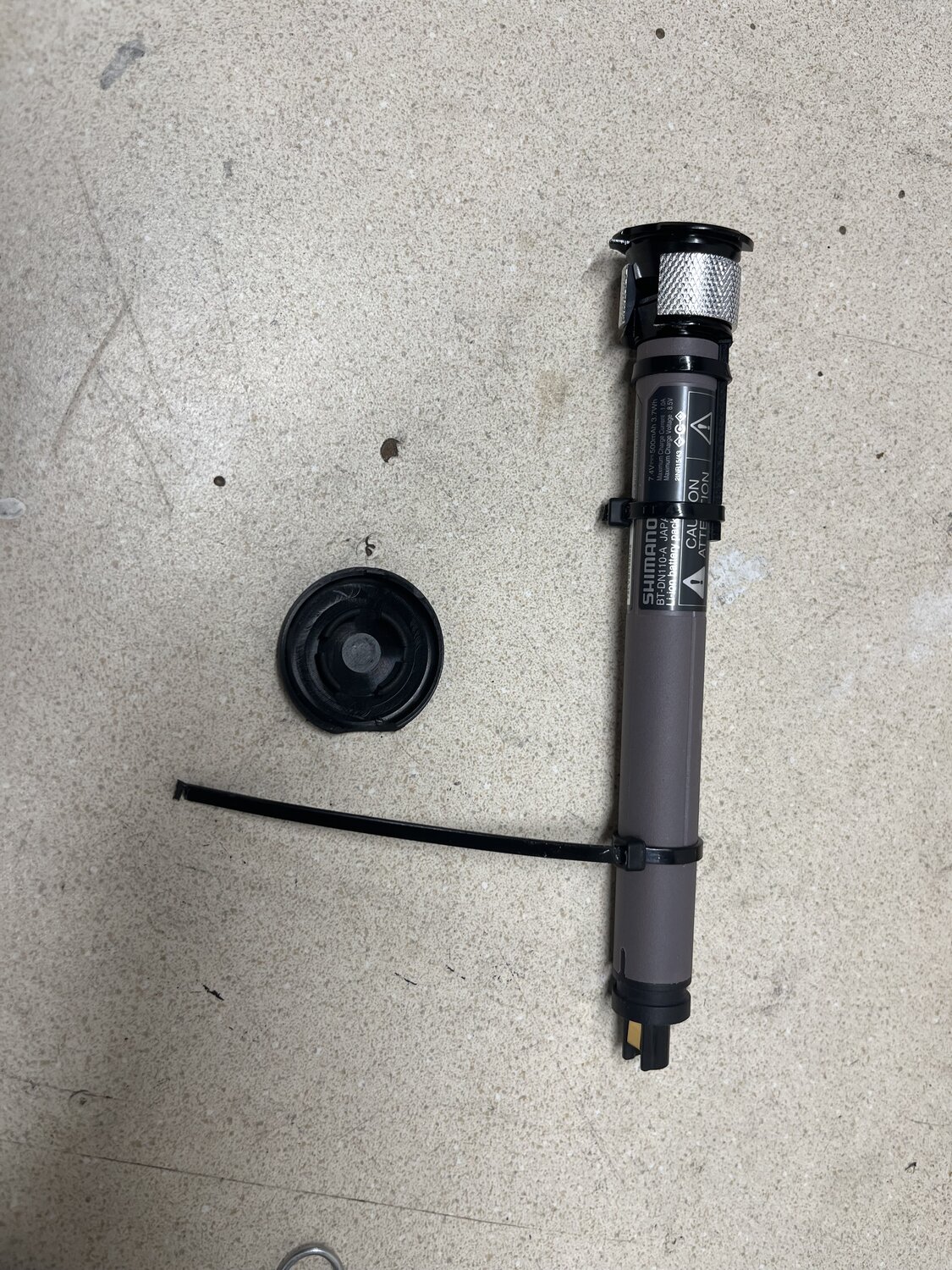

Bit of an update: I converted to Di2 (1x).
I ended up mounting the di2 battery using a Shimano SM-BT1 external case. Due to the way the SM-BT1 mounts it initially needed to be installed above the Bosch battery along the downtube. If you try this normally at the seat tube bottle cage, the SM-BT1 runs into an issue with the di2 battery rubbing the frame near the rear kingpin pivot point. I bought a Wolf Tooth dogbone bottleshift to shift the bottle cage offset some, that then let me be able to mount the battery at the seat tube. Using the dogbone and having the external mount at seat tube has been fine so far. Long term I will probably swap out my dropper post for an Enve G series dropper that allows for internal di2 battery.
Shifting is fantastically smooth and significantly quieter. The GRX810 shifters also have more comfortable ergonomics and better brake modulation. What I wasnt expecting and was a huge improvement were upgrading brake calipers from RX400 to RX810. Using the same rotors and Shimano pads, resistance to heat fade on the new calipers is vastly superior.

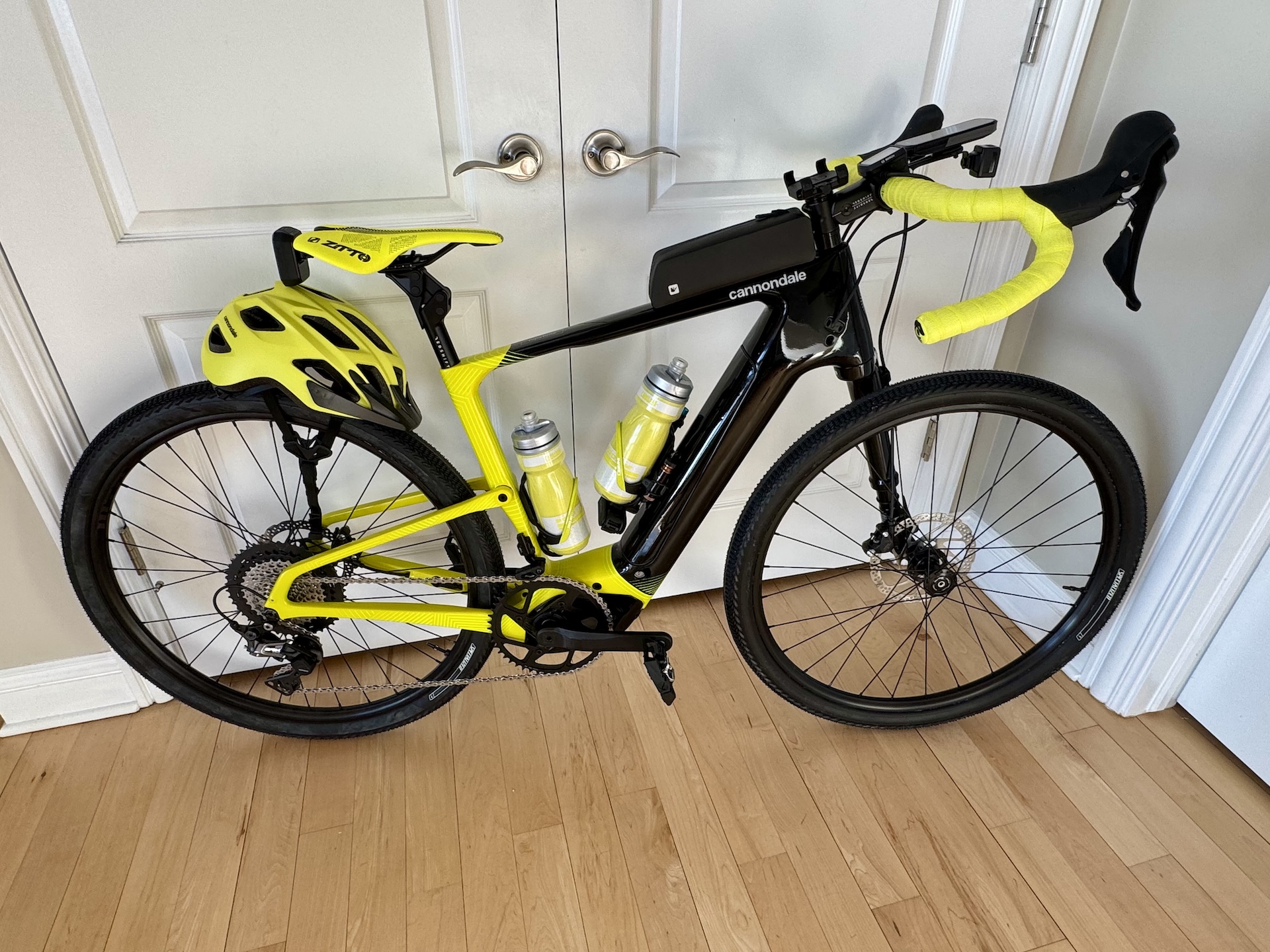

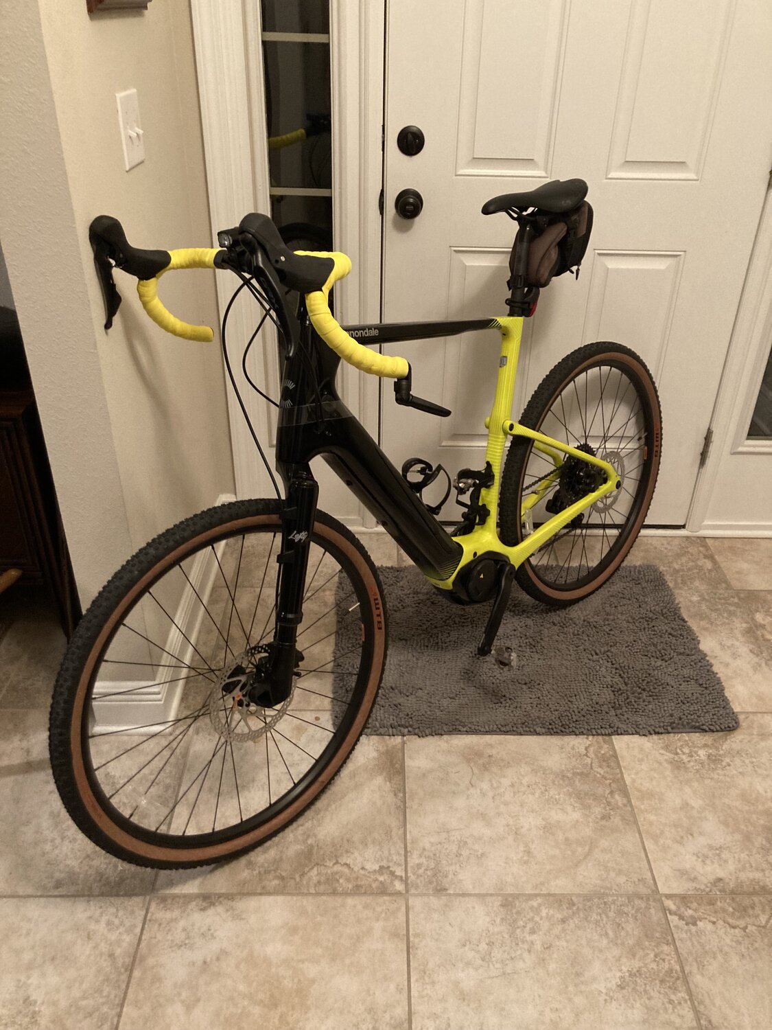

I know I’m really late to the party and the Topstone Neo 3 is passing into history soon, but the bike rally appealed to me with it’s capabilities, so after a few months of searching, I finally tracked down a new-to-me Cannondale Topstone Neo Carbon Lefty 3 in the Highlighter colorway. I got the bike from The Pros Closet. The bike had 1000 miles on it and mechanically was excellent (1 small paint chip, but otherwise pretty top notch) and cleaned up just like new.
I did replace some parts to freshen up the drivetrain and get the speed/gearing I was looking for
New chain (waxed w/Silca)
11-46 Rear Cassette
48T Chainring
Replaced front 180mm rotor, all brake pads
Specialized Pathfinder Pro 650bx47 tires tubeless
Added some comfort/cruisin accessories
Ritchey Comp Beacon Road Handlebar 46cm - wrapped in Lizard Skins DSP bar tape (went yellow)
Redshift seat post and stem to cushion out the chatter
Light mounts for my Bontrager Flare/RT/Radar lights I switch between bikes
Garmin Computer Mount
Stem cap Garmin interface phone mount
Top Bar bag
Pure Bling (OK, it might be a bit much… WBIC?)
Ztto Seat - Yellow, LOL
Cannondale Highlighter helmet
Matching water bottles and cages
Initial impressions are very positive on this bike - this thing is a rocket ship - getting up to 28MPH fast and holding it on the flats. Can’t wait to do some gravel and singletrack as the weather turns better. Looking to put many miles on my first e-bike.

I also have a Ritchey handle bar on mine (WCS Venturemax) and I'm running the same tires as you.
I've also waxed my chain (Silca).
I also changed out my stock aluminum wheels for a carbon set (Yoeleo).
Even after 4.5 years I'm really happy with my Lefty
Love the yellow seat and handlebar tape. I wish my bike looked that good. 👍
Congrats on the pickup. Smiles for miles for sure. Great find - know you will enjoy it!
Love the yellow seat and handlebar tape. I wish my bike looks that good. 👍
Yep your mods in this thread were very helpful in figuring out how I wanted to set it up - Thank You!
