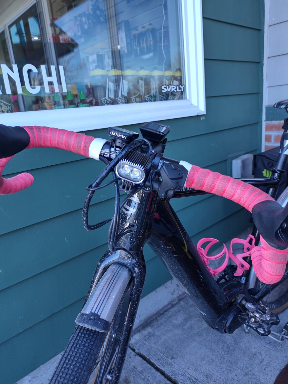

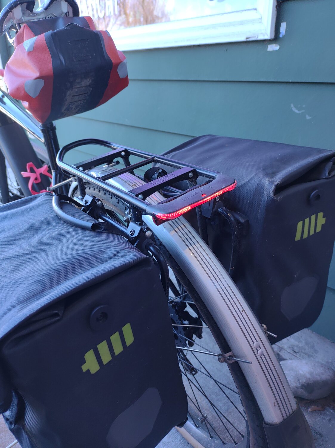

Ask and ye shall receive!
Hey Brendon! Thanks!
Looks like a lezyne hv 800 ebike specific one? Was it easy to wire up?
Yep, went with the 800 lumen Bosch model, I did the lights/rack and Kiox all in one go and it required sticking a hand grenade where the battery is...
Yes it's a HUGE amount of work. Not to terribly complicated if you know what you're doing but it's lengthy to say the least. Don't forget to update the software after install as your bike might not let you turn the lights on in the programming.
